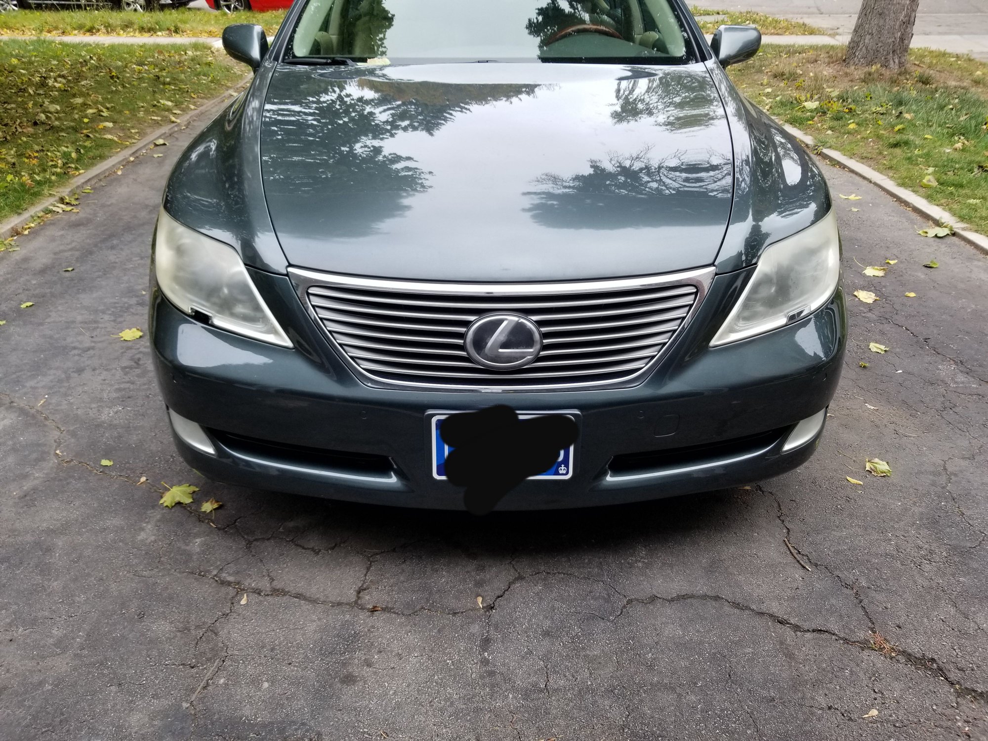

Did some more work today

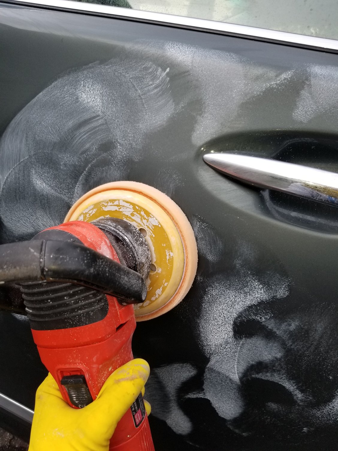

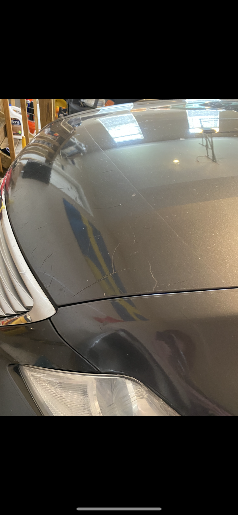

I wet sanded the hood , front fenders and the whole left side of the car with 2000 grit , then polished it back up with my griots.
Paint has sone stone chips here and there but this resolved almost all of the paint swirls and fading/hazing

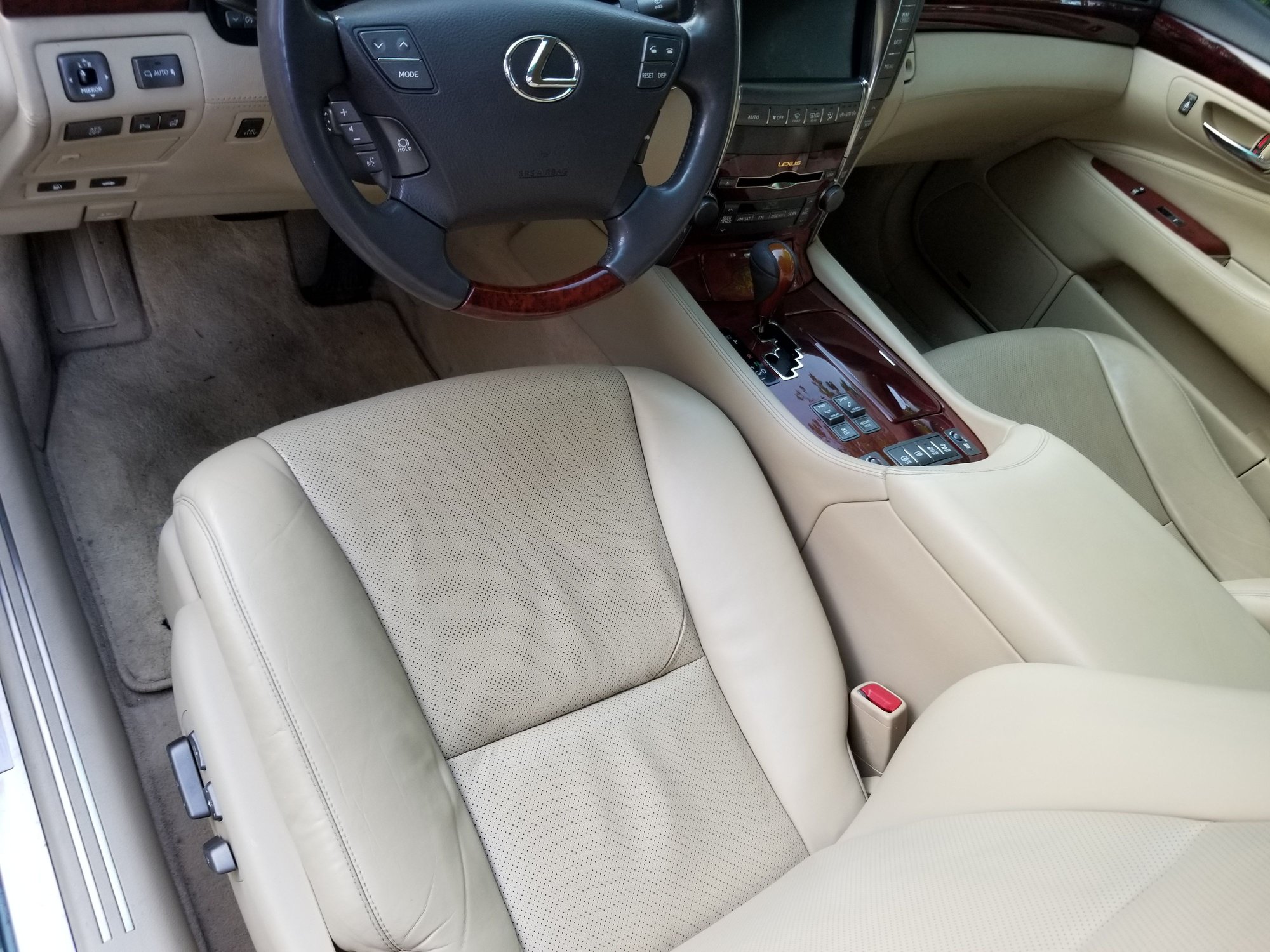

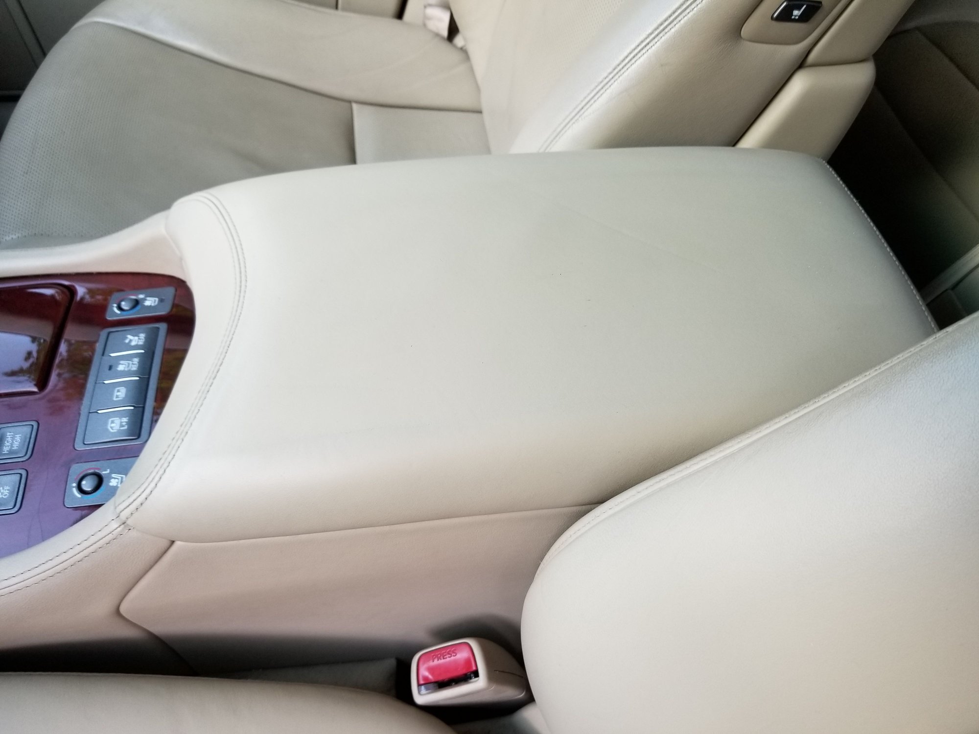

A few better shots of the seat and arm rest, color turned out very well and I'm happy with the finish, looks similar to factory in texture and sheen

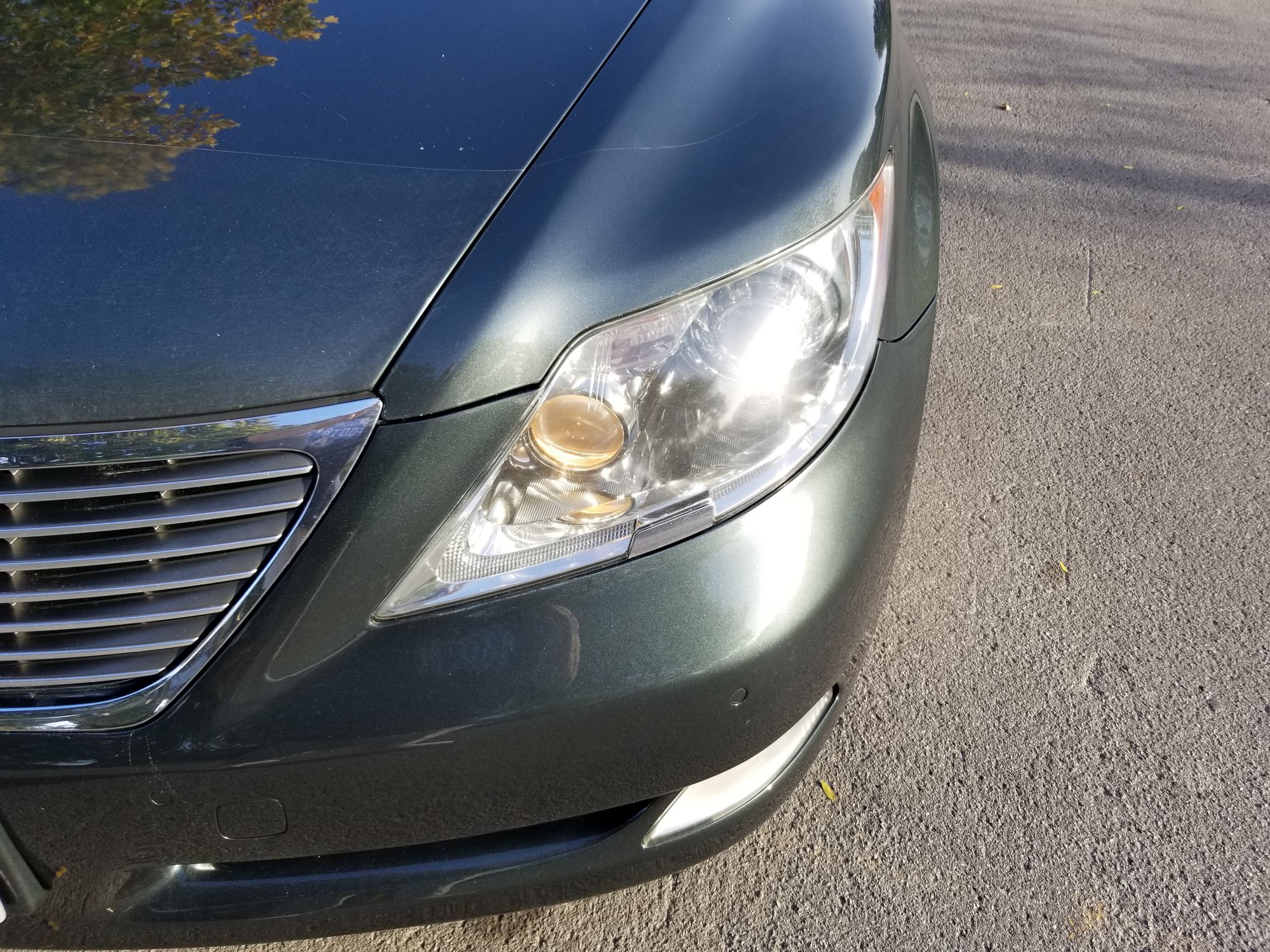

Finished off the headlights and radar, forgot the drivers side fog light I'll do that tomorrow

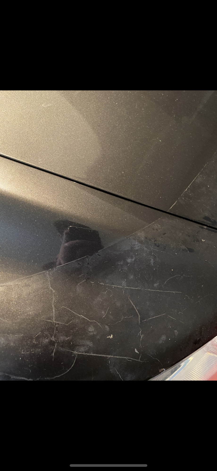

Now time to take off that old, tired clear bra. I spent probably around 10 hours taking mine off. It was in worse shape, cracking, so I couldn't get it all off in one piece it would just break.

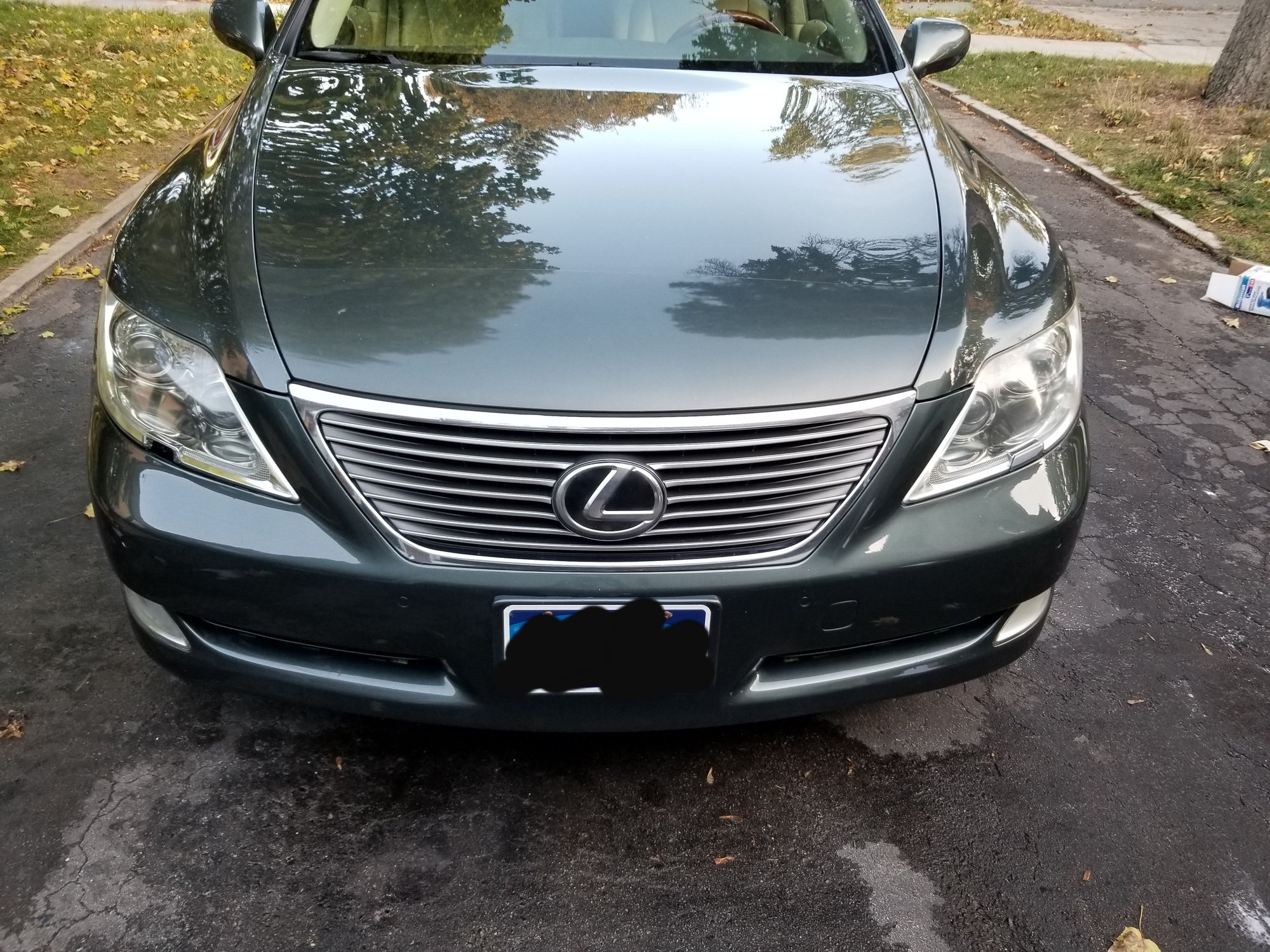

Default Here’s my old clear bra before, and after I took it off and polished.

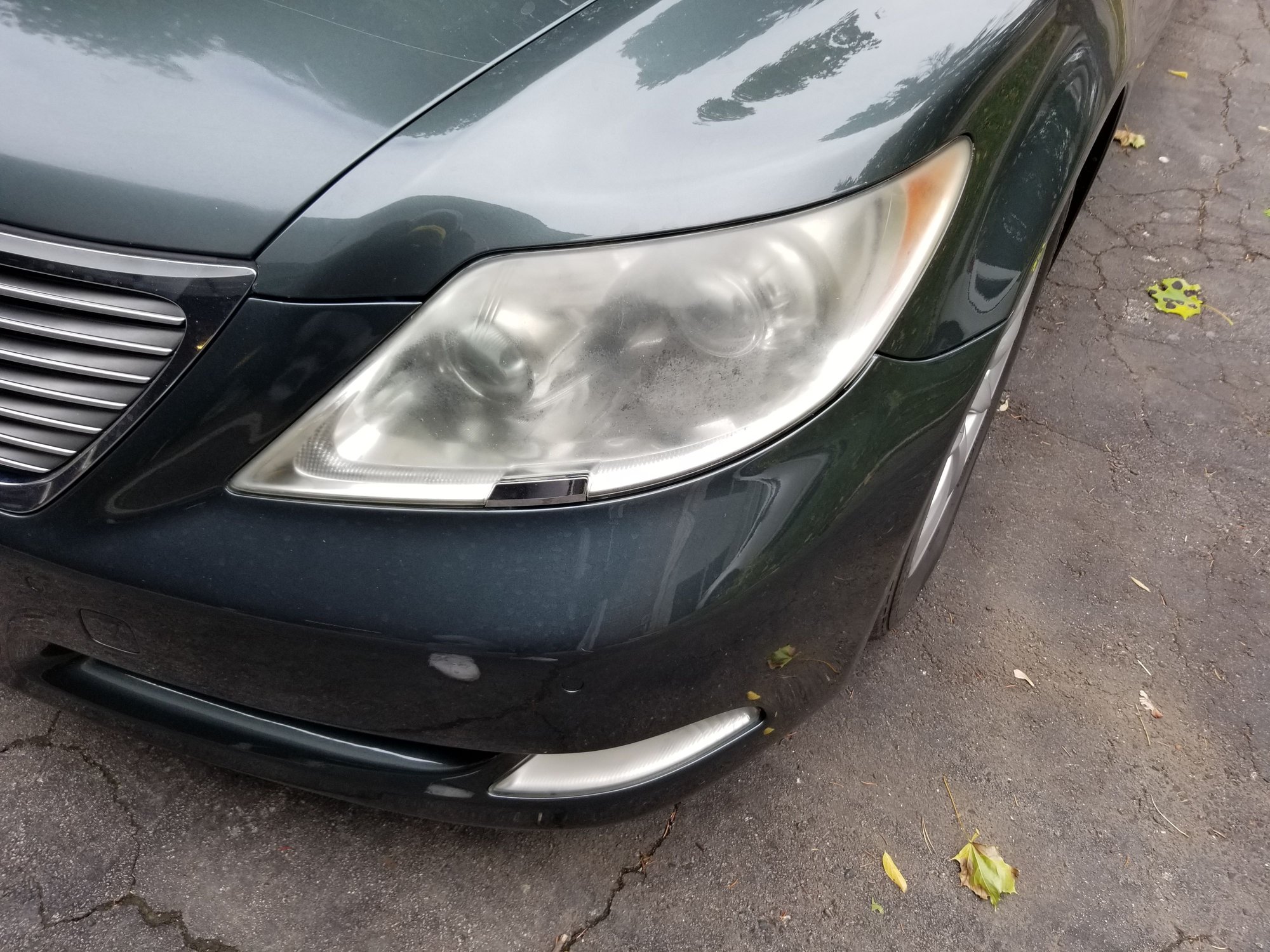

What did you use for the headlights?

I have the same question. The inside of my headlights are a *little* wonky but I'm not about to disassemble them without a better reason or instructions...

My headlights were not too clouded being from up in new england. I just used my DA polisher and a stronger grade of meguires compound, I think its called ultimate cut. If yours cannot be cleaned up with just polish alone, try the 3M sanding kit.
I wet sanded them with 2000 grit then used my DA polisher and Maguires 105 , 205 and a final finishing glaze , it's not hard if you have polishing experience
It's most likely the outside of your lights that are wonky, try polishing first see how it goes
