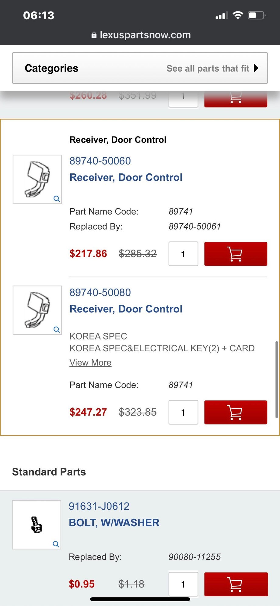

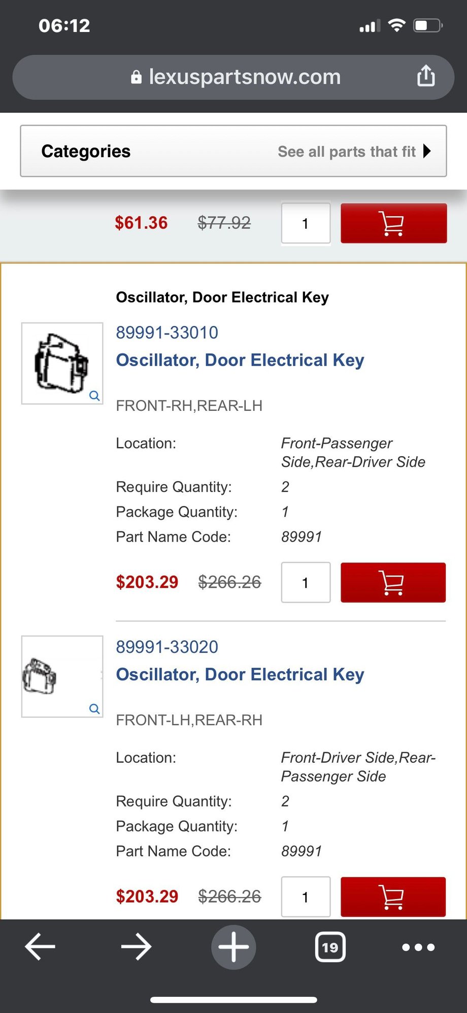

ok speaking to someone briefly I understood that to disable smart key access something needs to be removed from the car.
so we have the smart key ecu near the driver, I assume that also controls keyless start? Or can someone expand on this?
what is an oscillator? I notice they name it differently wireless key I think just refers to the remote.
Not knowing anything at the moment, I think the best course of action is to unplug the smart key control unit in the trunk it is a receiver of some sort. Thoughts?
