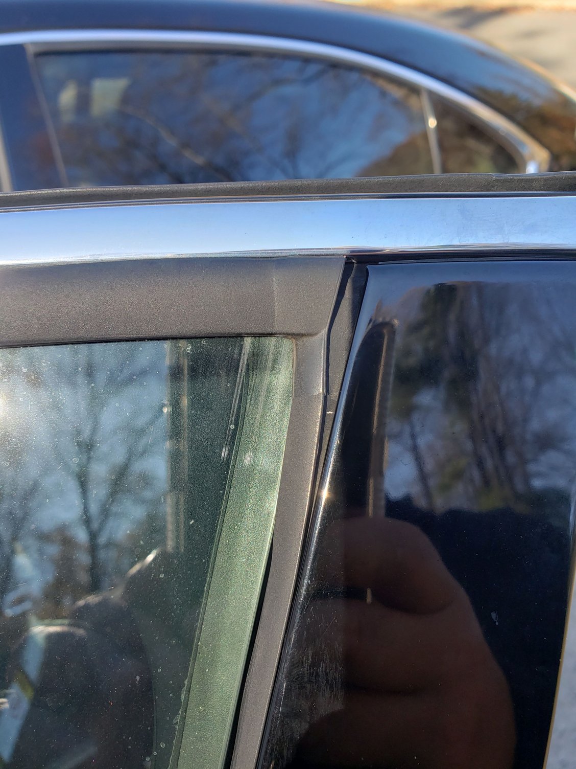

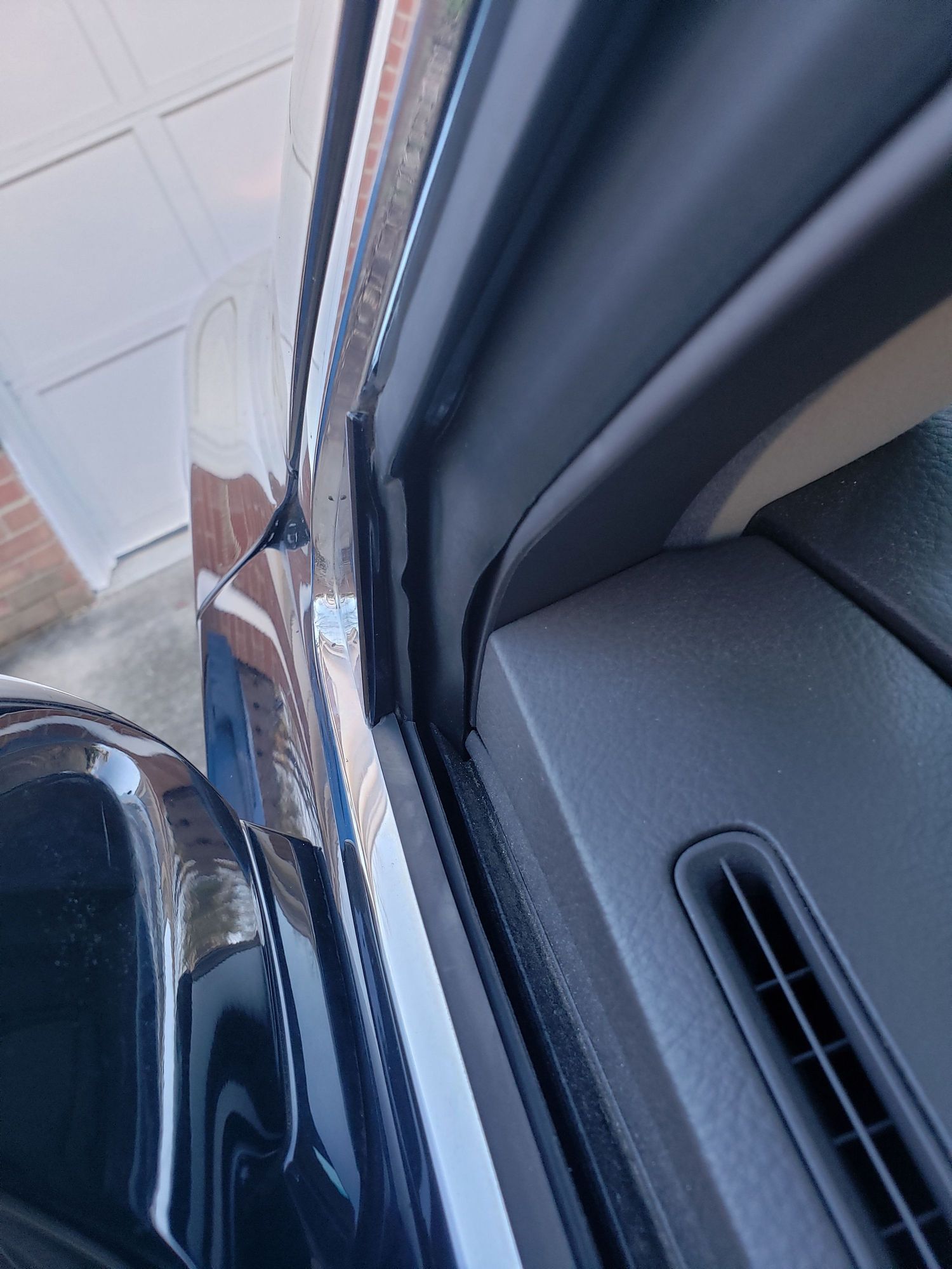

Hello,
So the window stripping is messed up AGAIN. When you close the window, it bends backwards and folds, allowing air to get into the cabin. Here are a few pictures and video of the noise. I assume I need to have this replaced? Can I order the OEM myself?

I had the exact same problem. Took the car to a body shop and they fixed. No more wind from my driver side door. Parts from lexus/toyota is cheap with their labor, they charged me $ 105.00 in total

Try applying some silicone spray to the rubber and wiping it on there. I had a similar issue. I saturated the rubber seals with WD-40 Silicone Spray and wiped it on there. I then moved the window up and down a few times and now it doesn't fold anymore. No more noise.

It worked.
