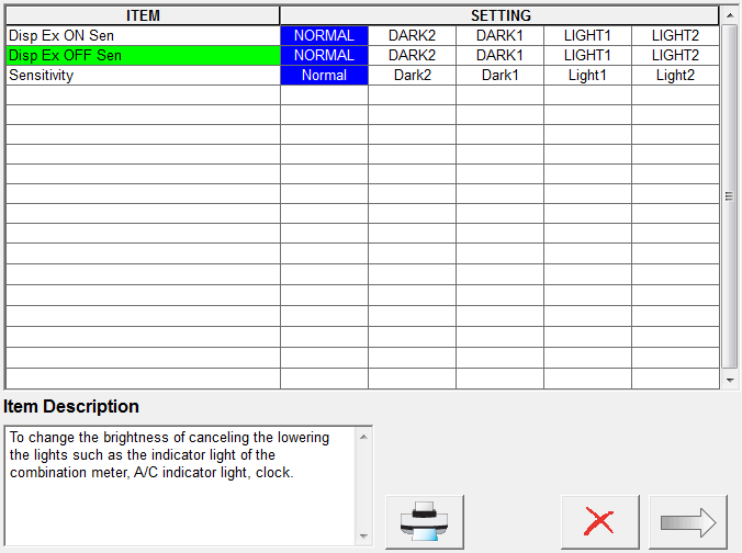

AFAIK the backlight dimming cannot be disabled, but the sensitivity can be adjusted via Techstream:
Here's my post about testing the Sensitivity setting. If the two other settings work by the same logic, setting the first one to DARK2 should make the car wait until it gets darker before dimming the backlight...I guess.
