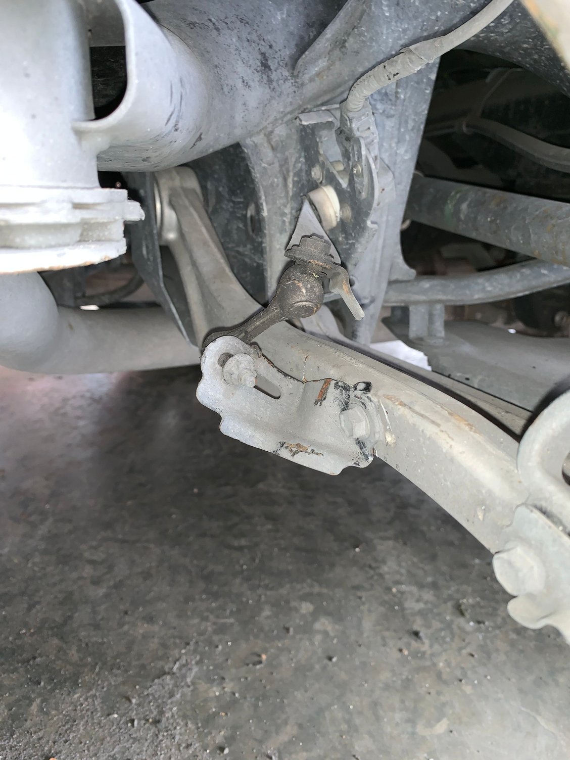

Good morning!
I purchased my 07 LS460L with 103k from an auction a while ago. I've since replaced both rear air struts (new) and the front left (ebay, used). My ride is still rough and bumpy. I crawled under the car and noticed my right rear height sensor is bent/broken. I also have noticed from looking around that my rear gap is taller than what I believe it should be. I will be ordering a new rear right sensor as the current one is broken. Do you guys think this should help solve my bumpy ride situation? I hope so, because this 'good deal' auction car is costing me the same as buying it used at a dealer in good shape. Please see pictures below and advise.
Thank you in advance!!

No accident history, but you never know. It appears the rear bumper was resprayed. You live and learn, no more auction cars for me unless they're an absolute steal! My new sensor arrives tomorrow and i'm anxious to install it and hopefully get that "Lexus ride" back.
