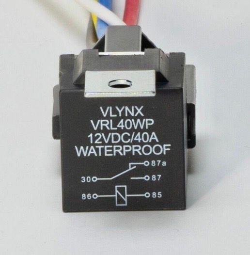

I appreciate that I found this subject with solution since I encountered the same problem need to solve.
I'm not a professional in electrical although I'm a engineer.
Regards to the abovementioned wiring of the relay, I have some queries and hope if anyone could advise me further.
1) if 85-86 was provided constant 12v, my understanding is 30 & 87 will normally close at all time. So, what's the purpose of 87a connect to the open trigger?
2) while 30 switched on, will it trigger both open (trigger by switch) and close (trigger by relay) at the same time and cause ECU malfunction?
I hope this old subject can still alert some professional to answer. Thanks in advance.

Professional is a stretch but it's not clear if you're trying to fix or devise something, this example from the internet is typically how one relay is wired and used but if a logic gate function is the goal you could probably do it with several relays.
