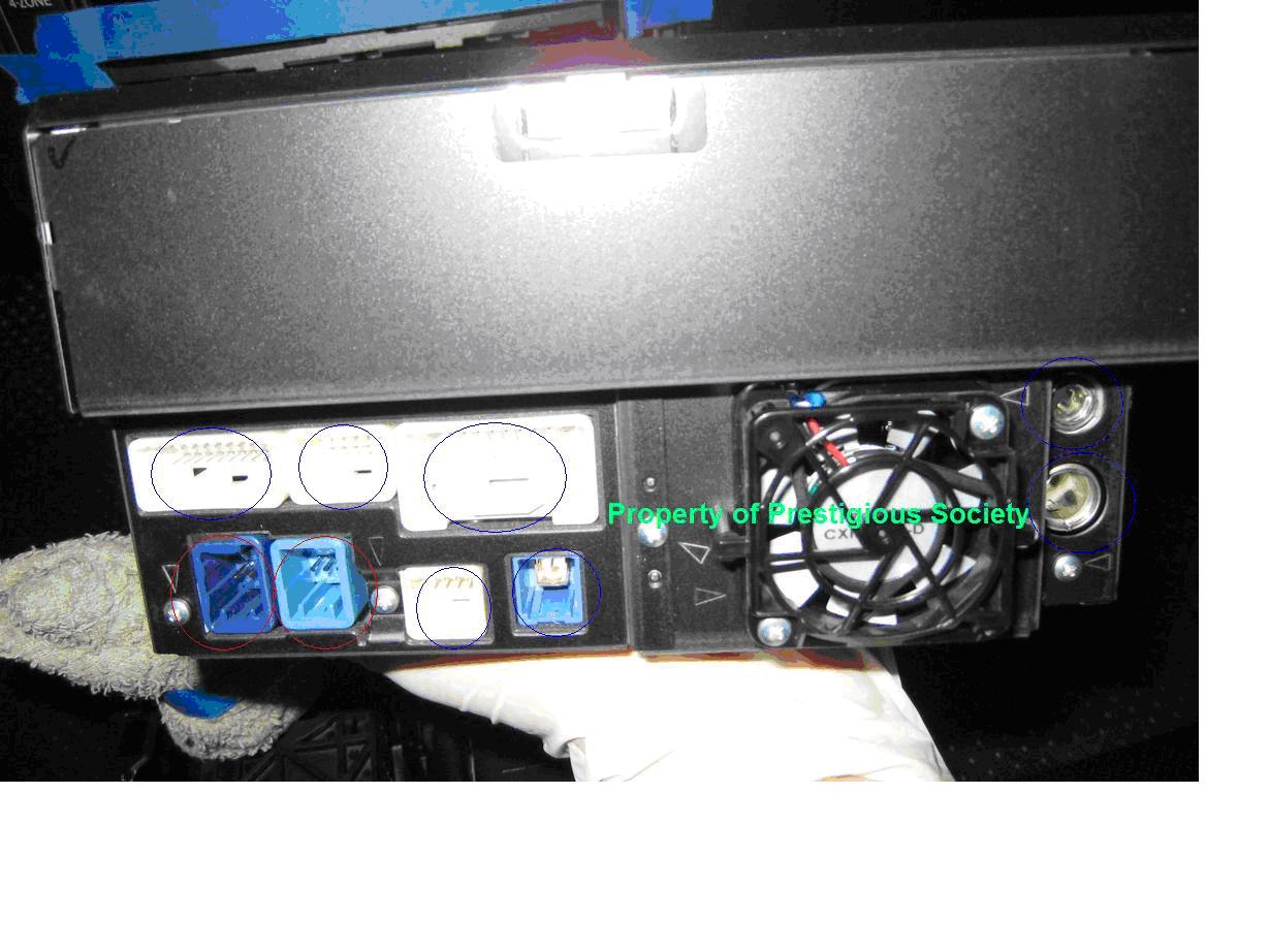

all those harness are at the back of the audio unit. you will need to take apart the shift plate area panels, then the ashtray. then you can access the audio unit. once you pull it out, look at the back of the unit and you will be able to see all the connectors, factory wirings, etc...
when you get the vaistech unit, it will come with their own harness (two ends, one mail one female). so you unplug one connector (factory) from the audio unit, and plug that into the harness from vaistech.
then the other end of the harness from vaistech, you plug it back into the factory audio unit.
i hope this helps? i have done a lot of nav override install so i have seen the back, but i don't think i have picture of the back of audio unit. let me see what i can find

Thanx Henry , The configuartion is understood but the problem is with the head unit, i looked so much in the car thinking that it might be hiding somewhere. But ended up with nothing. I hope you can help me what to unplug to reach the head unit. Thanx.

you are in luck man
here's a picture of the BACK of the audio unit (where you put in the CDs, etc...) so you can see there is a row of 3 WHITE connectors. from reading vaistech's instructions, seems like you are playing with the right one
sorry to jack the picture by prestigious society

oh, lol, head unit means the unit where you controls all the audio and insert the CDs. and they are talking about the BACK of the unit, so that's why you couldn't find it

no, you just have to pull it straight out (the audio unit is held down by 2 screws and couple of clips). but in order to access them you need to remove the shift plate and the ash tray and the panels right by the side of center console

What i meant from the picture above, will the configuration have many wires outside , or all wires will be hidden like the picture above ?

all the wires will be hidden behind the audio unit, there are tons of space. you just run that wire underneath the shift plate for example to the armrest area for the ipod
