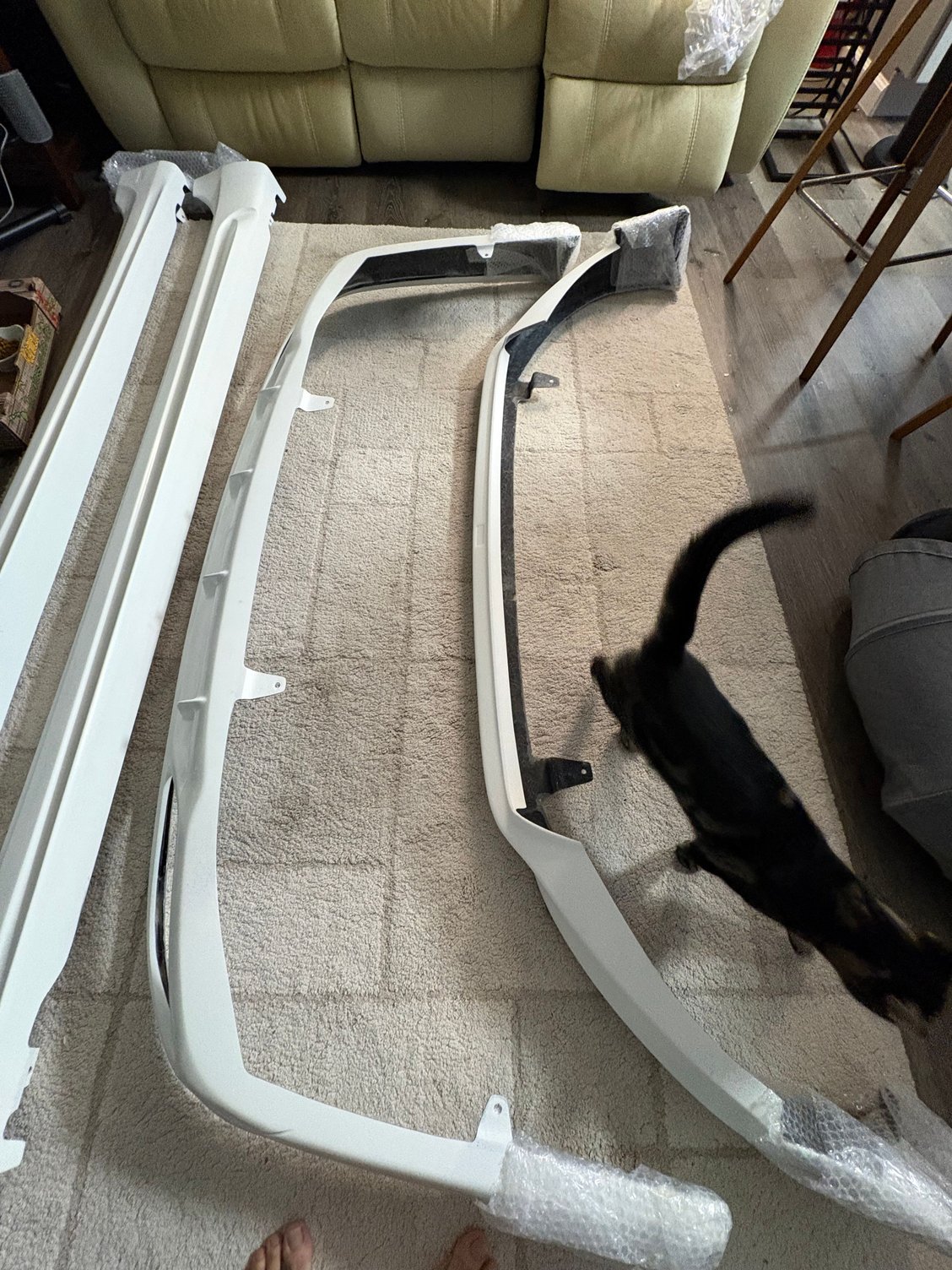

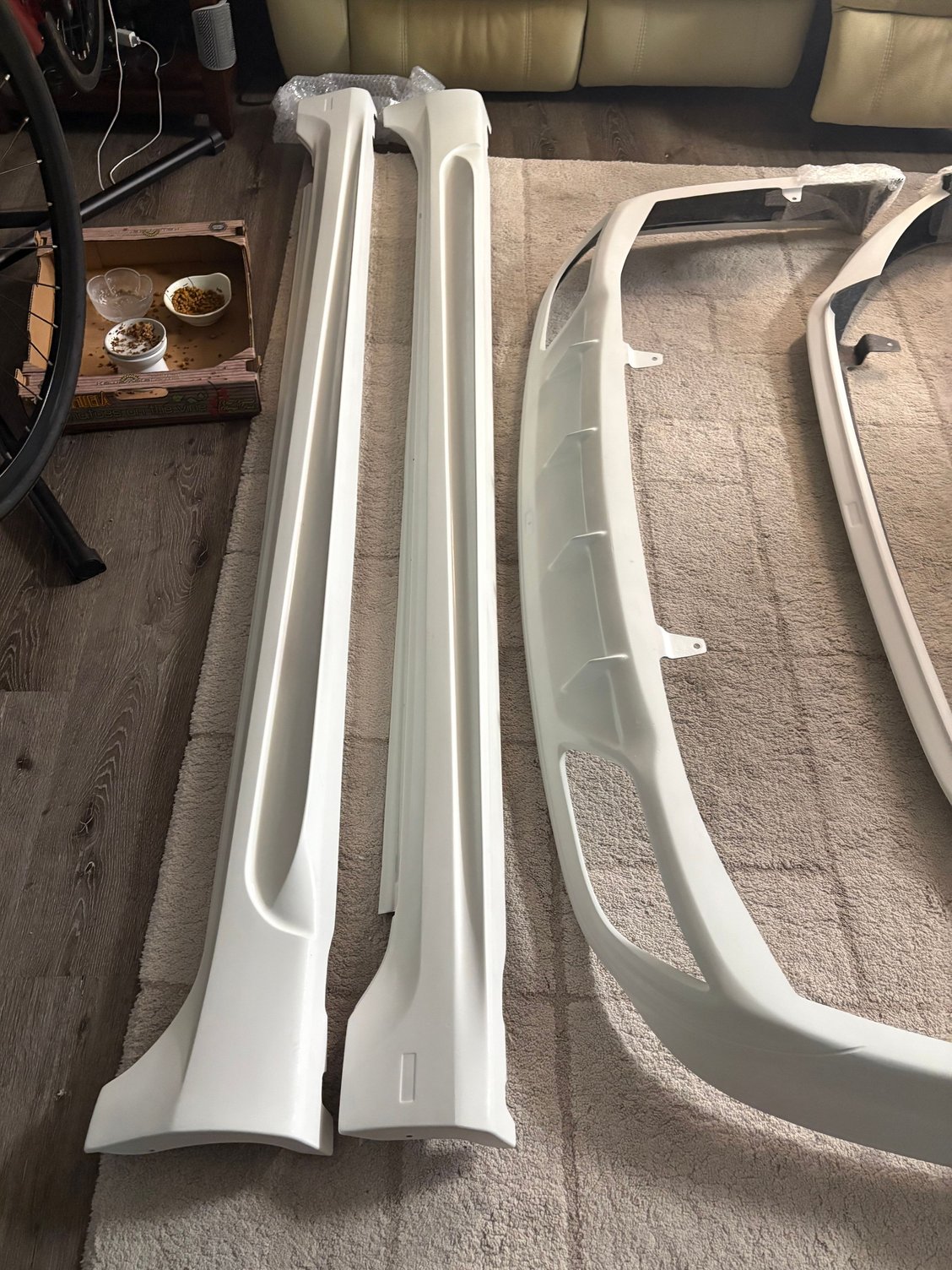

Hello,

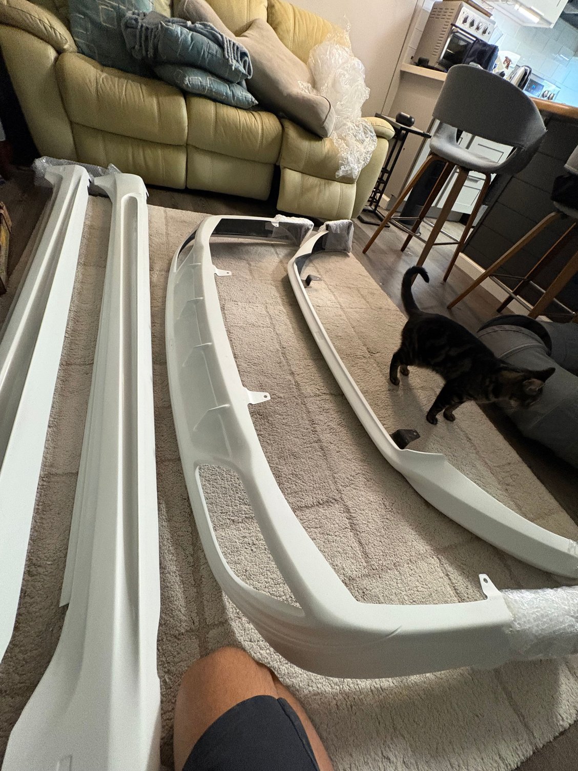

finally arrived. Process may be slow since I now live in a condo instead of a house. Will try to update periodically of the progress.
enjoy the journey with me. Took about 3-4 months to arrive. Just a lip kit since I can’t afford full bumpers.
i have another thread of my artisan spirits install build if anyone is interested on the zenki ls460. Went with aim gain this time around.

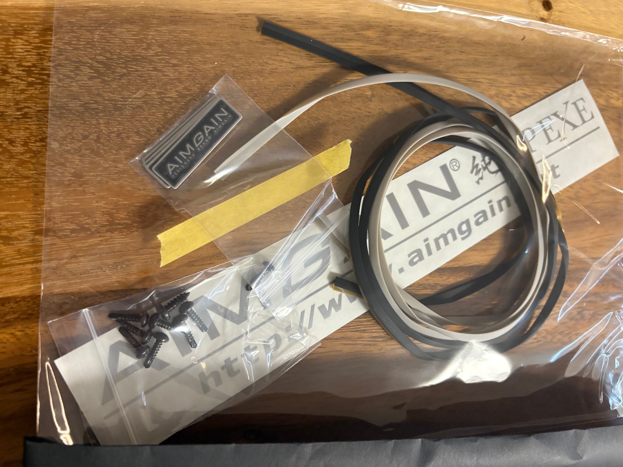

fist off im surprised holes were pre drilled but that’s about it so far. Just got home so will update later.

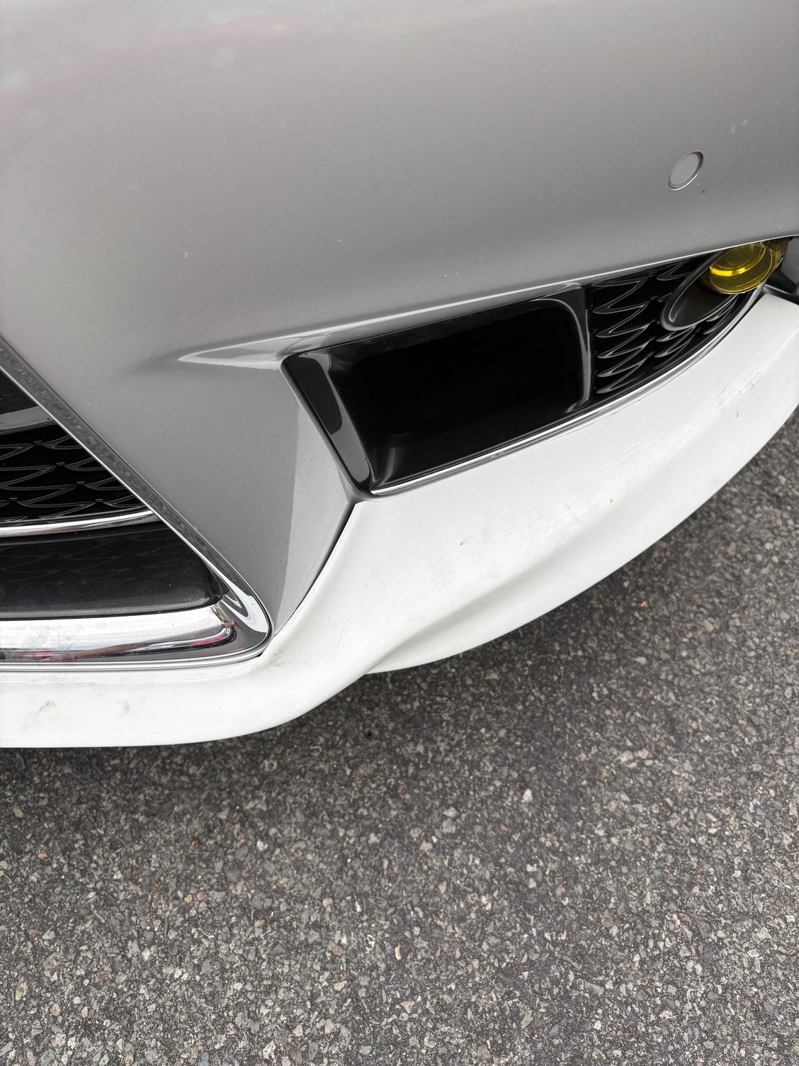

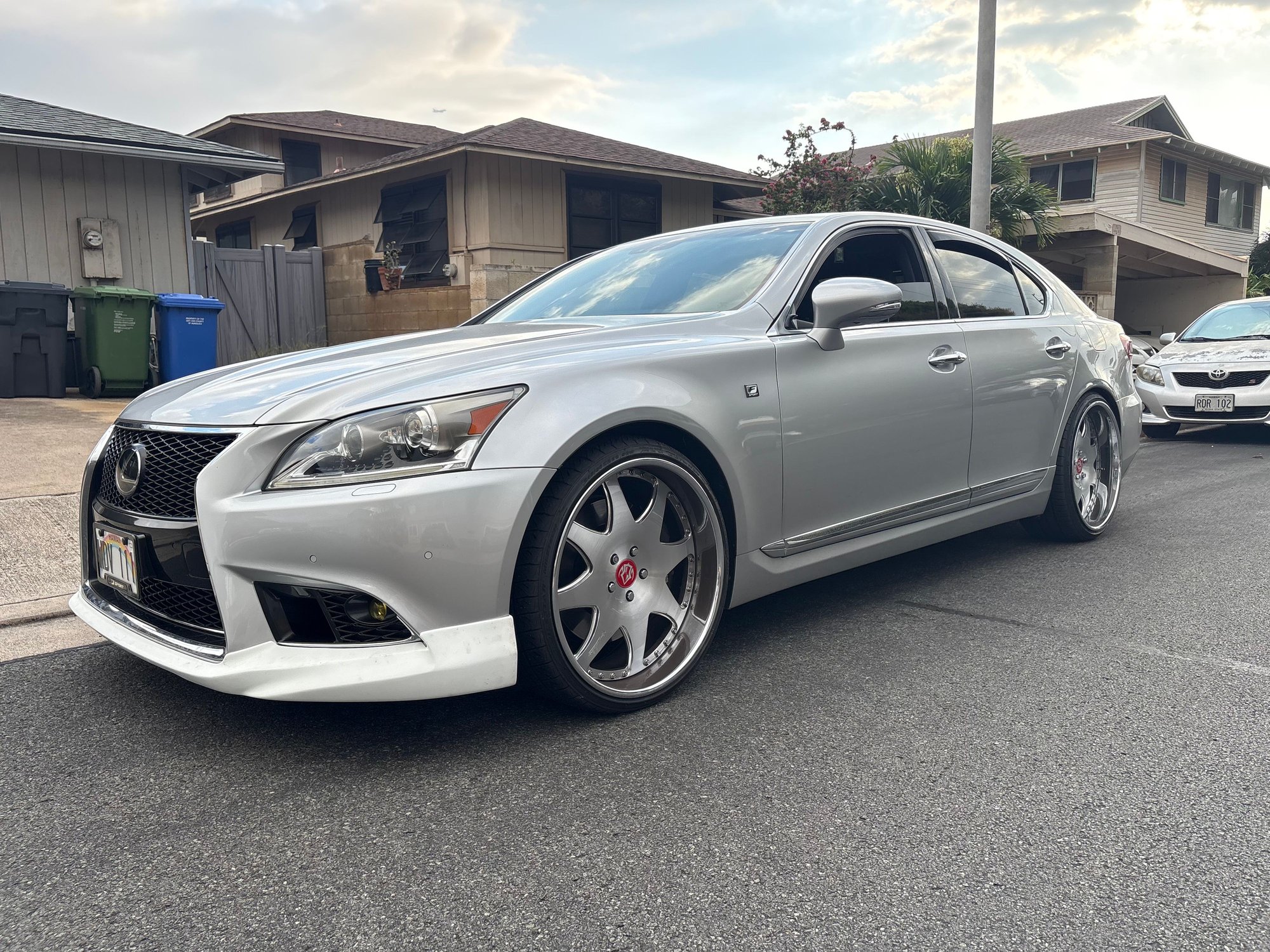

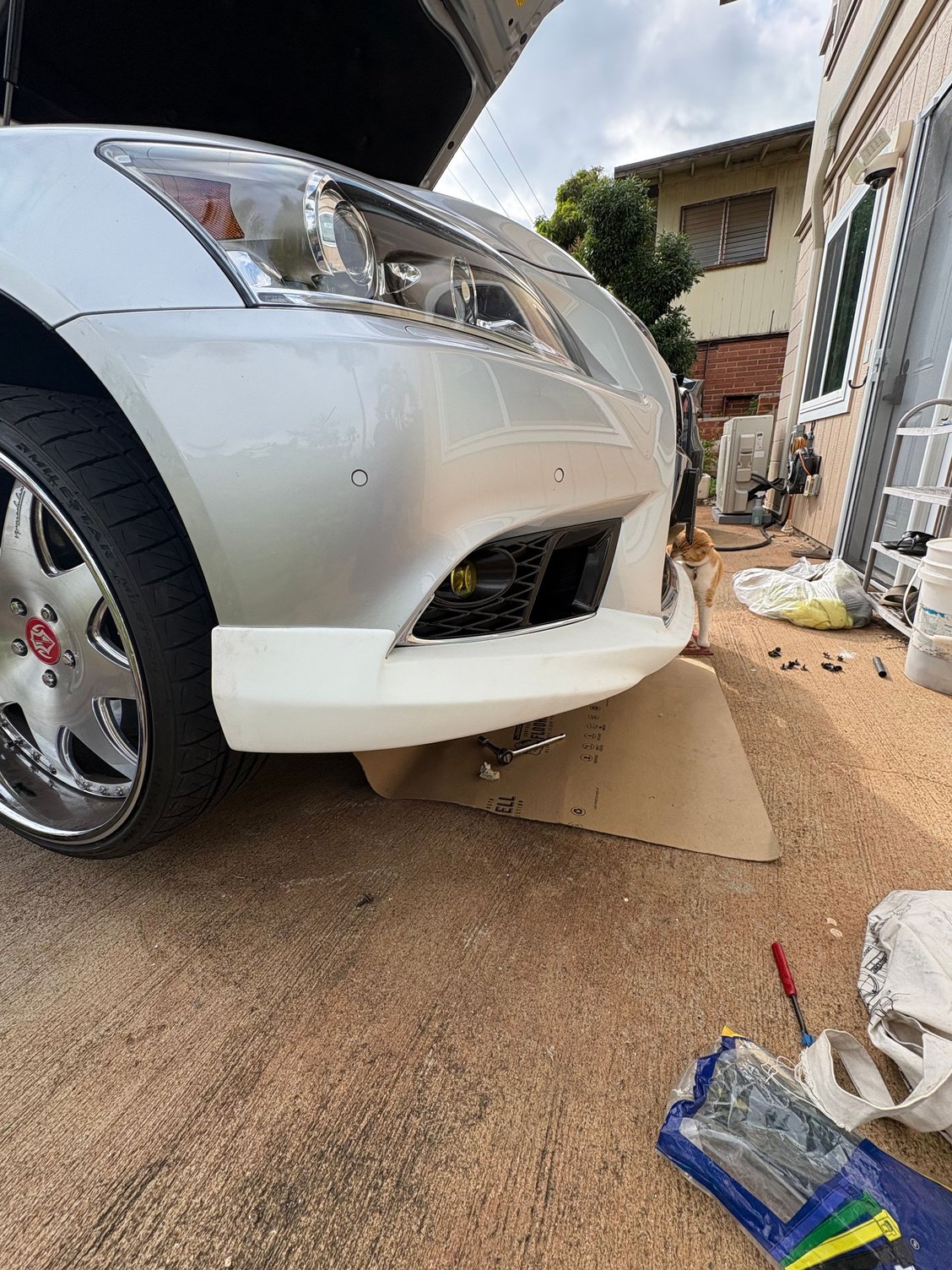

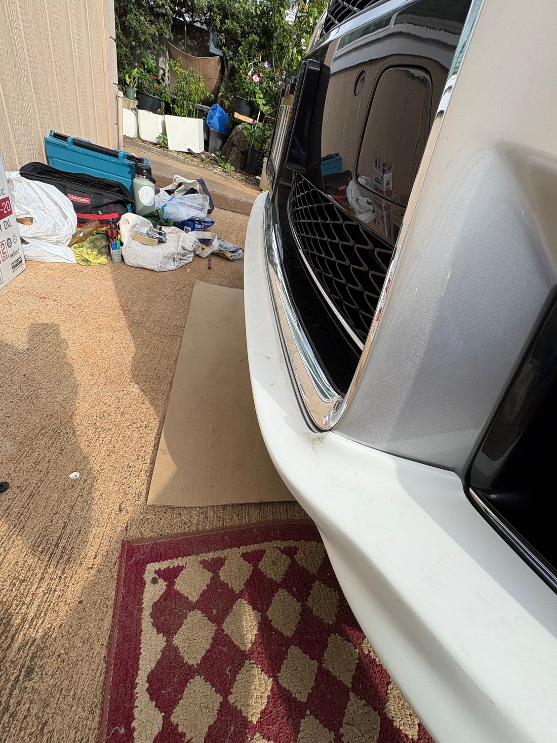

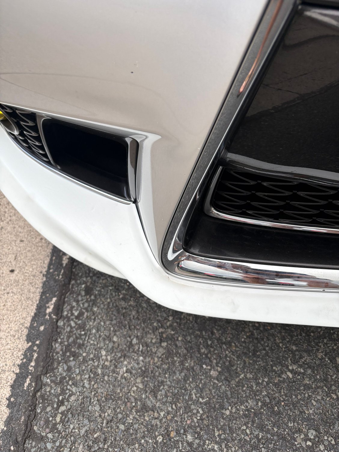

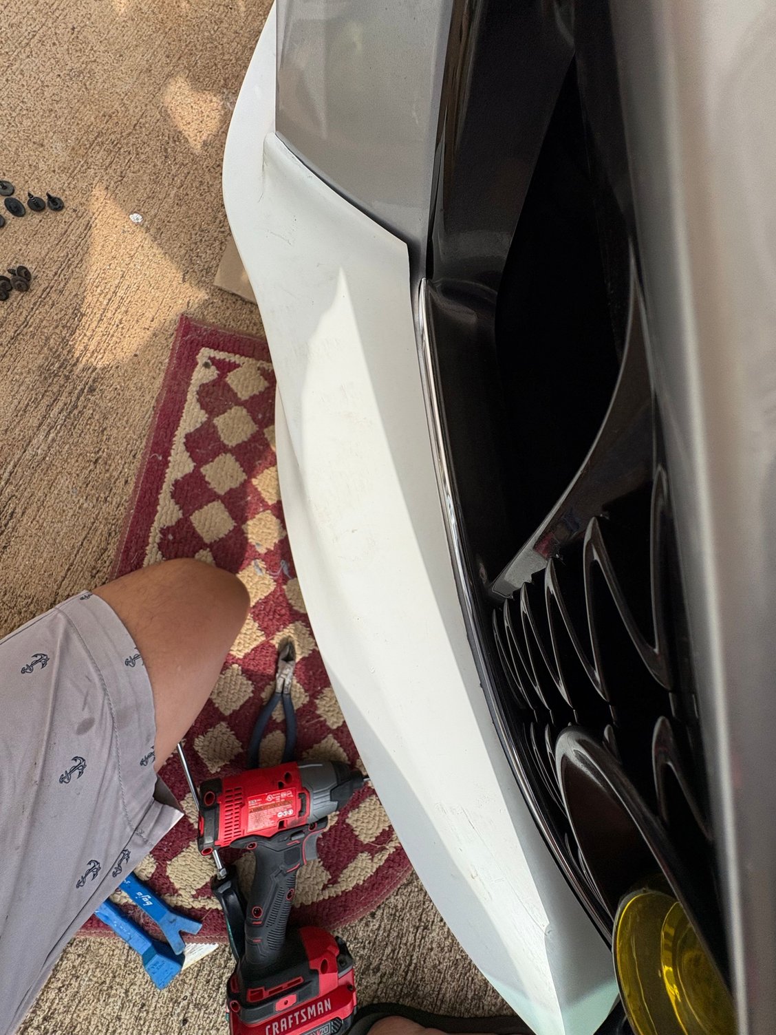

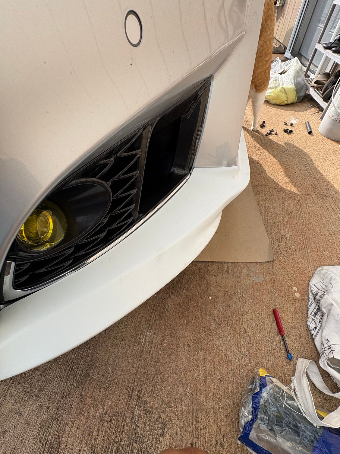

Some updates. Did my front lip since I was doing my 10qt oil change.
Used to spend so much time trying to get perfect flush fitment but I just don’t have the space (live in a condo now) so only did a little sanding. I will say the aimgain fitment is better so far than my artisan spirits kits. Plus I’m old and just made 40 today lol. Oil change and lip install for my bday haha

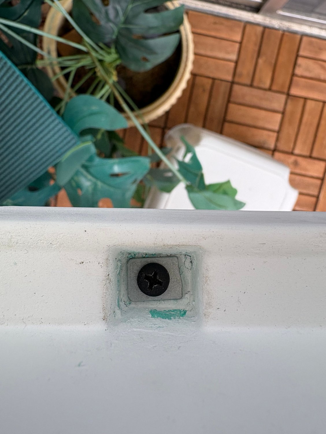

waiting on my fender washers as this kit is frp and don’t want to risk cracking at mounting points.
May try to do side skirts tomorrow.

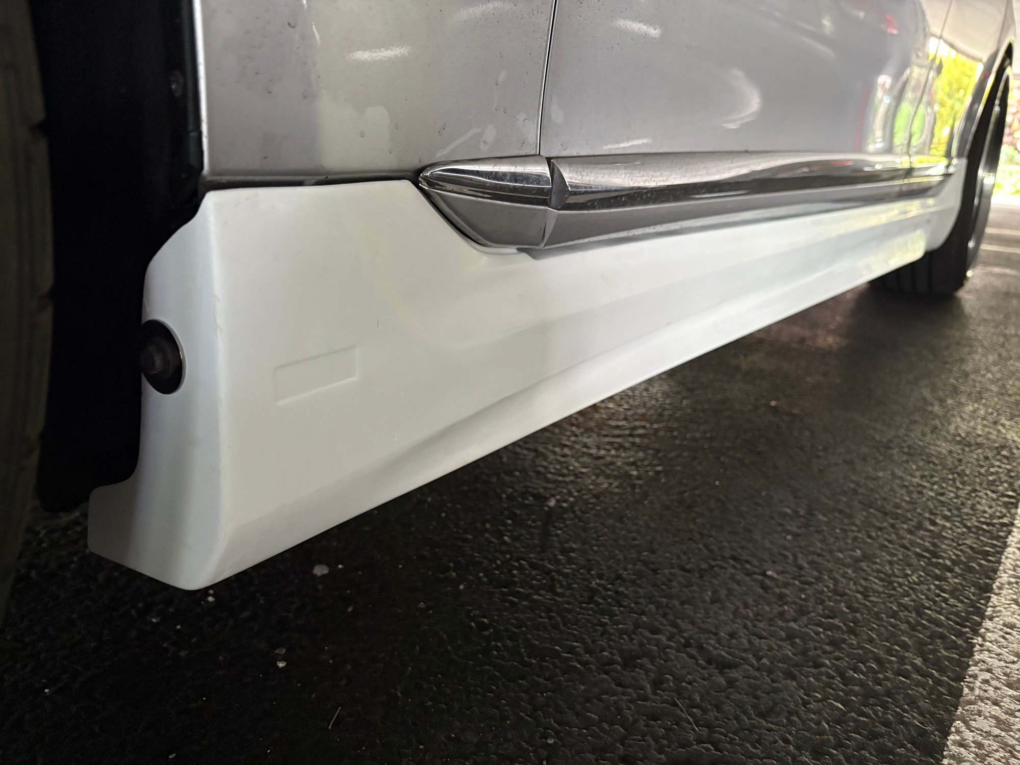

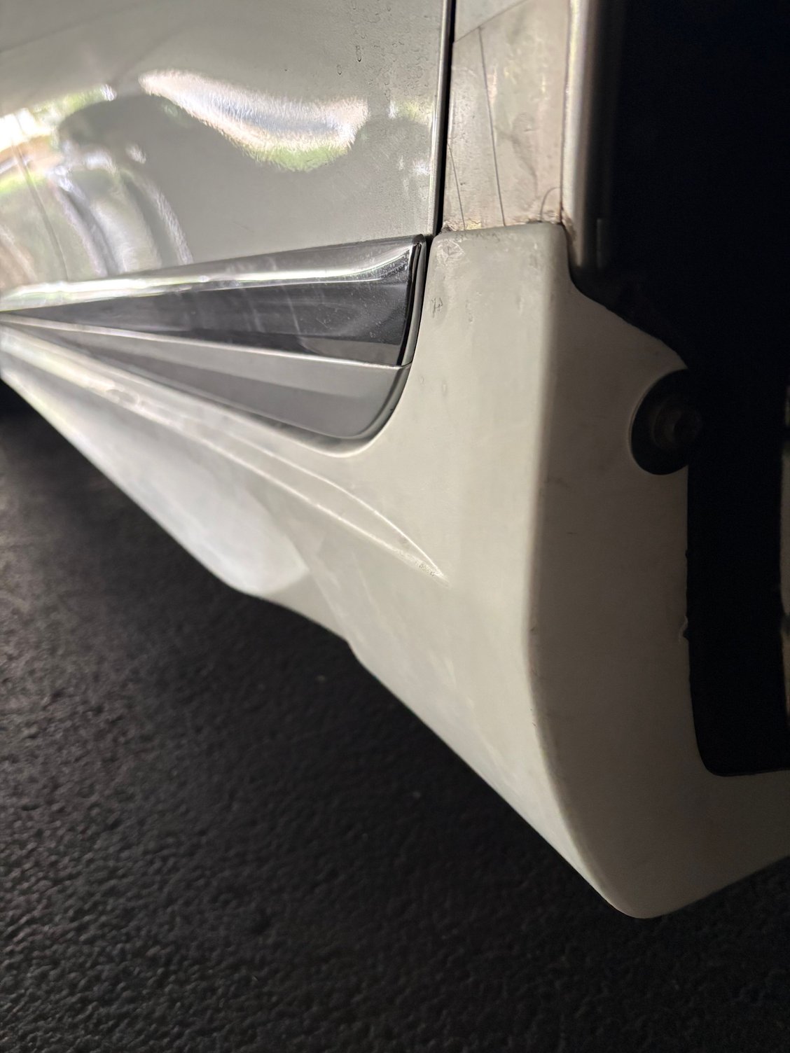

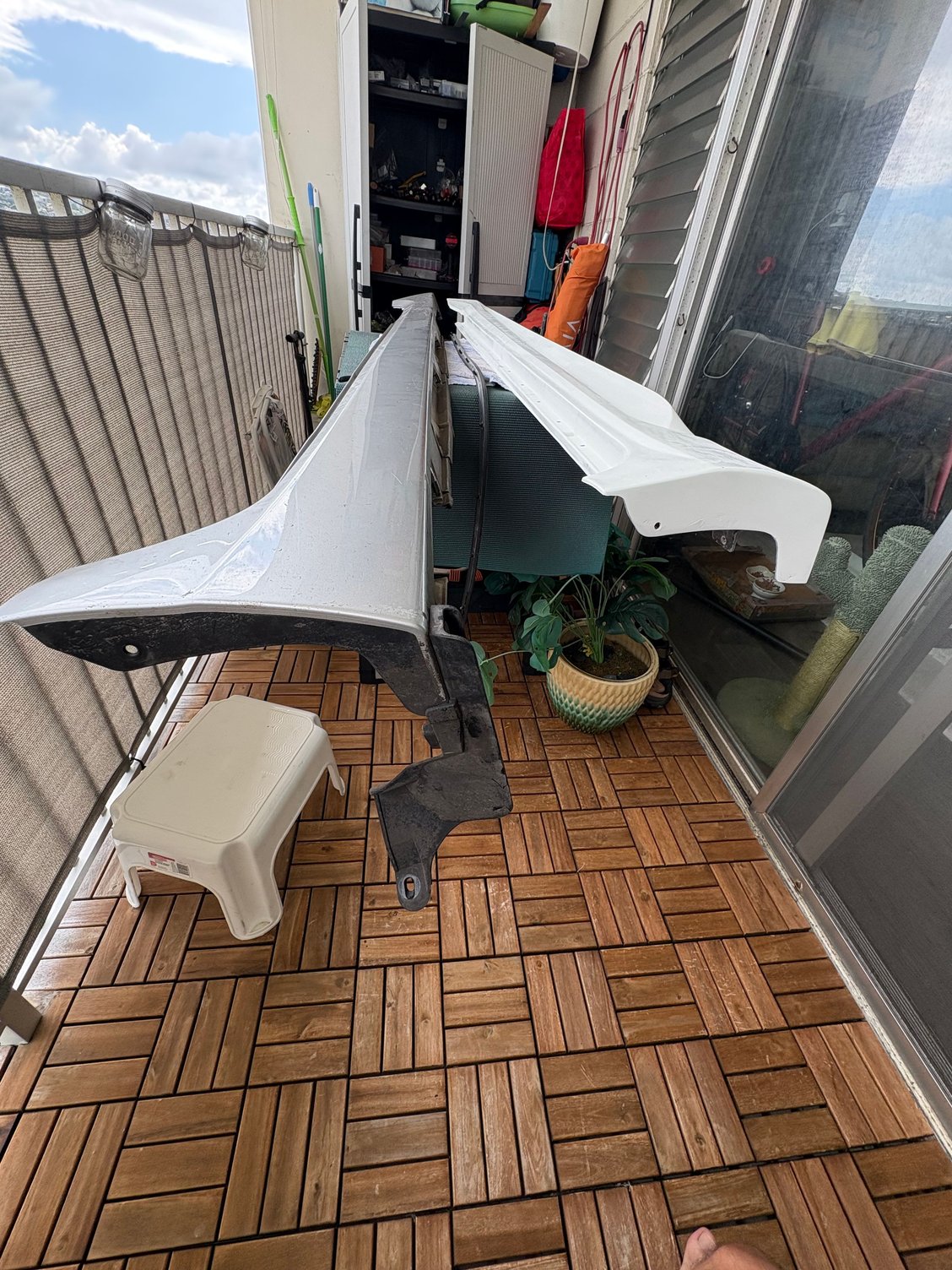

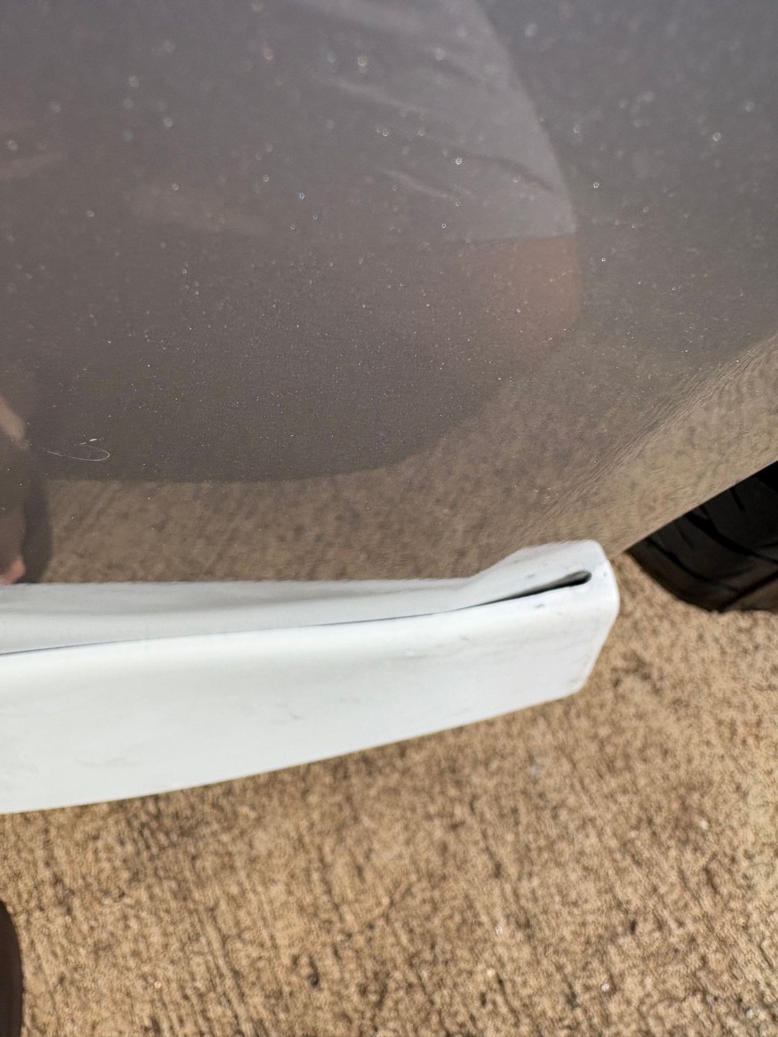

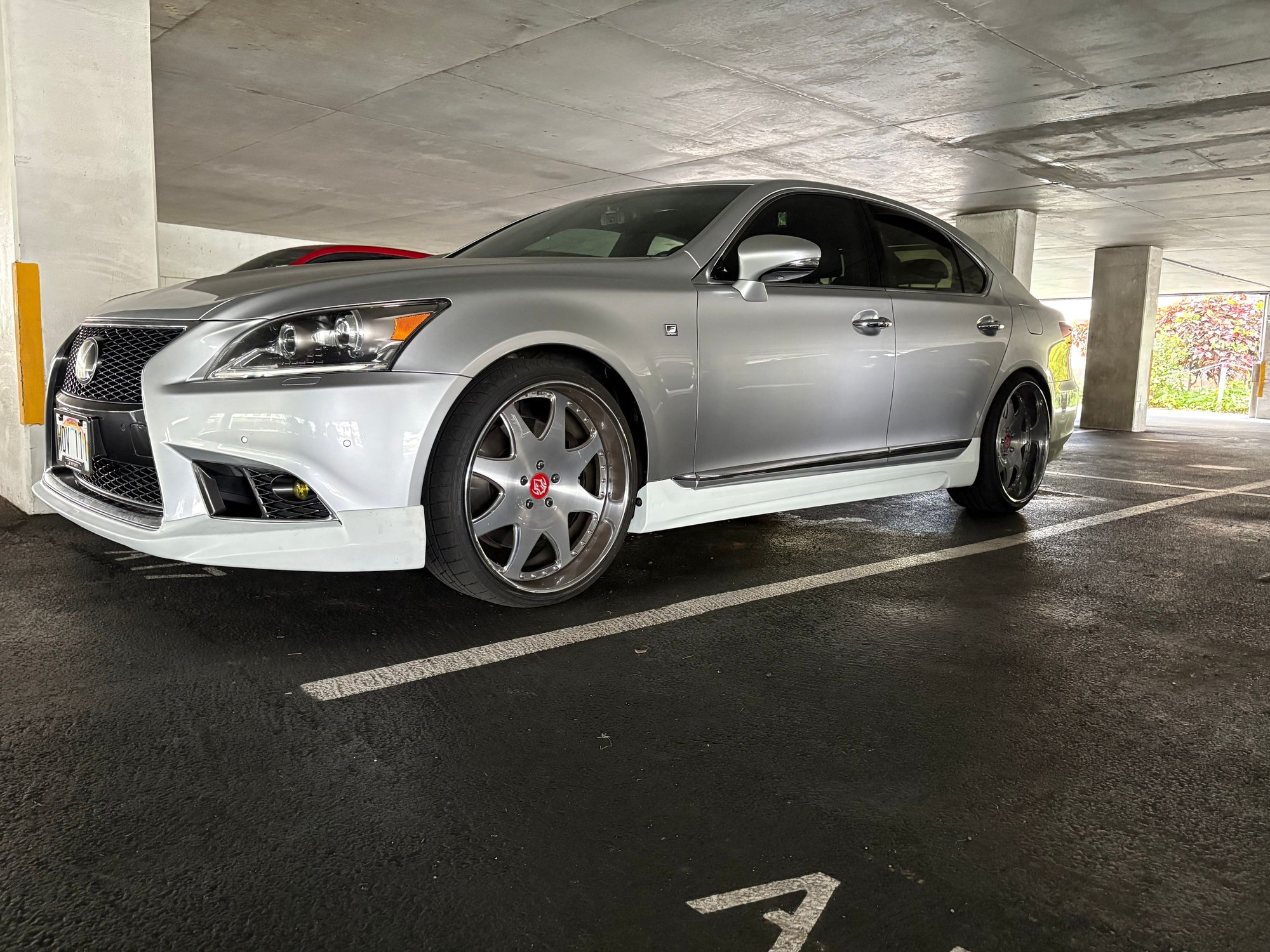

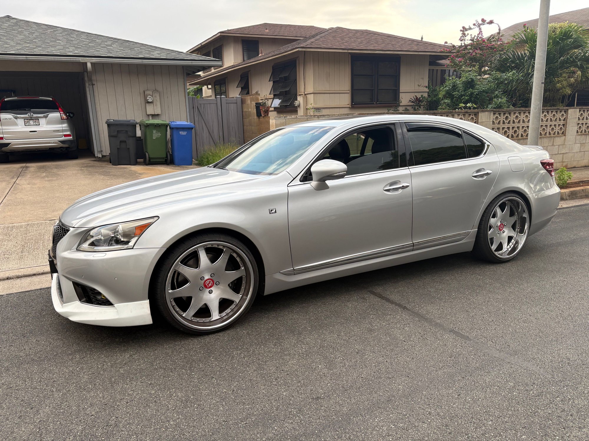

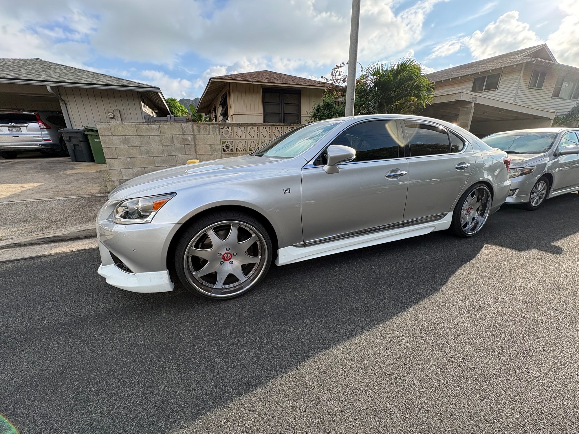

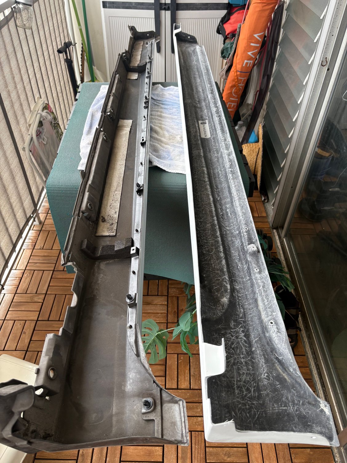

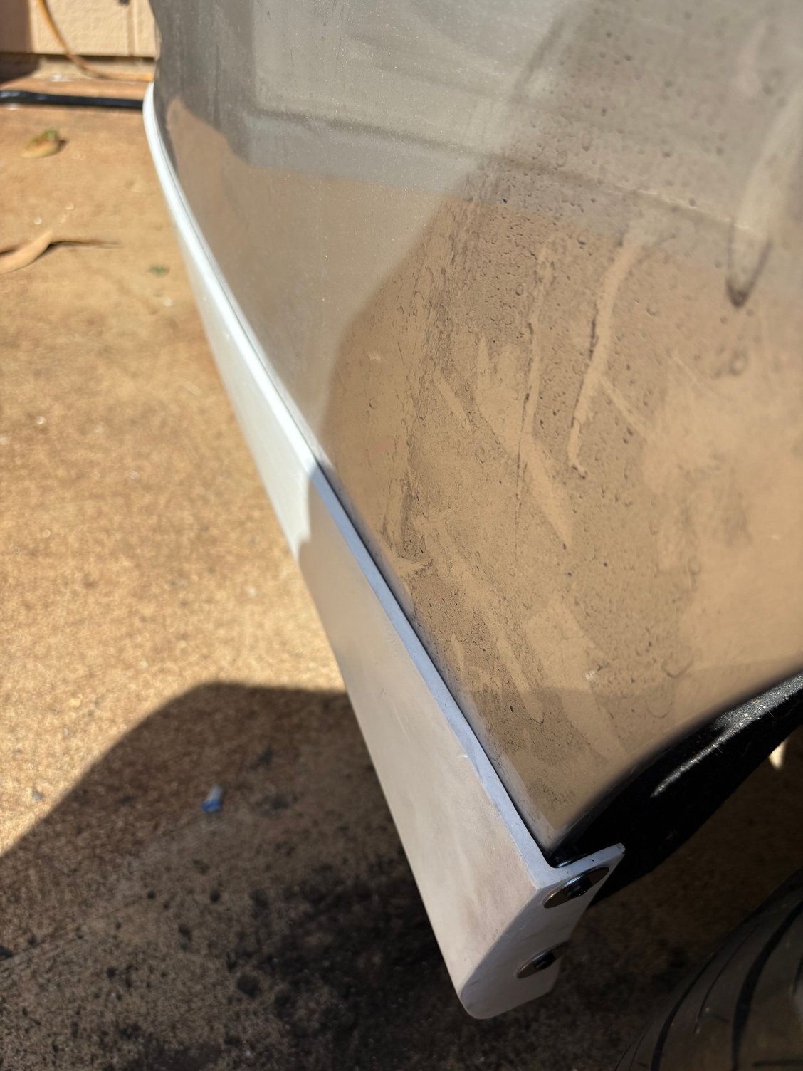

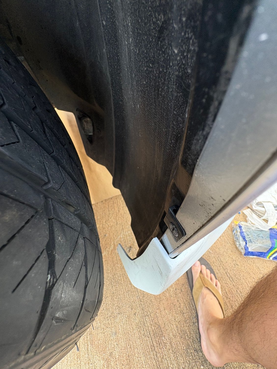

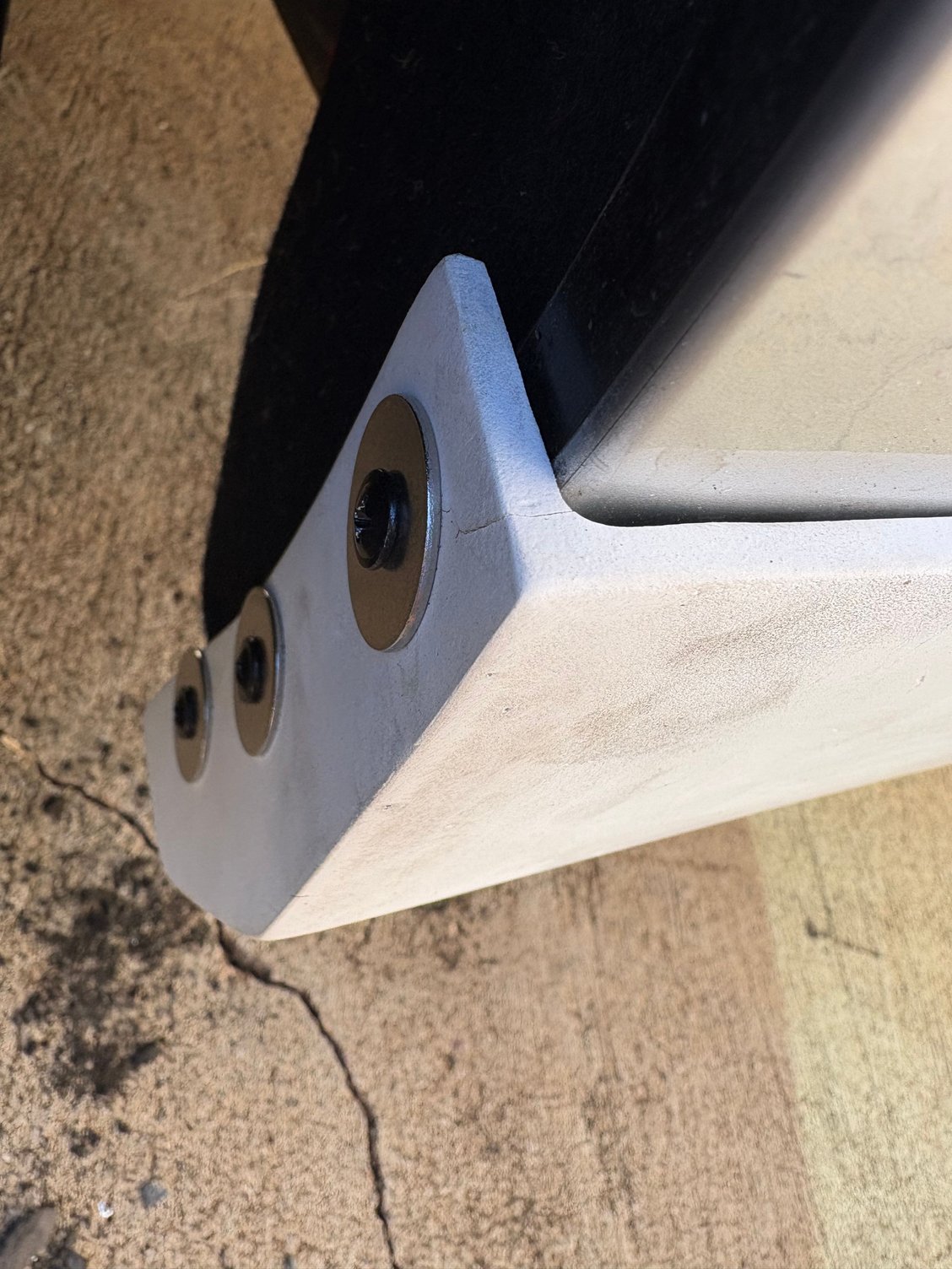

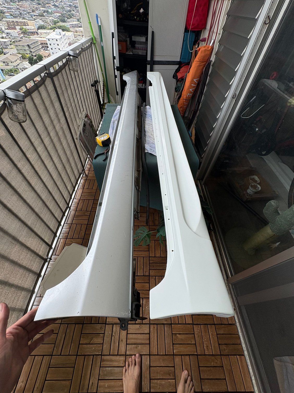

Next update. Side skirts.

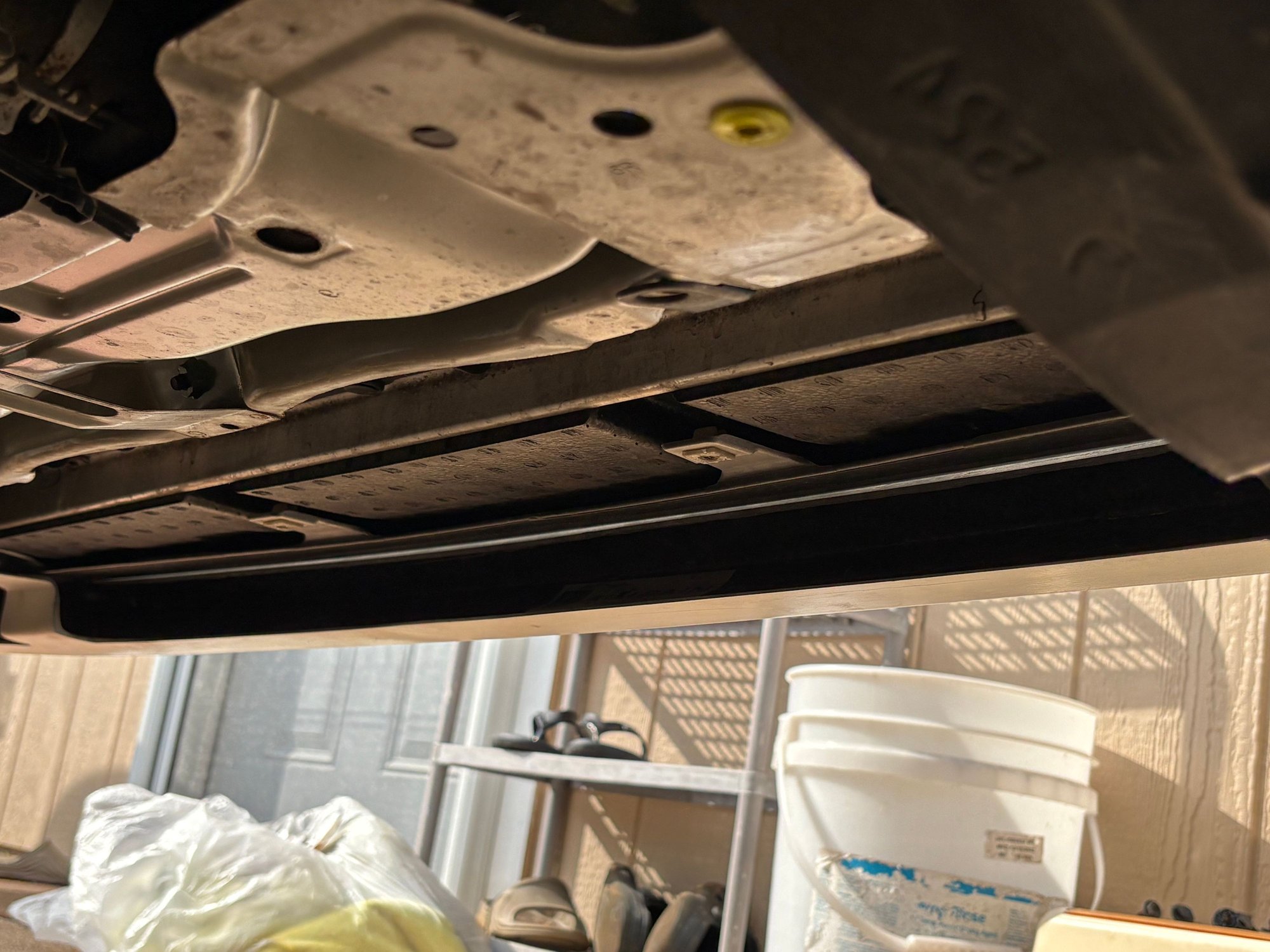

Very impressed with aimgain. I did have to bore out the holes A little more which involved constant trips up and down the elevator in my condo.
the mounting points behind the weather trim has such small screws it’s important to make sure there is good surface content with using fender washes and custom square washers. Be sure to use as much large surface contact for mounting for frp.
Two 10mm in the fender well, one on each wheel and one clip mount underneath on each skirt end and two small screws under the rubber trim.
next is the read lip but I need two people for that.
enjoy the pics.

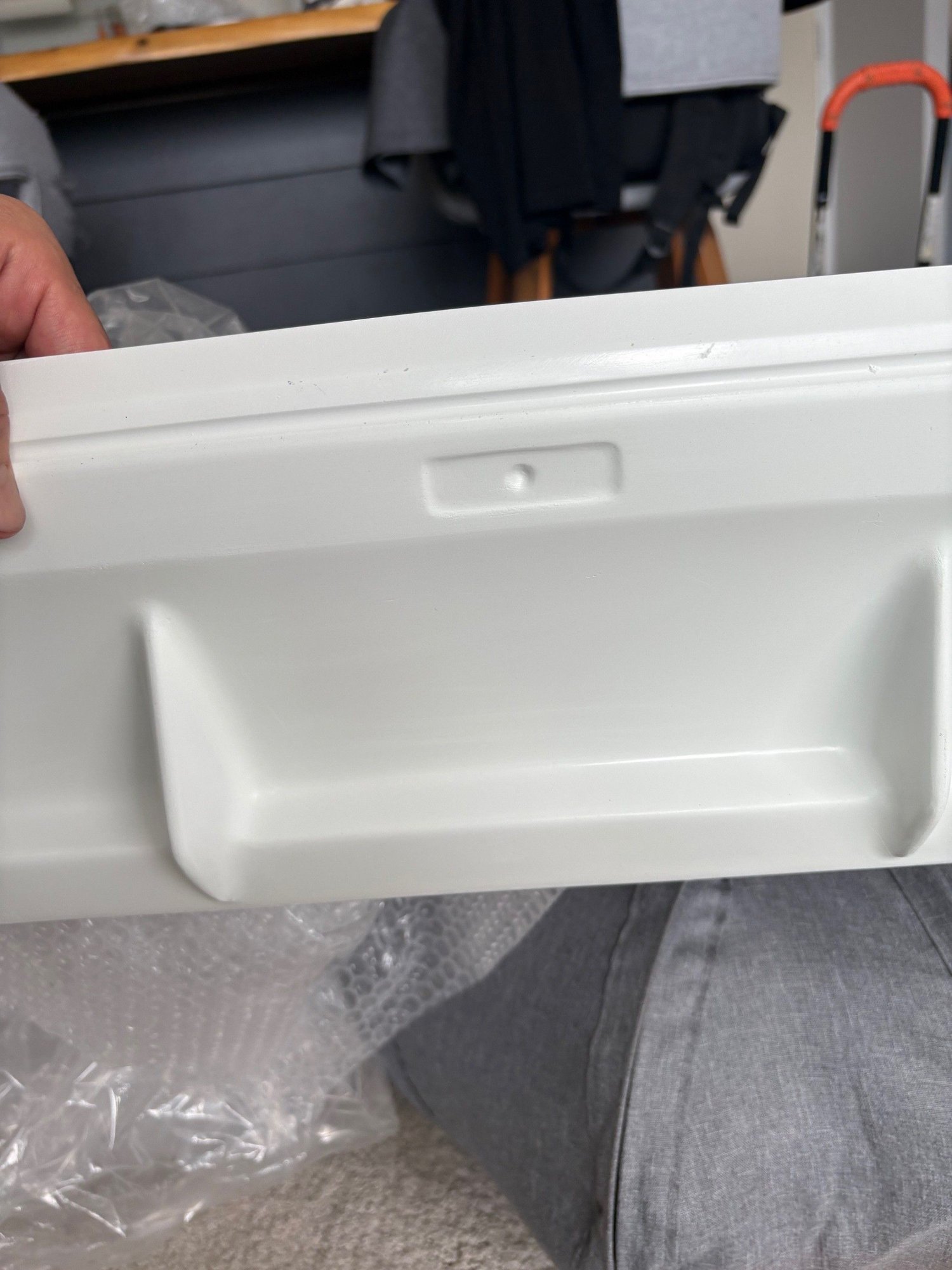

Hope to do the rear lip Thursday but rear lips are usually held a lot by double stick tape which i dont want to use yet as obviously its not painted yet. If i can mount it and it feels sturdy without tape, i will likely leave it on but the main stress point is right in the middle from my other kits experiences. This kit actually has a area where you can drill a screw (into your orignal bumper though) and it gets covered with the aimgain emblem, smart idea in my opinion.

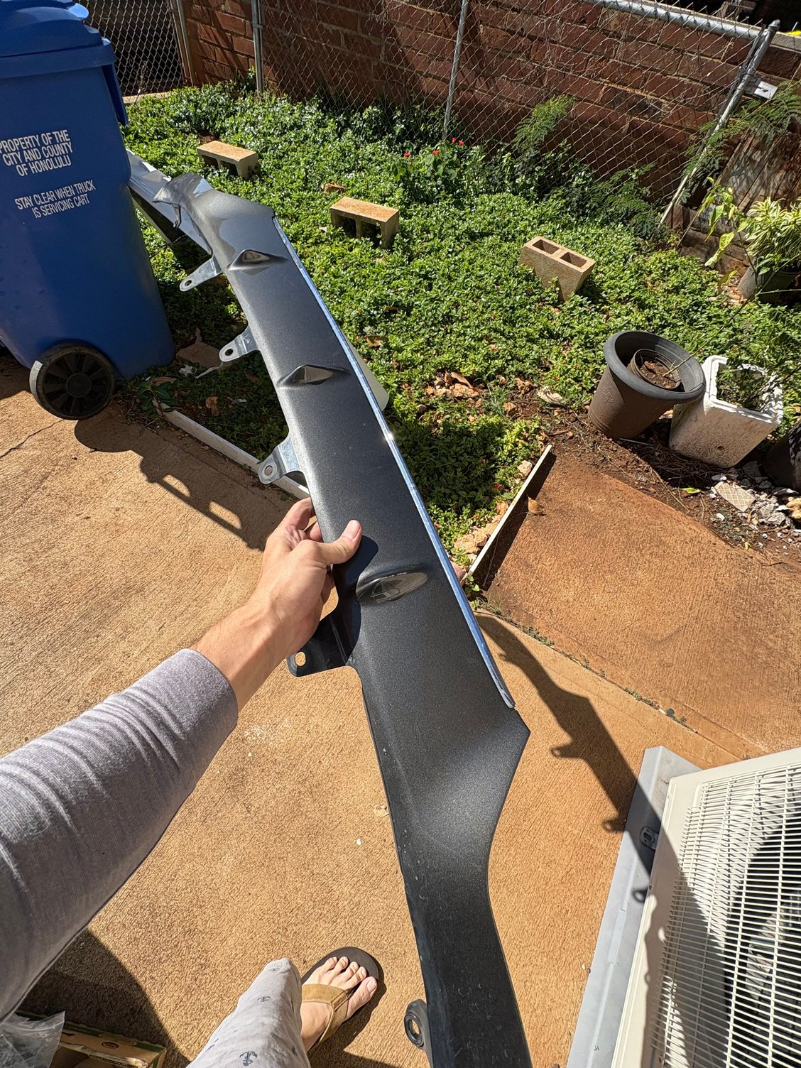

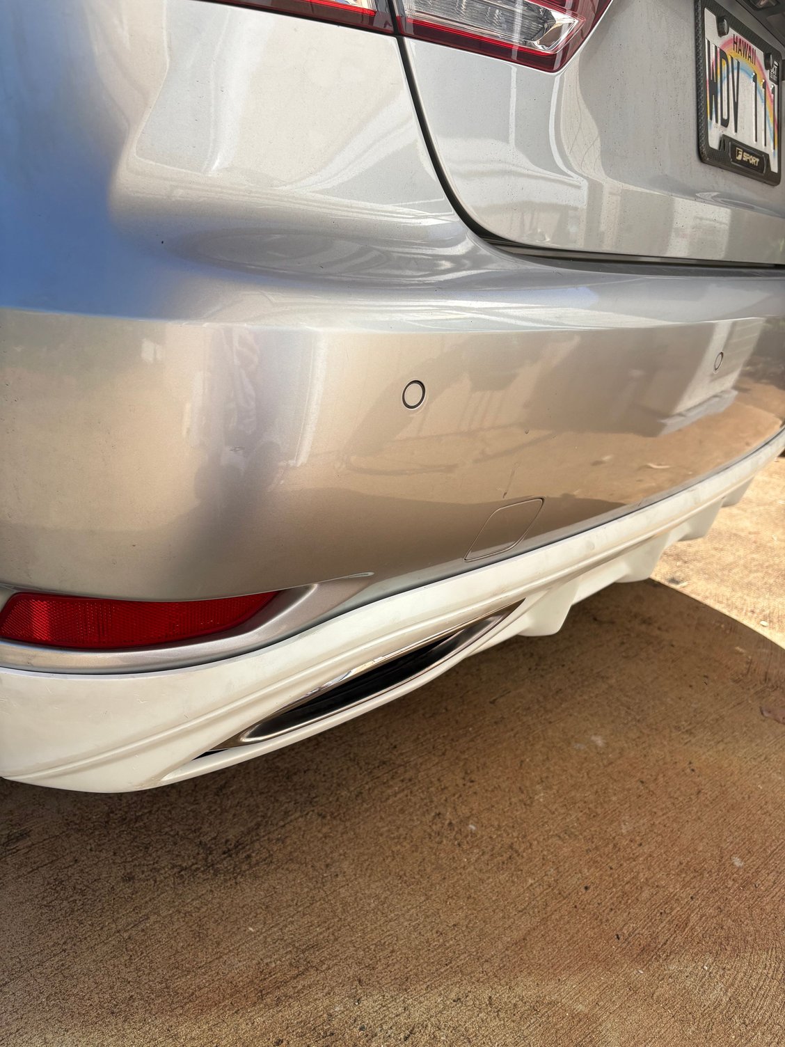

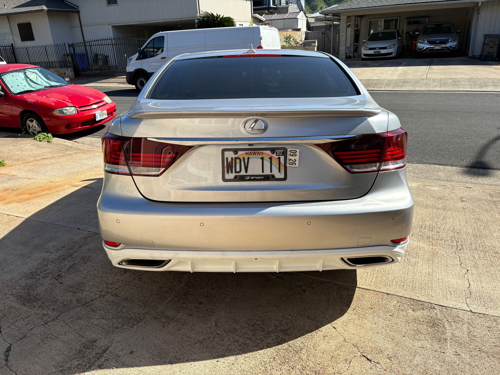

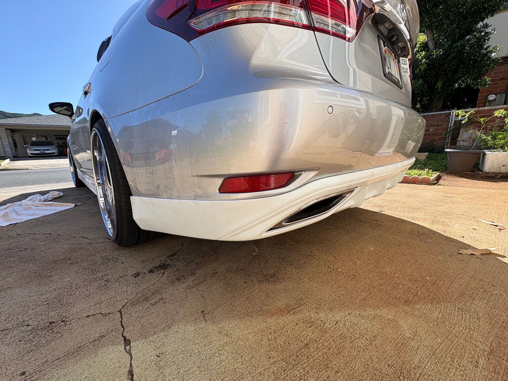

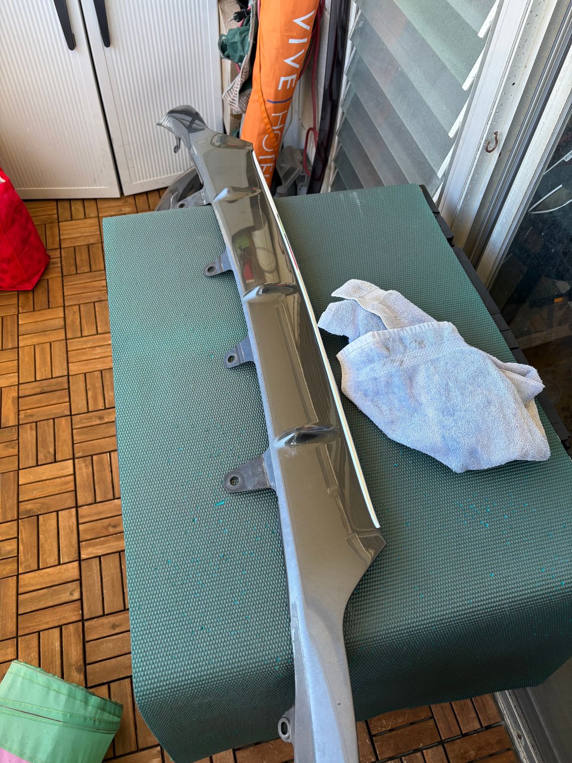

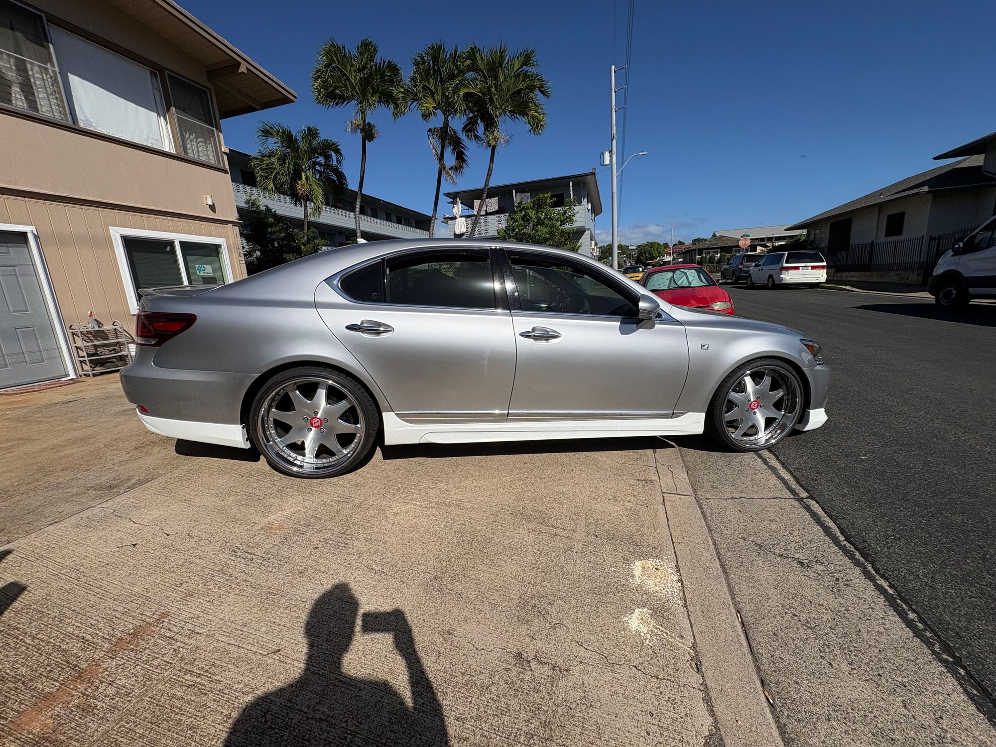

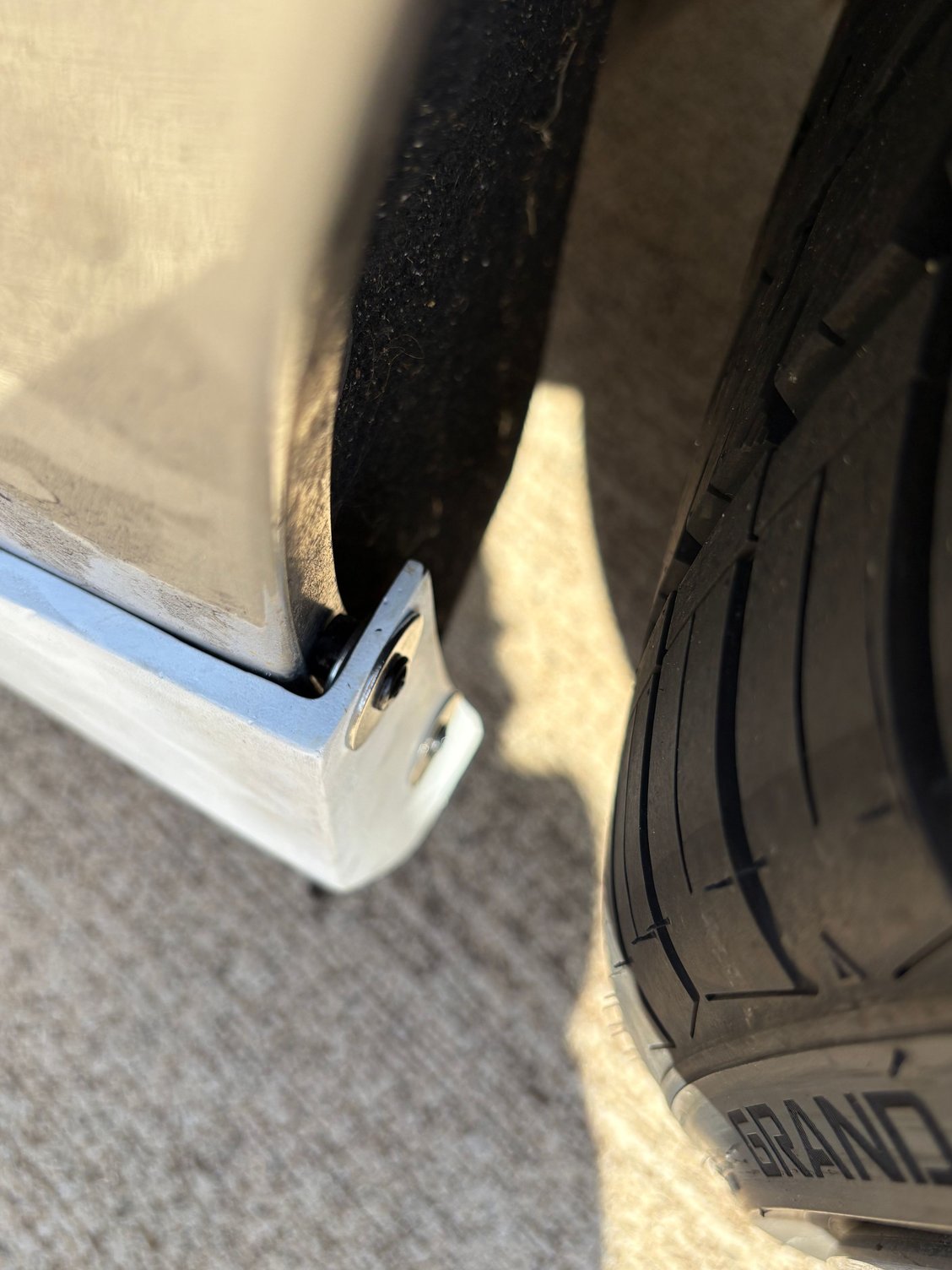

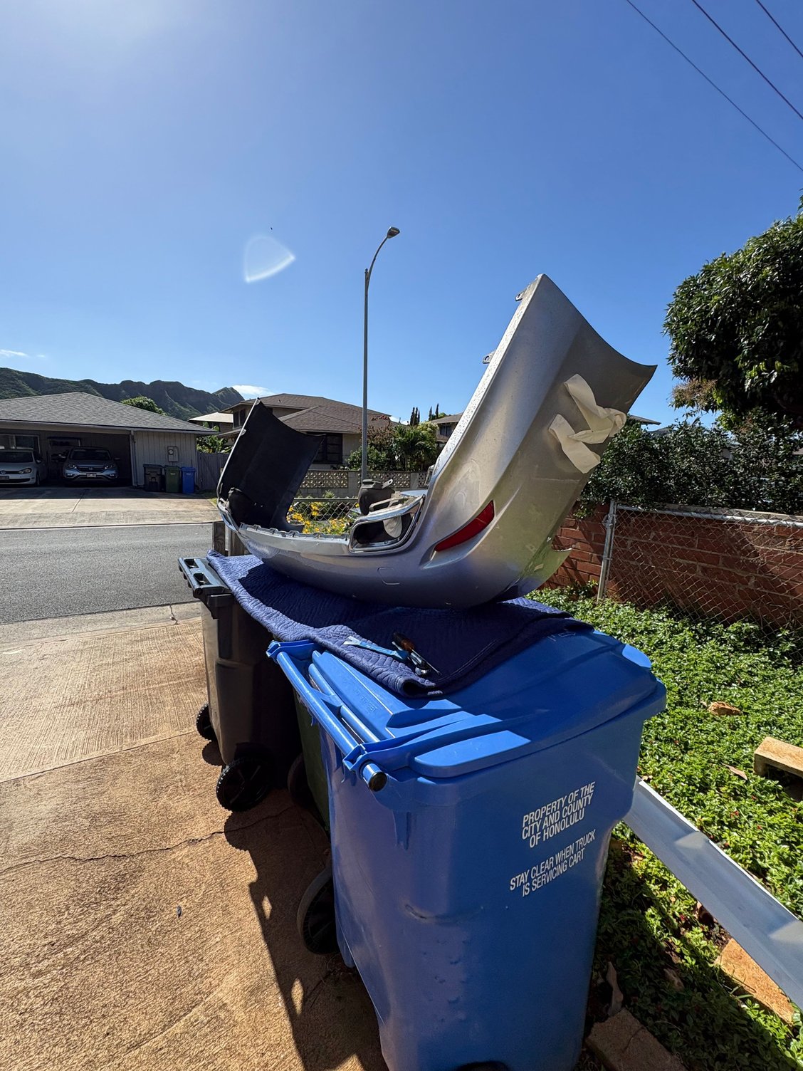

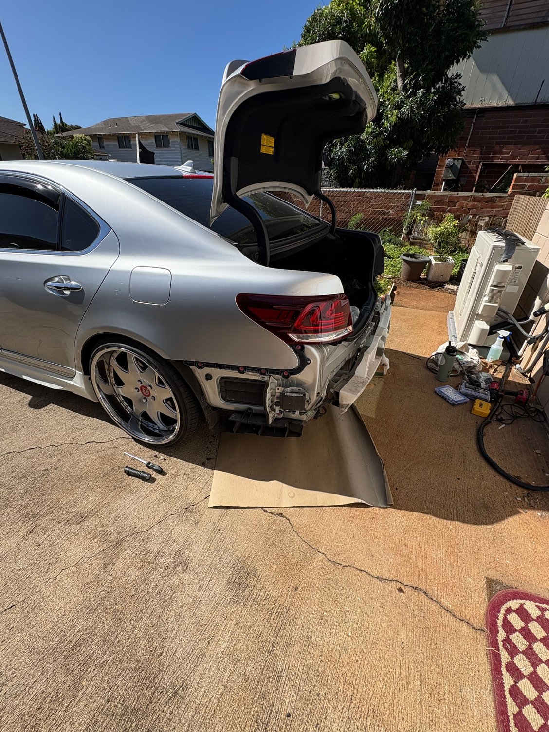

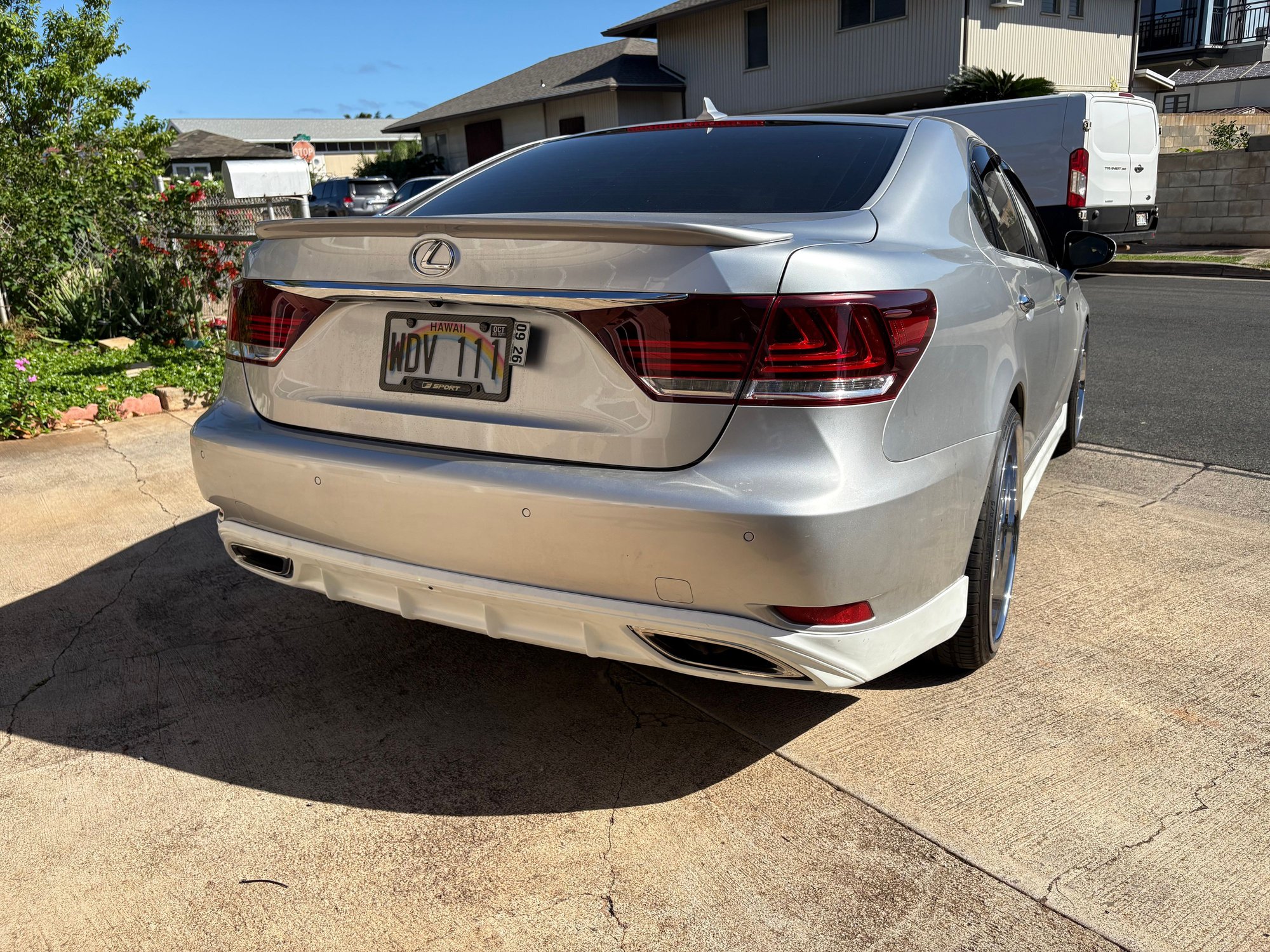

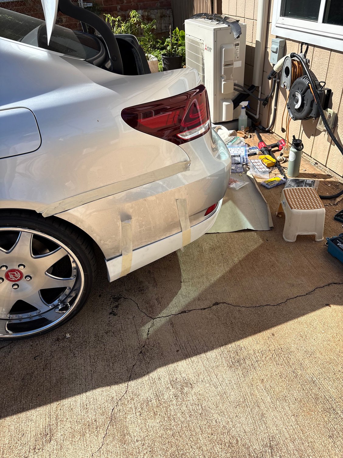

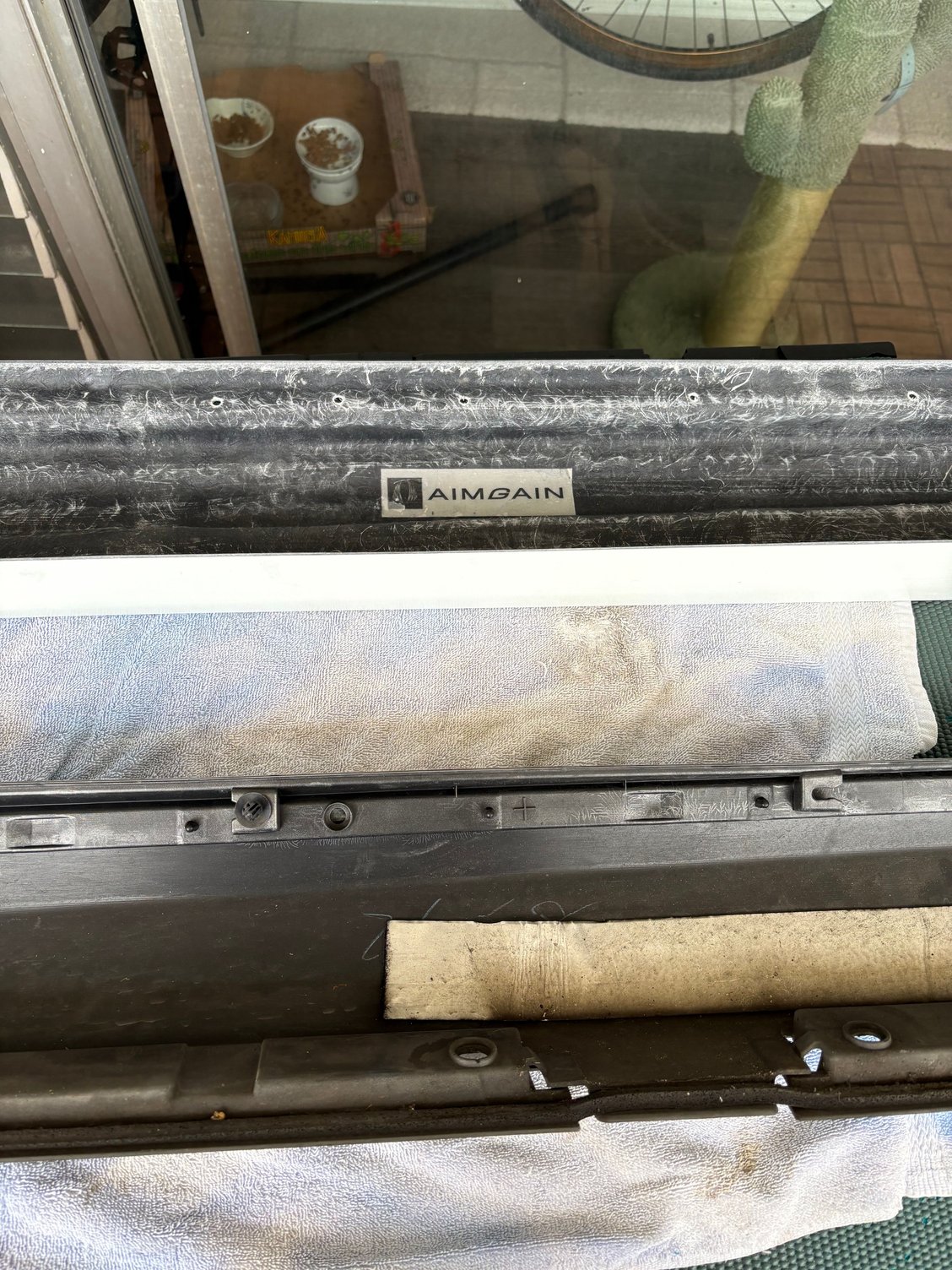

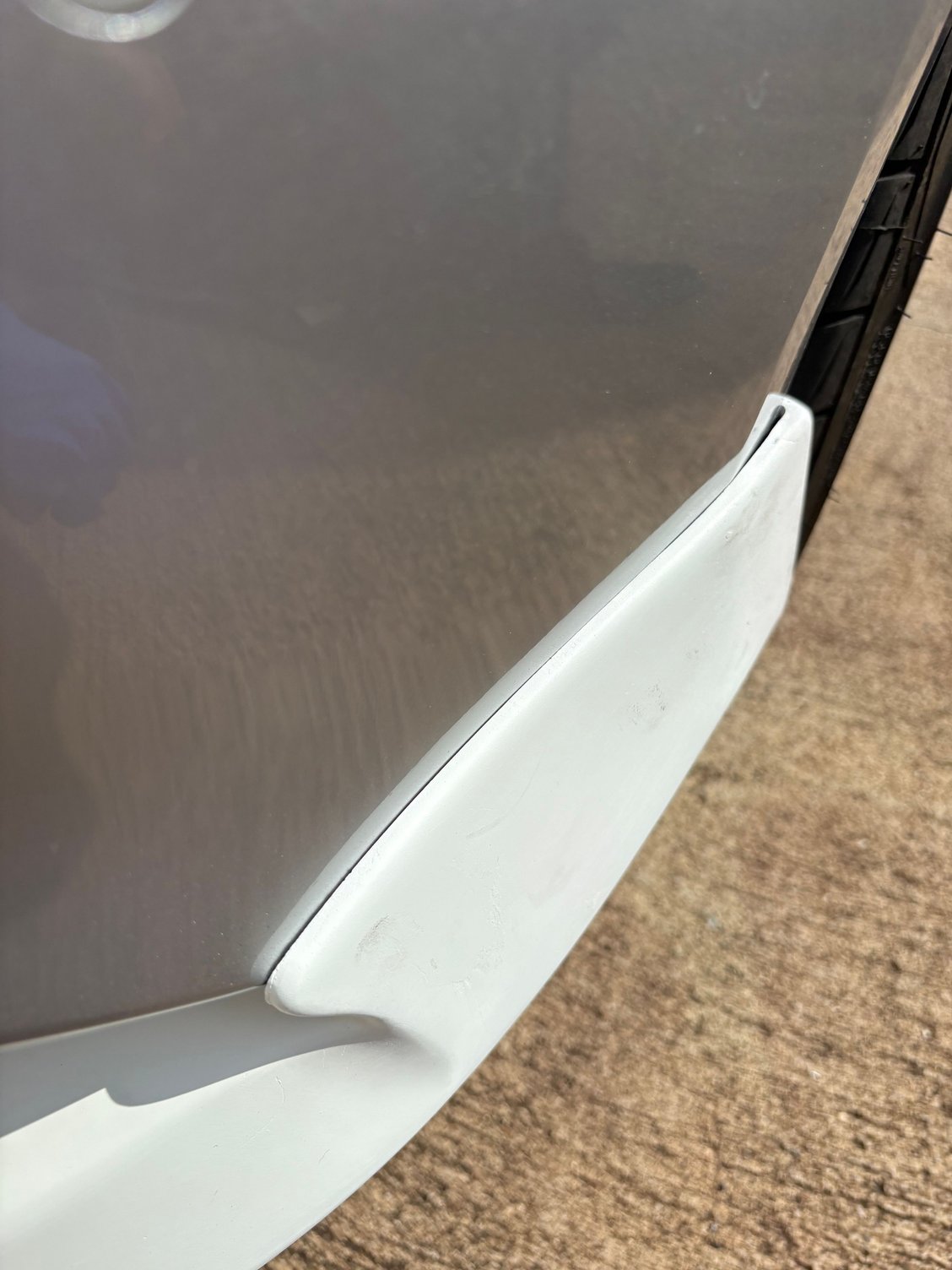

update. Finally done with rear lip. Took a long time the damn hot sun. Almost 3 hours. Drill holes, bore holes, test fit but super troublesome solo. Definitely going to want to have a set of assorted screws, nuts and bolts, fender washers, clips, etc.
rear bumper had to be taken off as the splitter had to be taken off. Fitment is 8.5/10 without any sanding. Had to also take the rear wheels off to drill holes. At this point I was tired and annoyed in the sun so didn’t bother sanding for 100% fitment. One side in the fender mounting points, I had to use nylon washers to essentially “pull “ the lip forward the front of the car to minimize the gap.
center screw isn’t absolutely needed if running double stick tape but at the moment I’m not running tape as it’s not painted so I screwed it in which means a hole in the stock bumper.

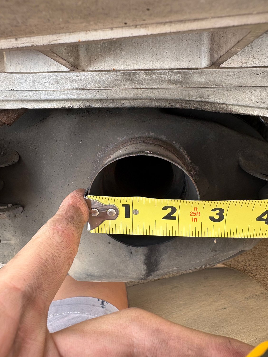

I had this idea of a dual exhaust tip on each side but it’s not centered. You would need a slightly angled exhaust tip. Seen some post with some folks with dual exhaust tips on each side which looks sporty. Going to look into that later.

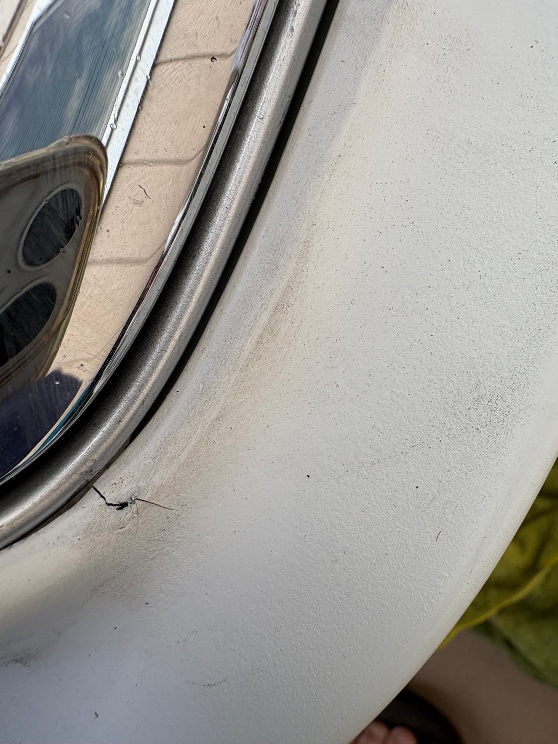

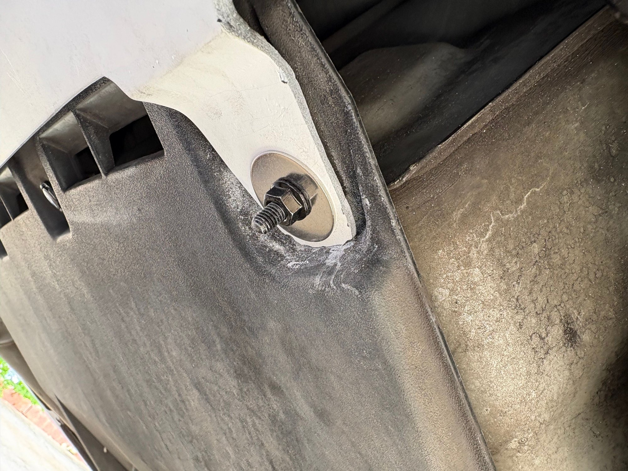

side fender well area started cracking, triple mounting screws. Center mounting points decided with bolts and nuts and screws and skips are too risky for me.
