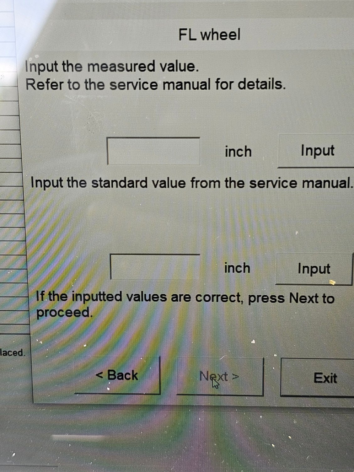

Hello ,I read old posts about air ride adjustment, but cant find an exact answers...how to adjust and lock the settings..
when using techstream,air suspension, active test,I am trying to adjust height,but as long as I switch to another wheel,previous wheel goes back to own settings...
There is offset height adjustment option,but I am scared to mess there...
Anyone knows how to do that properly?
Mechanical adjustments on the height sensors or the Data System controller, those are both exact answers but will not satisfy you I'm sure. The height offset is the 1 inch difference between height high and normal height, again exact answer and this will do nothing for you. You would have to have engineering level access to TS and have some serious coding skills to change the suspension system like that.
so that active test on air suspension,does nothing?
The height offset procedure you were in earlier might have made a small difference to the height high setting when you used it to raise the car but remember you’re dealing with an inch from the normal height it raises not lowers plus you don’t have the oem numbers to input. I don’t know how to explain it any further to you, might be a good idea to take pictures when you’re attempting to change things so you have something to go back to when they implode.
I didn't use that offset feature,as it overwrite ecm...
Though that other active test feature is helpful, as some guys posted their results...but on my experience, it goes back to factory settings...as soon as I release 1 wheel adjustment button, i hear compressor is running and car ir rising.someone posted this...
