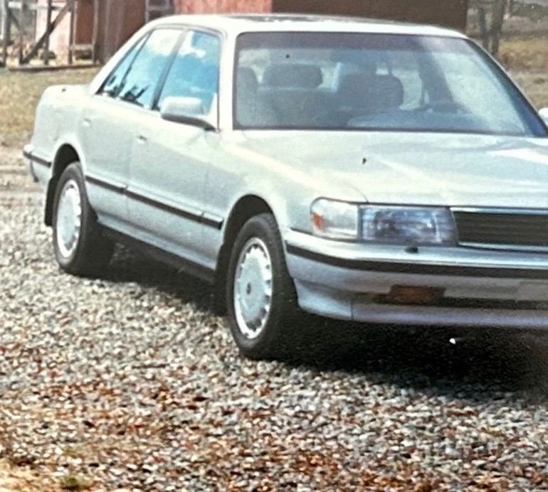

It’s a great car and I would like to preserve it because I don’t see a lot of modern alternatives that are good candidates to replace it when it wears out. Between the LS 400 and the Cressida I drove before that until it had high miles, I have found that the lifespan of rubber items always seems to be the limiting factor in how much time I can get out of them.
You definitely understand my car choices then!
