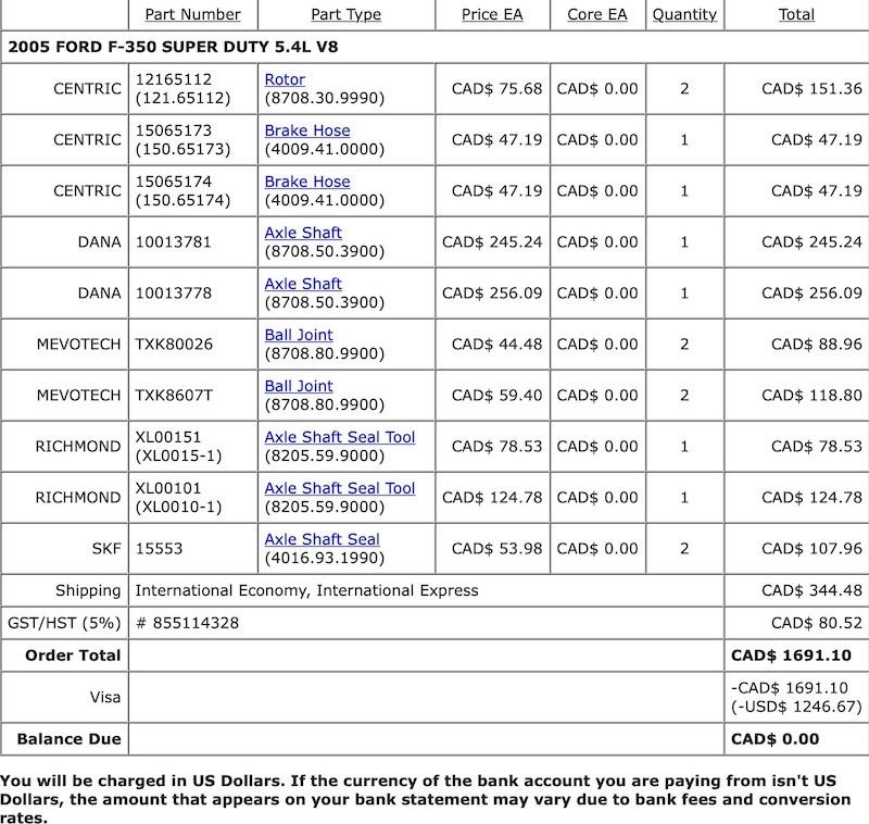

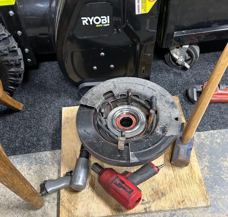

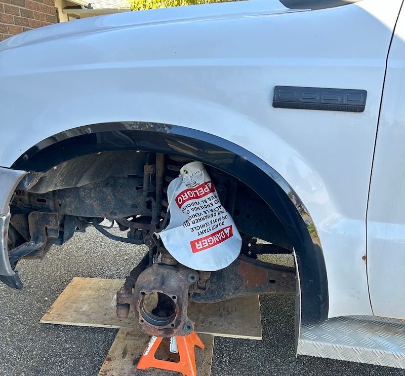

Any vehicle can get expensive to repair, my old reliable 4x4 f350's front end has been seizing up for awhile now causing almost emergency like situations when trying to come out of corners. Couldn't even beat the rotor off with a short sledge and had to take it off with the hub, it needs everything both sides of course and I will be going oem so it won't be cheap. it's real grunt work at this stage and I'd rather be working on the 460.

Originally Posted by Gerf
Any vehicle can get expensive to repair, my old reliable 4x4 f350's front end has been seizing up for awhile now causing almost emergency like situations when trying to come out of corners. Couldn't even beat the rotor off with a short sledge and had to take it off with the hub, it needs everything both sides of course and I will be going oem so it won't be cheap. it's real grunt work at this stage and I'd rather be working on the 460....
So Gerf where's the rest of them pitchers! I do wanna see how you finished this truck also what the damage (cost) was?
The parts are ordered but they won't be here till the 29th of this month. I decided to get them from rockauto because they were less than half the price from the dealers here even with the exchange and shipping. I just use the truck now for dump runs and picking up lumber etc so these parts will work fine.
Old Sep 11, 2024 | 07:20 PM
Posts: 17,913
Likes: 1,702
Those all look like good parts too, Dana stuff is def you treating the truck nice!
