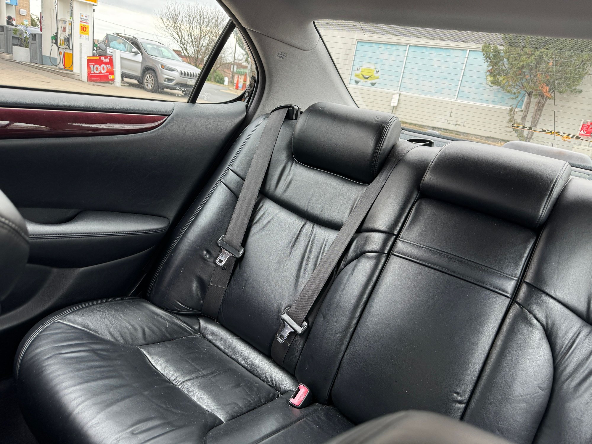

The coating does not have “tiny holes”. It’s a urethane top coat that is sprayed on like paint. Semi aniline or top dyed the coating is the same. The only difference is how the leather is dyed underneath the coating.
The leather won’t dry out if it’s properly cleaned and maintained. Preserve the coating and it will last forever.
This is my 2003 Lexus ES, 225,000 miles. The leather has never been conditioned. It’s been cleaned and maintained as per the manual, it’s sat outside for the last 14 years and hasn’t had any care of the leather at all in that time. These pictures are from last month, that leather is 21 years old.

So grab some nail polish and put it on. Let it dry and it'll just peel off right? B/c it can't get through your protective layer? Or a silver permanent marker. It'll totally come off.
Semi aniline leather is only partially sealed. It has a protective coat on top and none on the bottom. The protective layer on top is porous. If it was completely sealed it would be like sitting on rubber. Which of course it isn't. It breathes.

No, it will stain the coating. The urethane coating is not magic.
Semi aniline leather is not partially sealed. It has the same urethane spray top coat as all coated automotive leather. No leather is coated underneath, it’s a top coat, and there is no way to get to the backside of the leather without removing the leather from the seats.
Not going to keep arguing with you, continue to do what you want. To everybody else the coated leather does not benefit from old school
oily, greasy conditioners. Use a modern UV protectant that will preserve the urethane coating and your leather will stay as new forever
