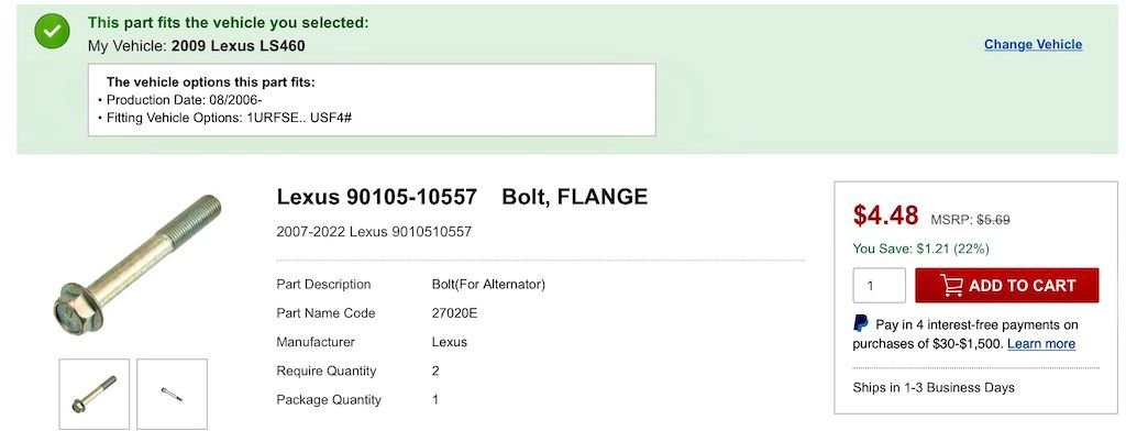

Update-Alternator arrived, installed today. What a PIA! Took for a 20 min drive while monitoring voltage on a graphed scanner. Stayed consistent at 13.5-13.8. Had high of 14.1 and low of 13.4 in that drive. Nothing funky happened, but time will tell. FYI, the alternator on an AWD car only has 3 attachment bolts. There is a large crossmember under the alternator so all work has to be done from above as opposed to a non AWD version.
Awd models have 4 mounting bolts, if you only have 3 then your alt has been changed before and whoever did it was just to lazy to install the lower rear bolt. Probably the dealer.
