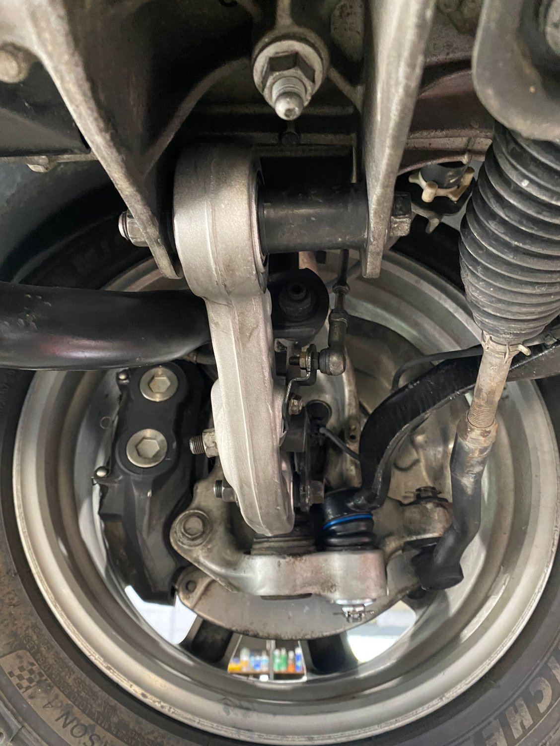

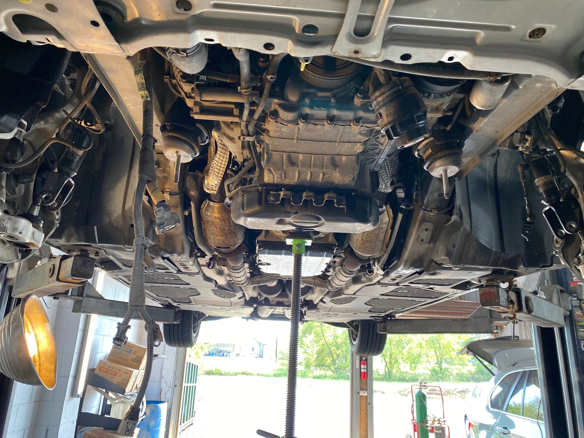

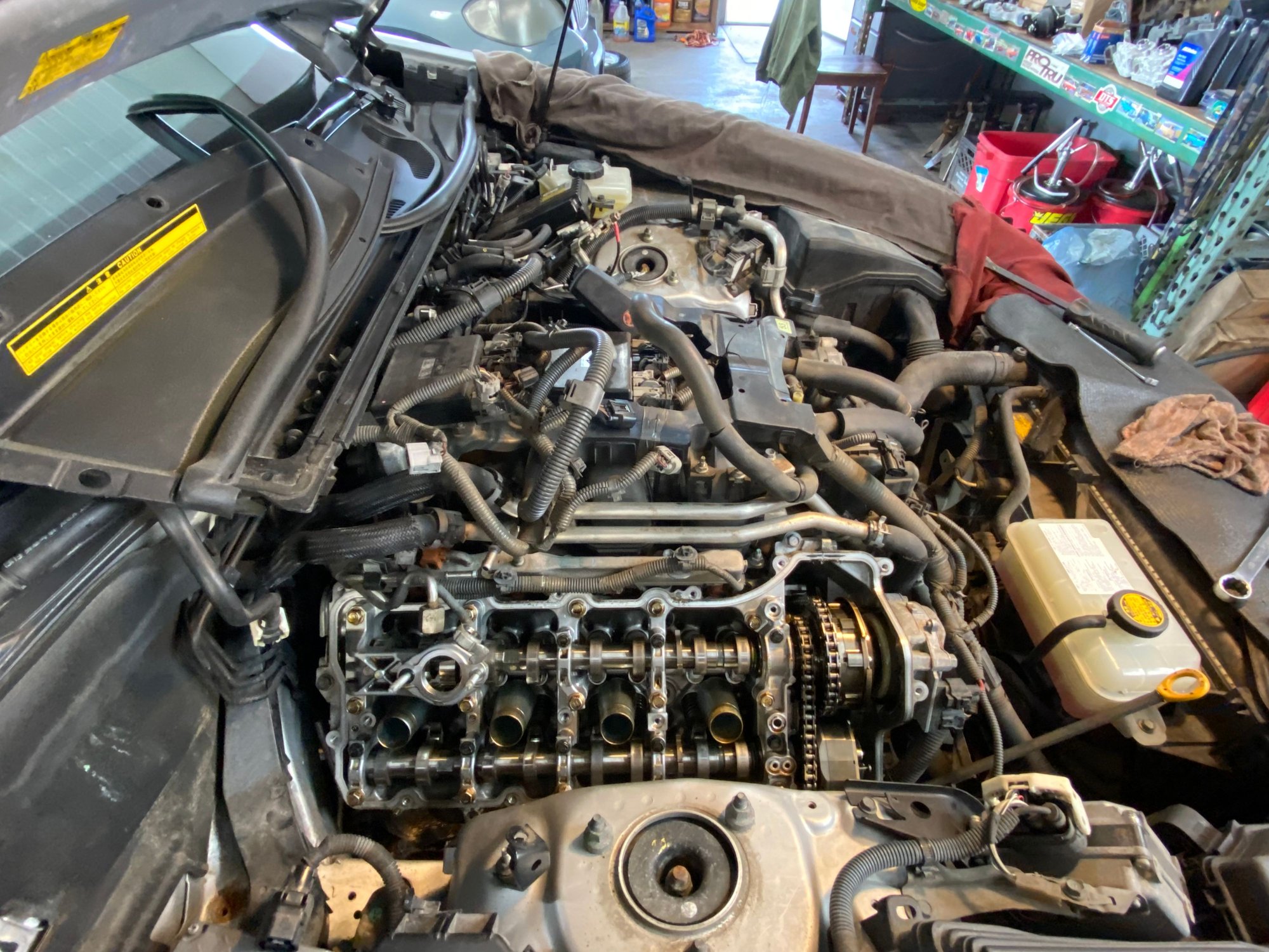

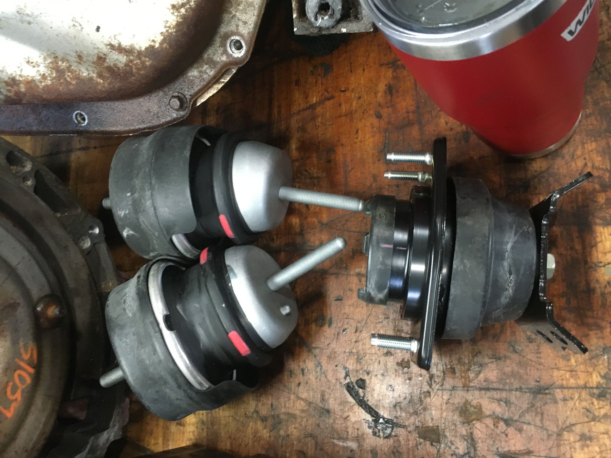

Oh I replaced all my front suspension and all driveline mounts the week after I bought the car so that's all done on mine already.
Also replaced the rad and checked chains
OE
Aftermarket
Its been 20k of uneventful usage now as my wife's daily driver, I stopped driving it and it sat for 3 months when I bought the W12 so I figured someone might as well use it.
It's been the 2nd worst car I've owned in terms of what it needed and overall costs. The LS430 was the worst by far but both are exceptional cars overall and totally worth the annoyance.
I remember all the work you did on that car, I'm not that dedicated haha. It would be nice if they made a tacoma with a 5.7
