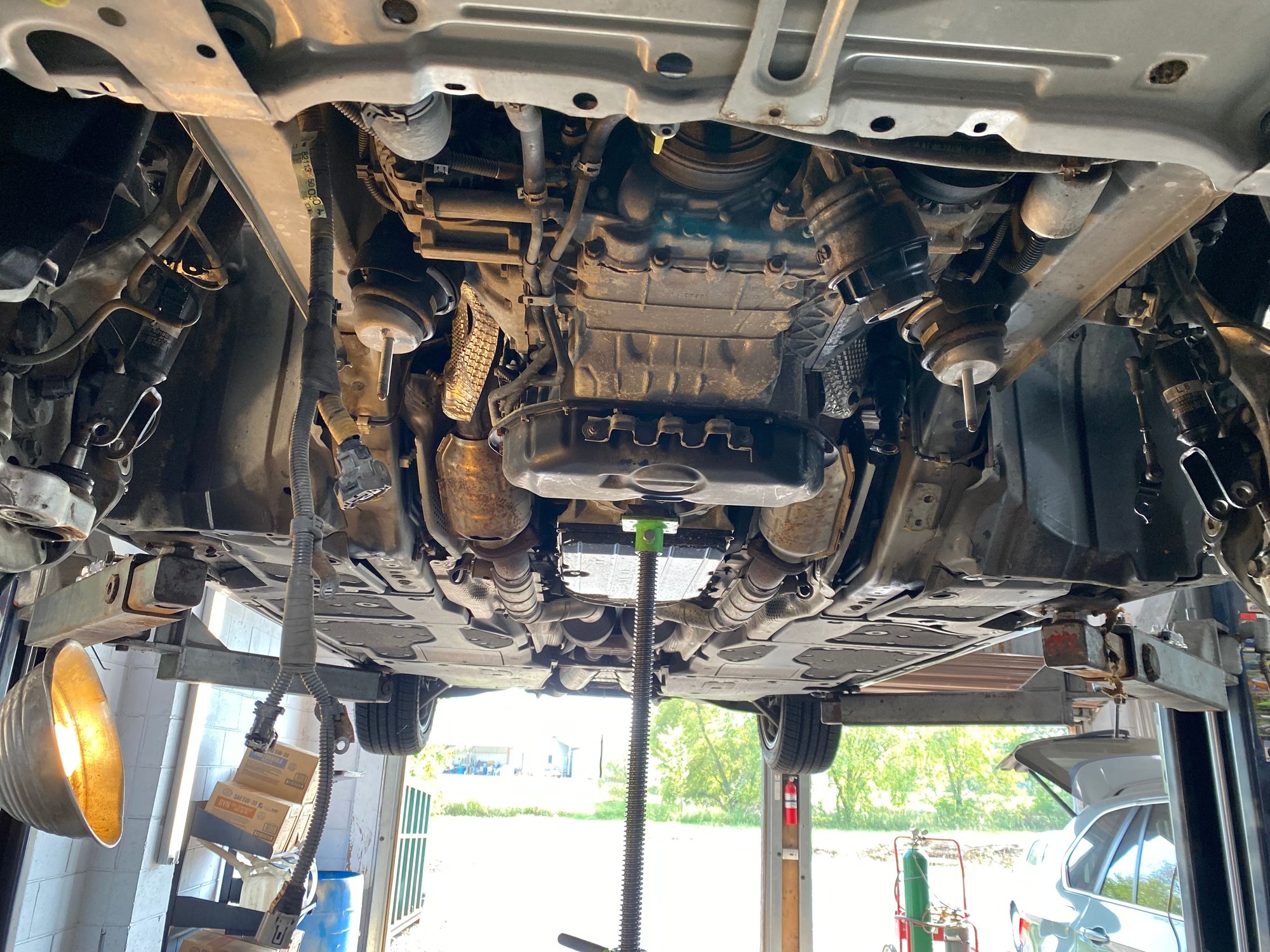

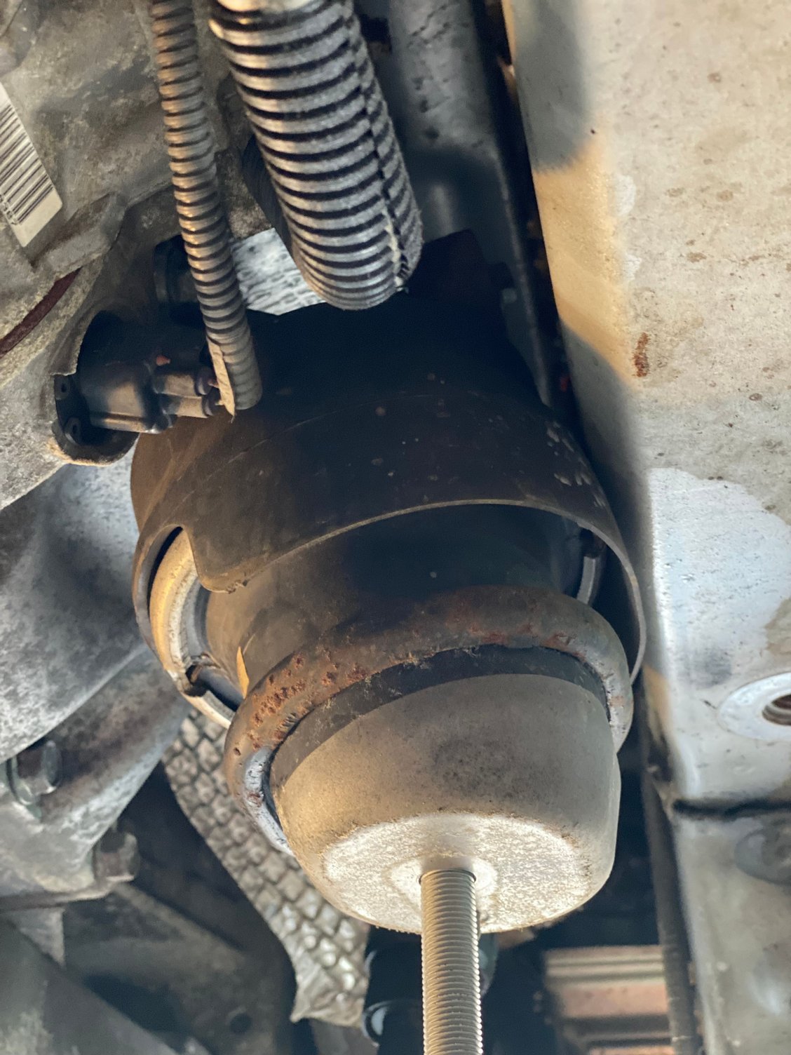

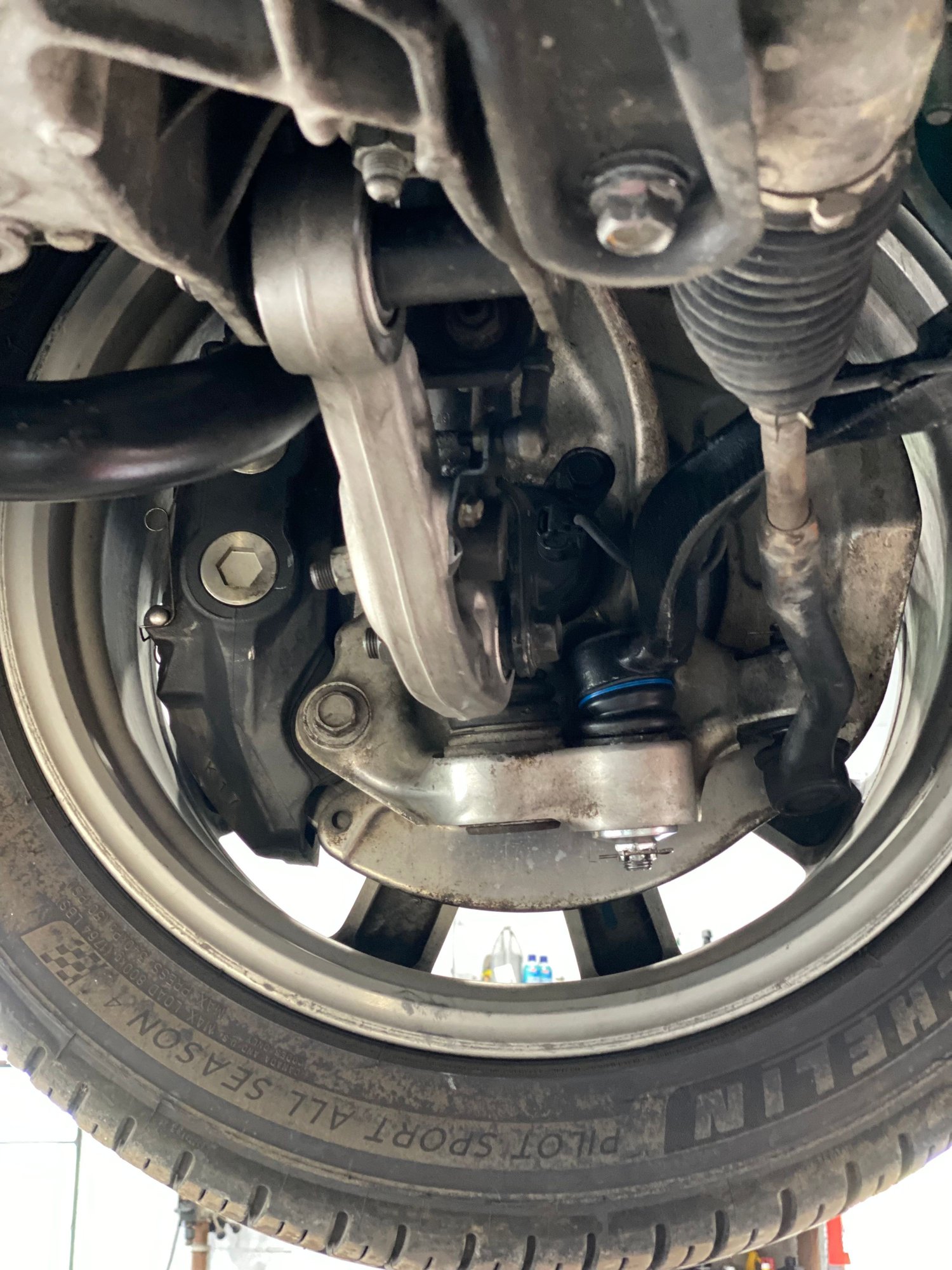

Old Apr 27, 2023 | 03:27 PM
Posts: 18,423
Likes: 1,806
You do not need to remove engine at all, just pull the subframe off.
You can also take this time to replace all front arms, my mounts were okay but the side that gets pulled up on heavy acceleration was torn.
