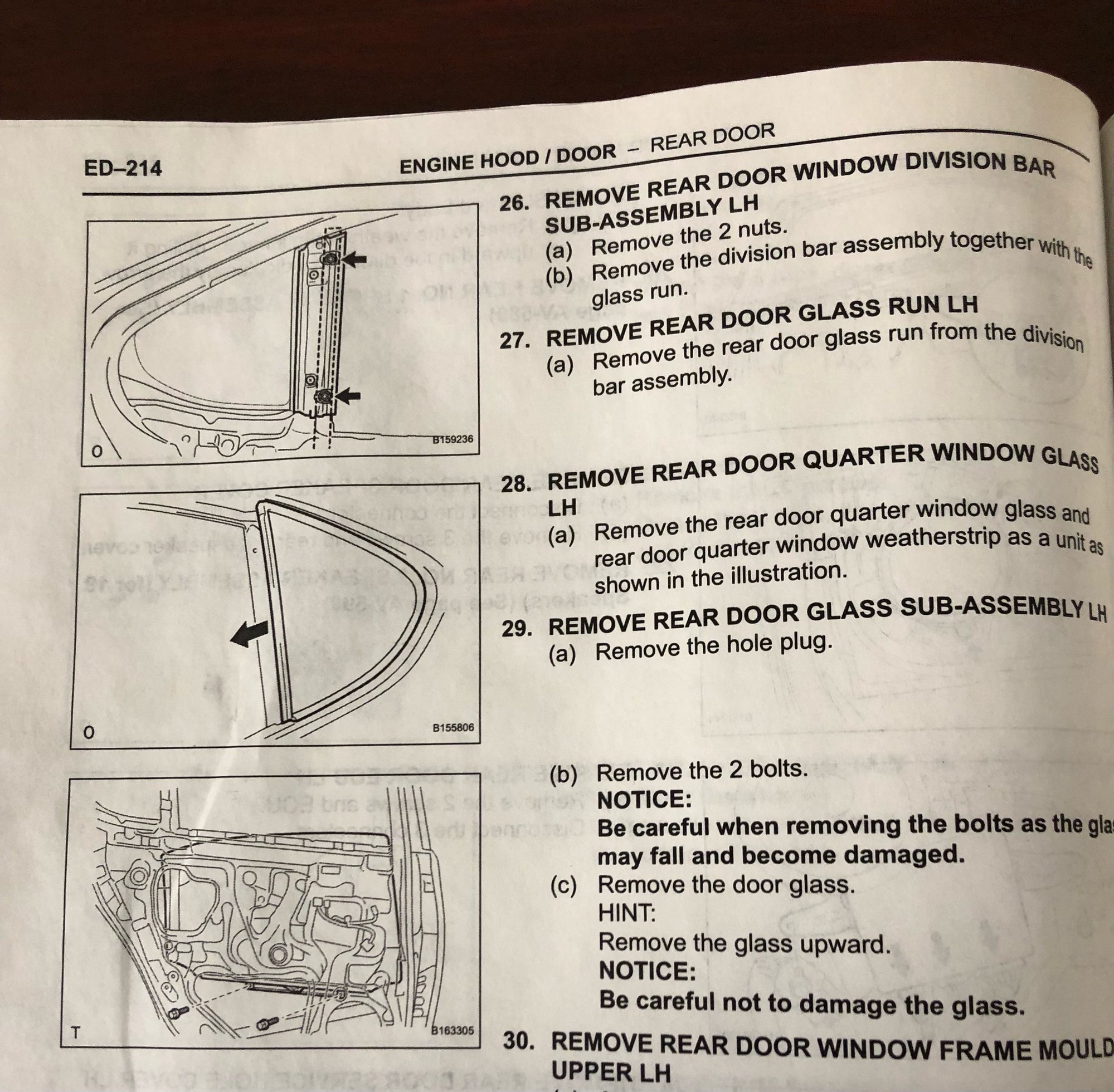

Has anyone replaced rear window? I can't seem to remove the "rear window division bar". I have followed all the steps in the manual and it still not coming out.
Thanks

Took it to a local autobody shop had them do it....
