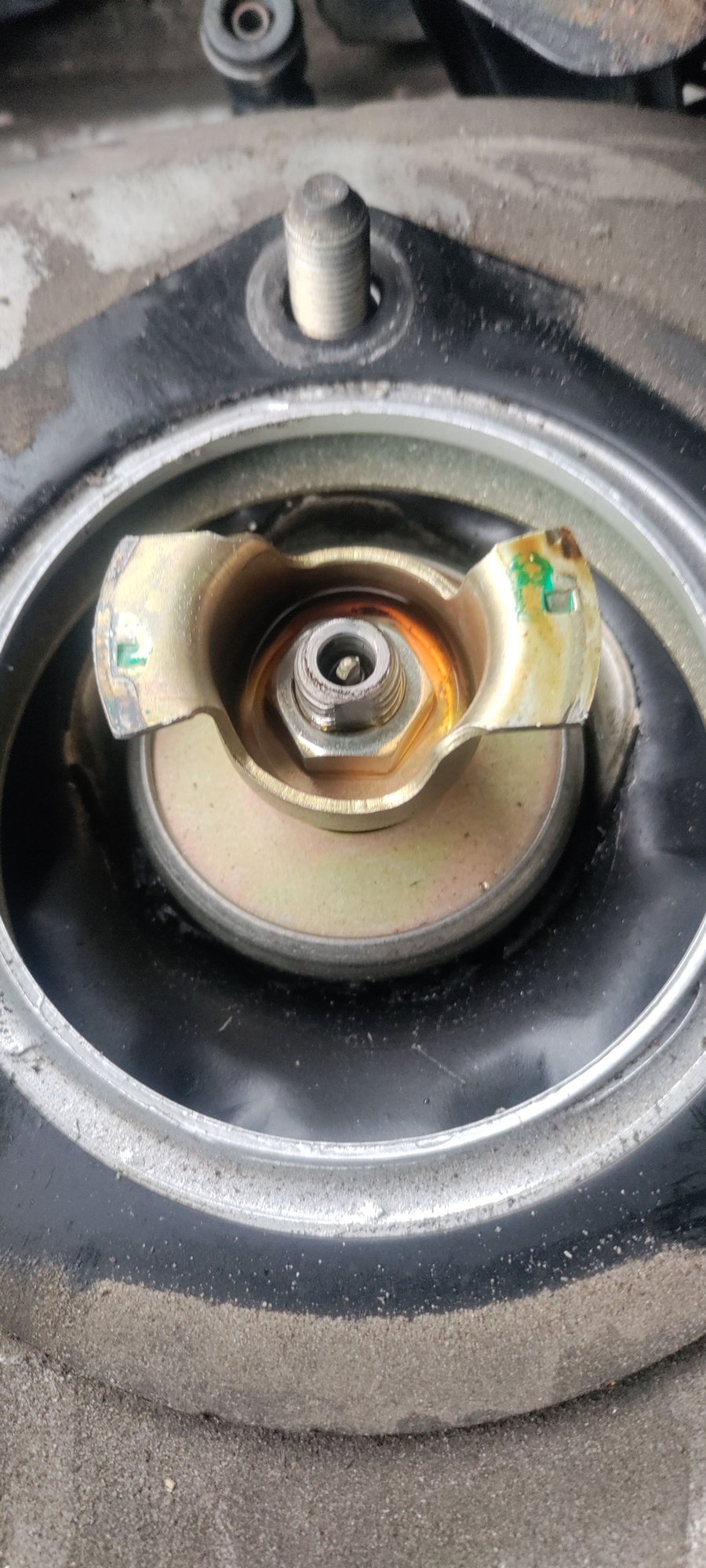

Can you post photos of the struts?

On top of this goes electric motor which turns the ****

I assume that there must be a description in the service manual somewhere that explains how to install the servo.
I don't know myself as my air suspension has (so far) behaved itself.
