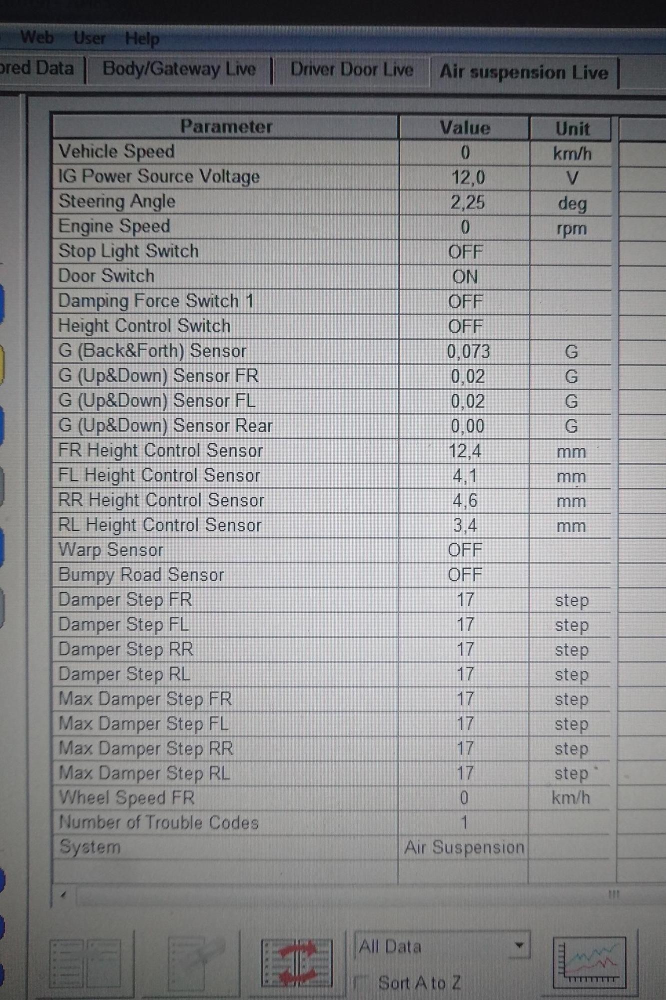

Question LS430 air suspension - Techstream
When I connect Techstream and look at live data for the Air Suspension module, I am particularly curious about the Max Damper Step values. They appear to be fixed at 17, with the struts being at their firmest (17) when the car is stationary or slow moving - and only beginning to "loosen" off once there's a bit of speed. That means the ride is *deliberately* firm at slow speed... whereas I'd love to feel a cossetting boaty feel at slow speed.
I can manually set a single damper to any value, even 1 (floaty), for testing, but I'm not sure there's a way to encourage softer damping overall.
A favour to ask anyone with Techstream and an air-equipped LS430... with your suspension switch in "normal/sport", is there any difference to the Max Damper Step setting on your car? Is it always 17? If so, why is it even mentioned in live data? If there's a way of configuring it to a lower maximum, then I feel the car would avoid the "stiff knees" feeling at low speed and make life a little softer around car parks, etc.
