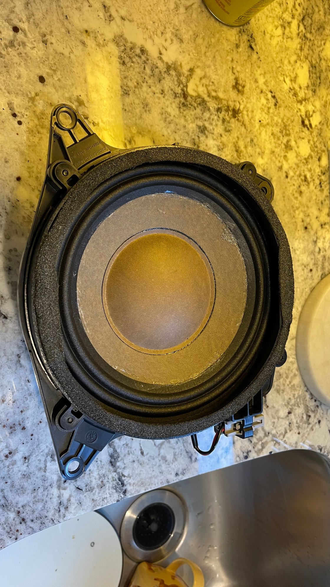

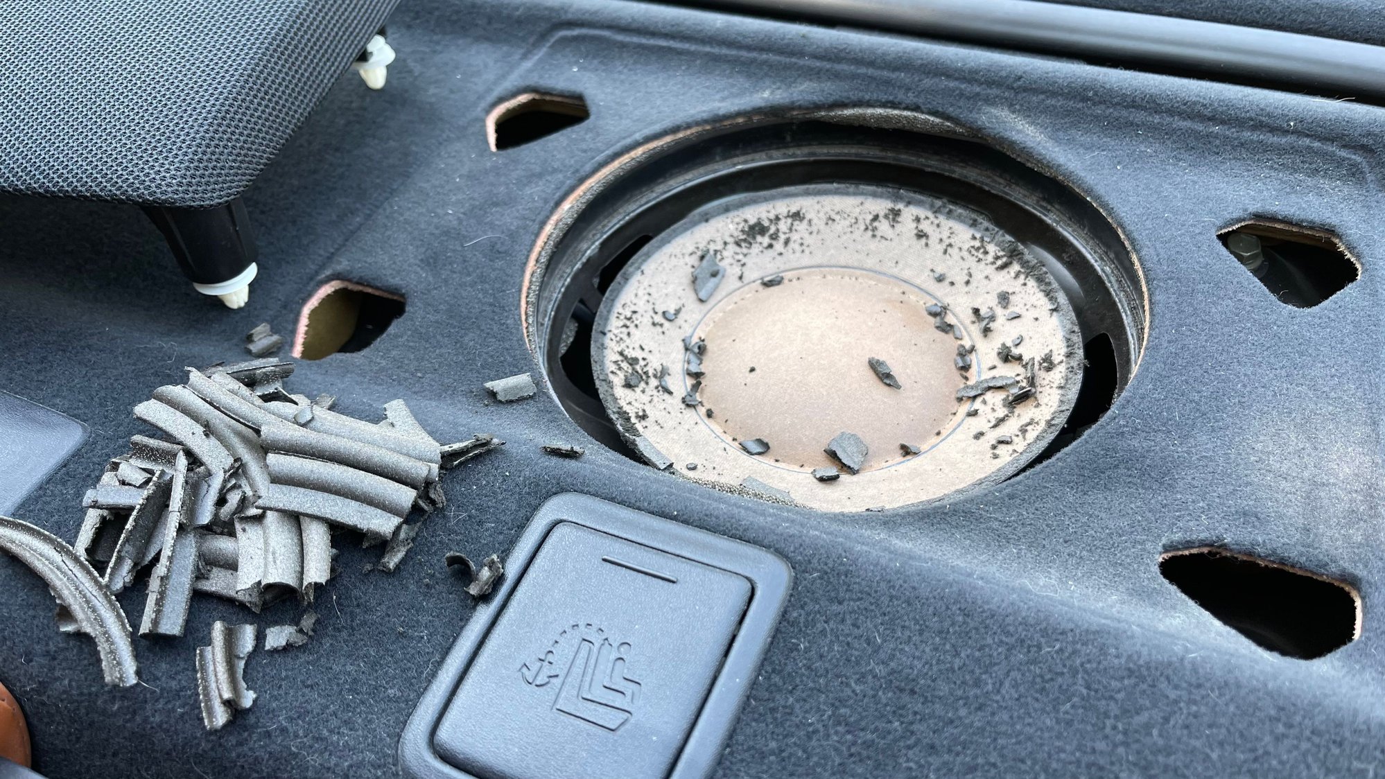

They just pop out on the front. Give them a good tug. The back requires that you push in and up. There is a hook and latch type thing going on.
Outer ring was so dried. I just rubbed it off with my finger and vacuumed it.
The kit from Simply Sound.
Here is the new ring.
All glued up and ready to dry.
My ‘04 Lexus LS430 came with a busted subwoofer. I was determined to find a solution. After searching around I finally came upon the repair kit from Simply Speakers. The kit arrived and I got to work. I found another post in there that was excellent for removing the back seat. It took me some time to remove the seat being that it was my first time, but it’s not that difficult. I got the speaker out fairly easy. Gluing proved to be more difficult that I anticipated. I wound up making a mess on the paper cone. But overall, it was good enough. I let the glue dry and installed everything back. Turned it on, not working at all. I messed around with several things like the amp and wiring harness. No luck. Left it alone and came out the next day to find that it worked! It was short lived. Stopped working again. A few days later, it was back and there to stay. The bass seems like it is pretty weak, but the sub is definitely moving. I am happy with the work and the kit from Simply Sound is great. It was also a great opportunity to clean.
