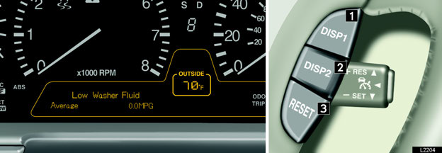

No outside temp display where I am pointing. How do I turn it back on? 2006 ML.
I used to see the outside temperature displayed just below and between my speedometer and tachometer. It was kinda cool.
I recently noticed that I do not see it anymore.
Apparently it can be turned on and off, and I must have accidentally turned it off.
So, any insight on how to turn it back on?

Press and hold the "DSP2" button on the steering wheel. It will toggle between temp, compass, and off.

The multi-information display provides information including your vehicle’s driving condition, outside temperature, and warning messages.

Though if you have the Navigation package, it will only show outside temperature when on and won't have a compass function.
