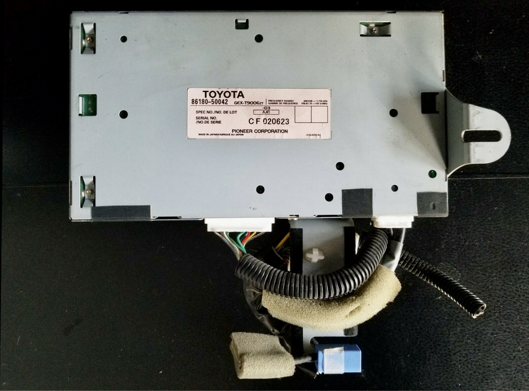

Yesterday the indy installed first the radio (still no working climate control) and then the gateway.
Same result.
However, when they unplugged the nasty looking amp (their description...and they wondered if the trunk had gotten wet) the climate control worked!
They had me purchase this one since they said they need the wires on it as well: amp part# 86180-50042...

Well, with the used amp installed the climate control, radio and nav now work.
