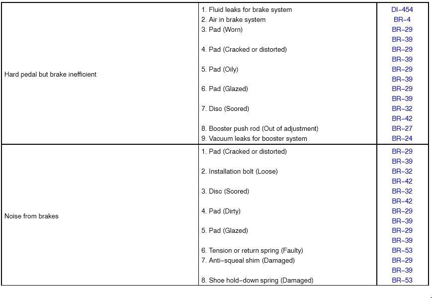

Here is the Lexus approved troubleshooting guidelines for the brake system (suspected areas in order of diagnostics):
