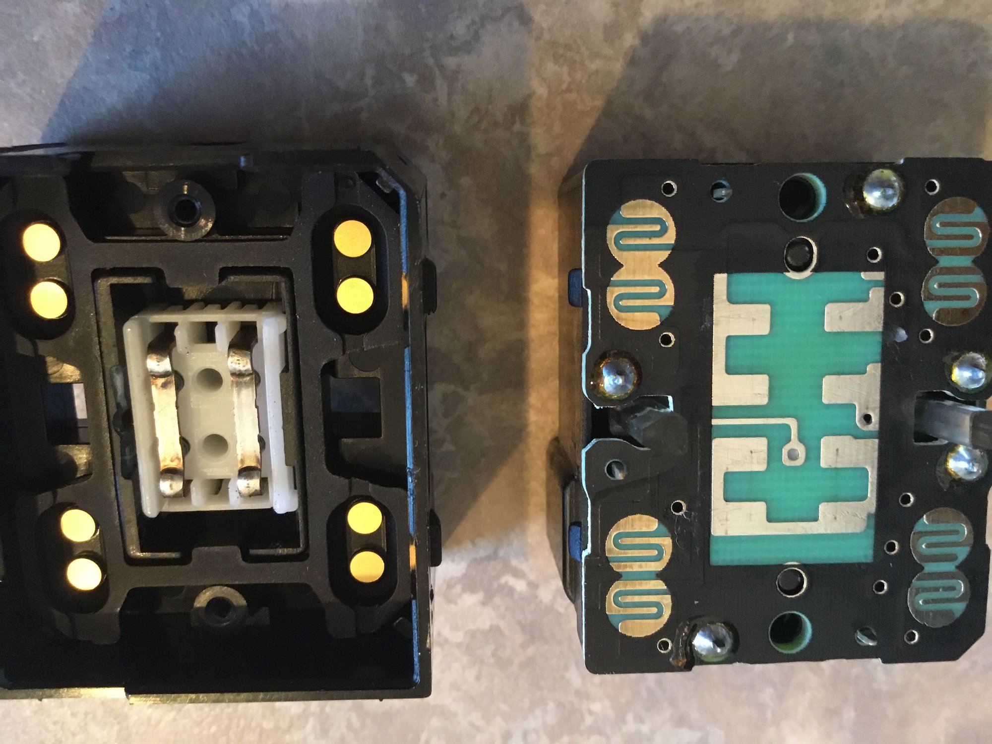

This is a common issue that's not difficult to fix but it is a fairly intricate process.
The contacts in the switch build up carbon over time. There is also dialectric grease (not really a "grease" in the conventional sense but that's what it's called) on the small circuit board that dries out. Fresh dialectric grease helps current flow through the switch.
This thread is very helpful-https://www.clublexus.com/forums/ls-...-adjust-2.html
Top pic- shows what's left of the dried out dialectric grease
Second pic- dirty contacts in the center of the switch. I used a small eraser to clean these.
Third pic- shows both after delicate cleaning. Circuit board still needs a thin coating of dielectric grease.
