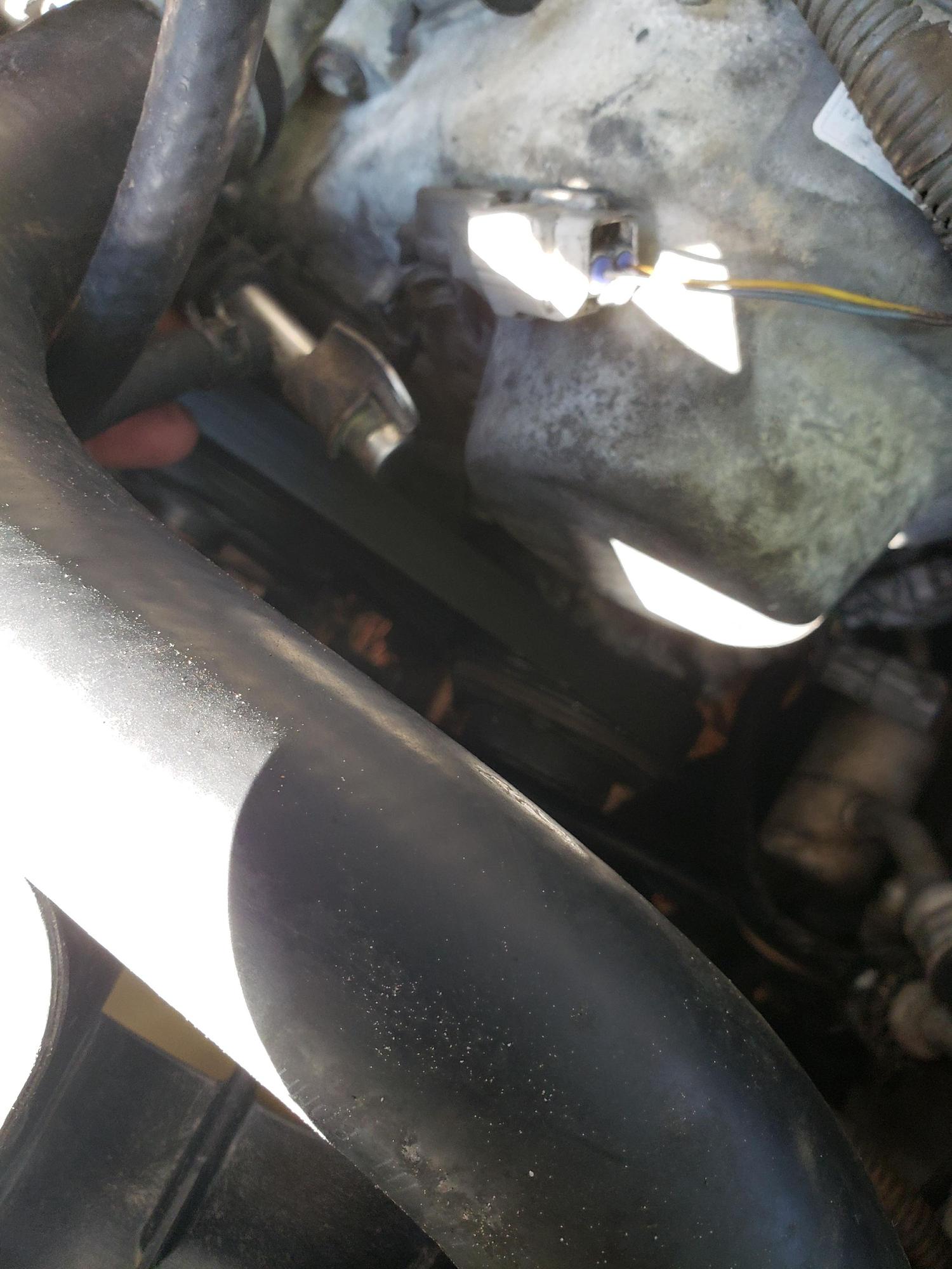

Ok everyone my father in law and I tried to do it. Didn't work for us so we found someone who could but my father in law and I can figure out where two lines go any help the guy that did wasn't there when we took them off and now it's at my father in laws house and I'm not there to look at it

Couple more pictures

Ok so update I found where the vacuum lines went . car is running better but now there is a ticking noise coming from what sounds like the right side of the motor. car runs great doesn't run hot good power my nephew said it sounds like a sensor he said maybe MAF which I saw when I was looking that the to plastic of the sensor is cracked like someone pushed on it. Was wondering if anyone knows if the MAF would make the motor or something have a tick.

Ticking noise really would not have anything to do with the MAF sensor. It's mounted in the air filter housing on the right side of the engine bay. It could be a fuel injector making noise, or it could be part of the valve train making some noise. When was the last oil change and what grade of oil was used?
Get a wooden dowel about 2 feet long and hold one end up to your ear, and put the other end on various parts of the engine while it's running. Eventually you'll find what's ticking.
Those hoses in your previous posts looked like they were installed on the throttle body. Is that were they ended up going back on?
