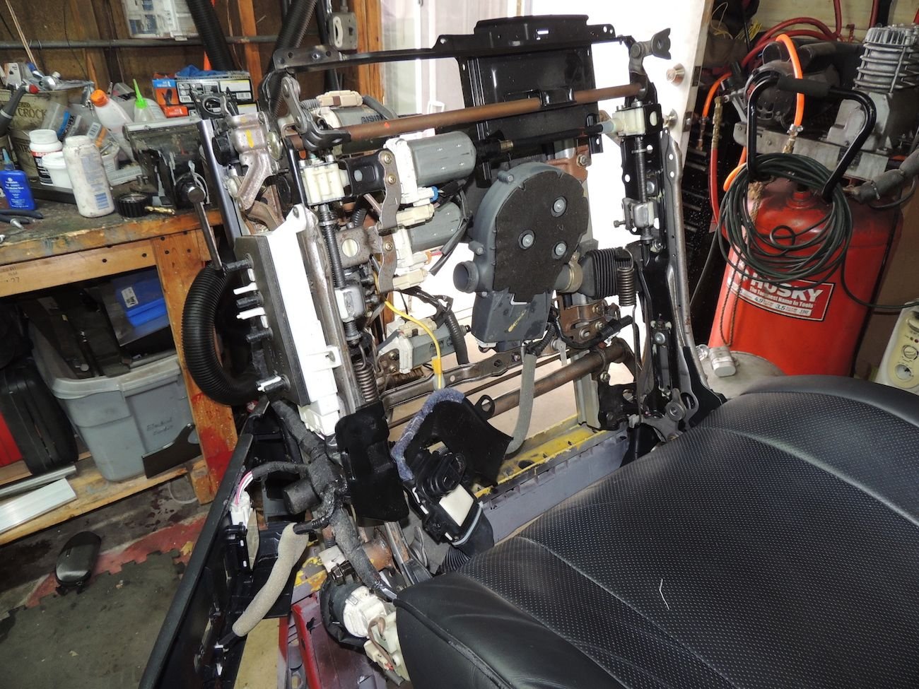

Originally Posted by mhussien32
Thank you so much! my seat cushion is fine, but I'm having an issue in my climate seats fan this will help me a lot to replace it myself.
But this will be my first time.. so please bear with me .. the seat fan motor is that black plastic part located under the air filter.. right? also.. can I reach its screws after removing the seat?
Thanks again..
Here are some pictures to help you out. I didn't remove the fan but it looks like it comes out the bottom.
Fan with vent to bottom cushion removed
View from bottom. Fan is near the bottom of the picture.

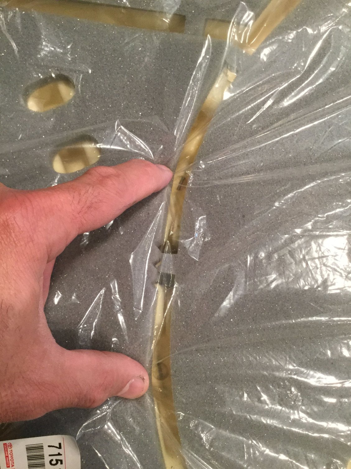

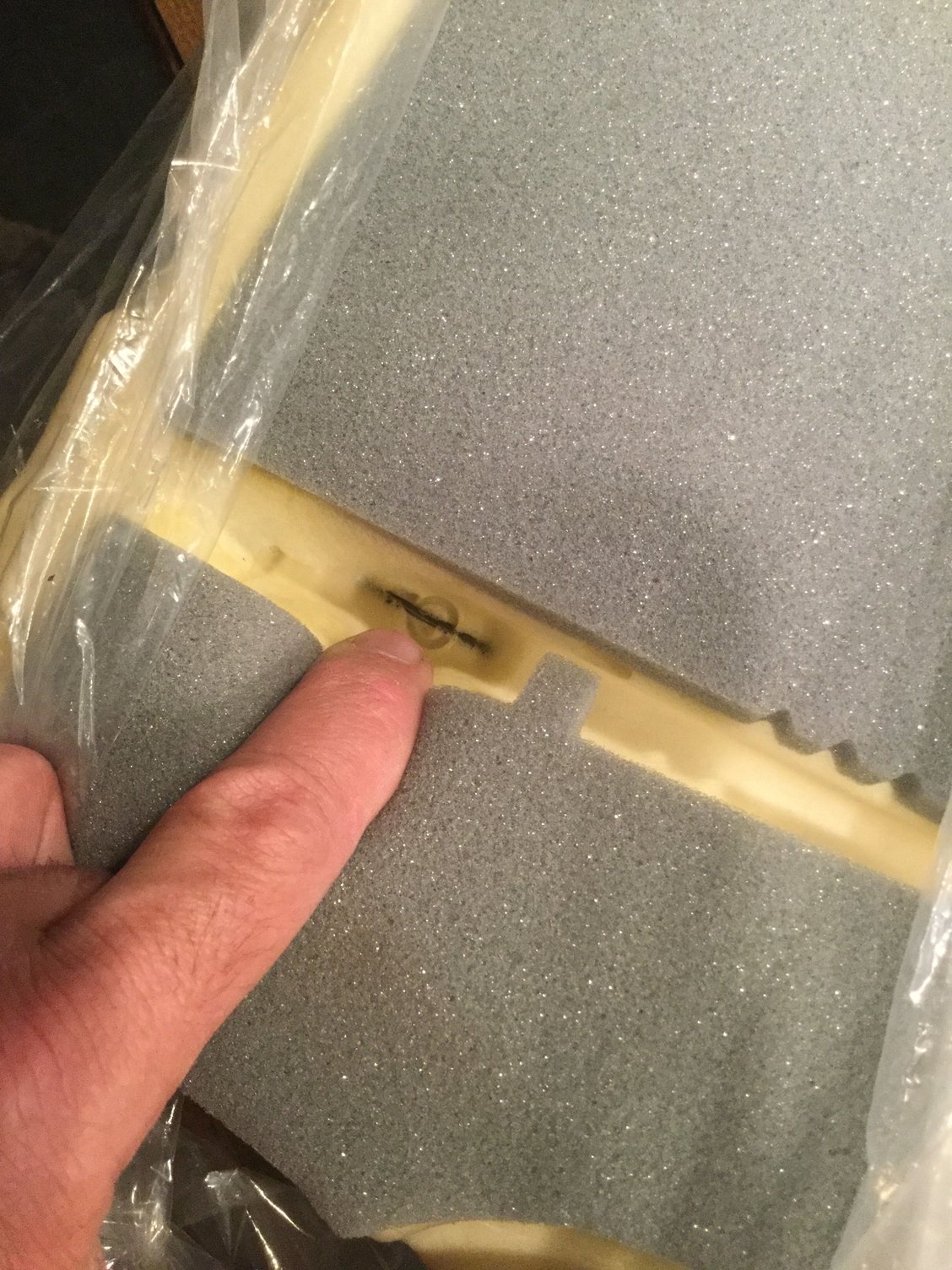

I got my new cushion in, but I can't seem to find the metal bar that I think is supposed to be embedded in the cushion. Did I misunderstand something?
Old Apr 6, 2018 | 05:49 PM
Vmost66's Avatar
Vmost66
Joined: Mar 2018
Posts: 21
I received my seat seat cover today as well. The wire is embedded it just hidden a bit.
