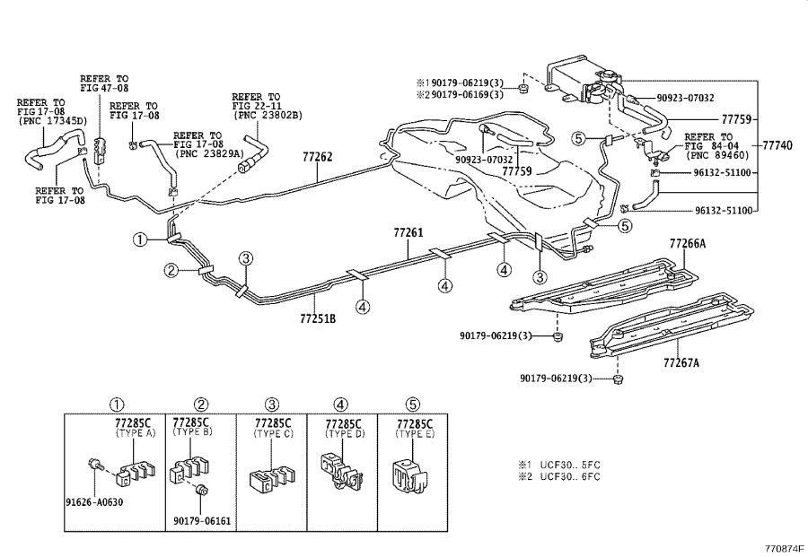

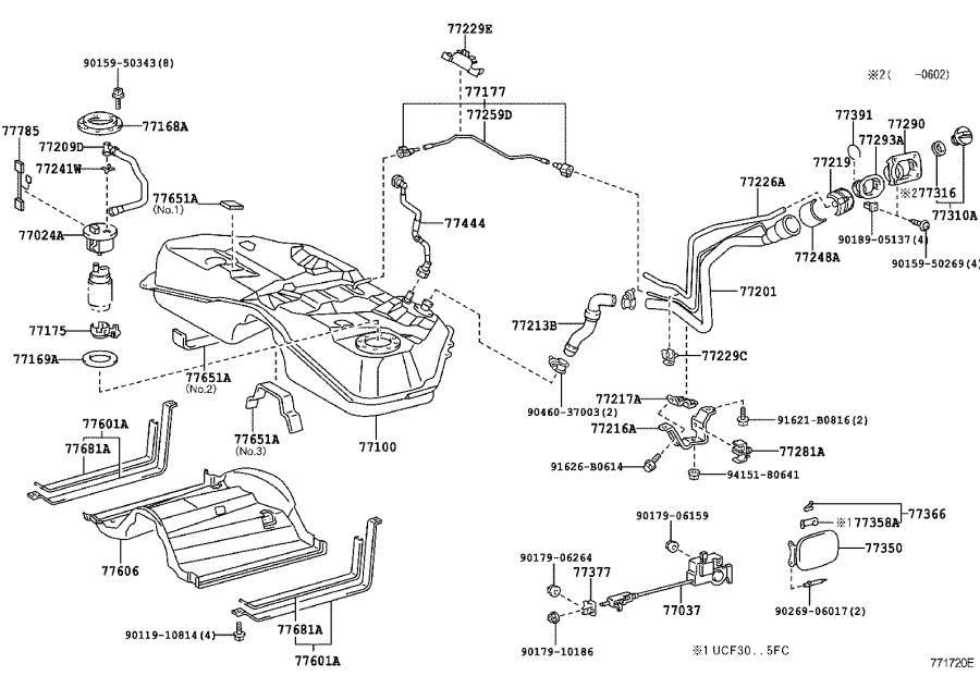

Default Check fuel tank area hoses, clamps, gaskets and seals

My vapor smell is from the outside near the rear after shutting car off. I also get the PO440 code for years now. Attempting a fix can be frustrating as well as costly. After various smoke tests, replacing all vacuum lines plus more I gave up. Since the performance of my car has not been affected I'm ok with it. If I lived in California it would be another story. . FYI.....The LS430 is known for vehicle emission CEL issues.

is your vehicle garaged?
Probably the issue will not improve with time.
It wouldn't be wrong to replace certain tank seals and hoses...
