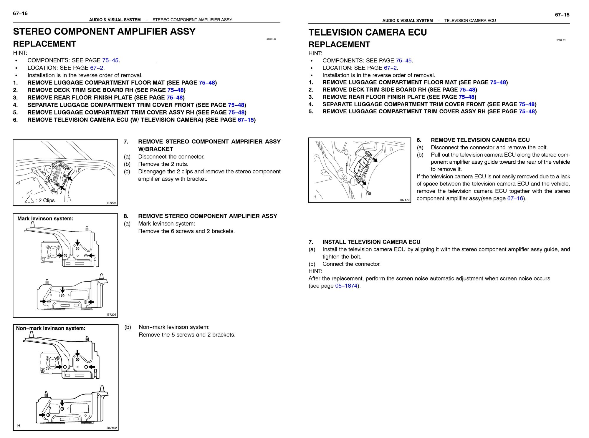

Ok...so I followed a YouTube video to remove my amp....it was enough to get the job done but my set up was diff then the video. Mine had the parking sensor computer attached to the amp.....and it did NOT just pop right out after removing 2 nuts.........for others in the future...note there are two nuts and two white grommets that snap in the frame. After somehow getting the amp and the parking computer out I noticed there is some kind of quick release mechanism that would have made the removal so much easier. It looks like u remove one bolt and one of the units will slide free.......anyone out there....that confirm how this works???? Mine is a 2004 LS430

Here's what the repair manual says about your first question...

Thanks RKW.........ya that manual isnt very clear and doesnt mention quick release .......I will post a pic later that shows the quick release. I will figure out how it works during reinstall.

woooops.......yes I see that the camera computer assembly is in fact on a quick release in the manual that u sent........this makes sense.....easily remove this piece then u have room to remove the amp....
I did it the hard way
Thanks
