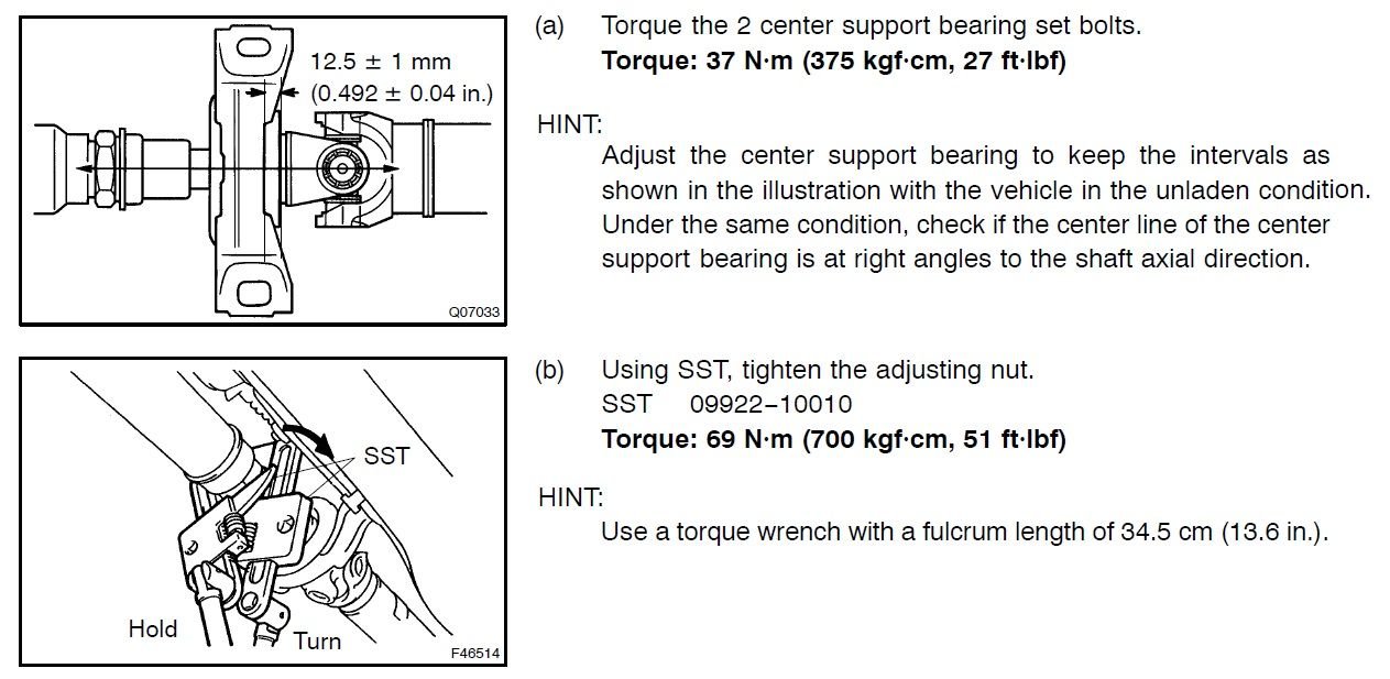

ancdmd, glad you finally solved your mystery-noise problem. I found some torque specs for the adjusting nut, but not sure how you would do the torqueing without the SST shown.

I certainly didn't have the SST. The nut was definitely at less than 51 ft lb. I wasn't able to use any kind of a torque wrench on it so I just tightened it best I could knowing that it should be around 50 ft lb. I didn't put a pipe extension on the wrench handle or anything so I don't think it could get much tighter than 60 lb ft at best, given that I could barely turn the nut before I had to reposition the wrench due to the obstruction of the exhaust. Funny in the diagram that they use two SST's; I just put the car in park and let the engine/trans keep the driveshaft from moving

i just wanted to come on here and thank the original owner of this thread. i was having similar noises coming from what i though was right under me and sounded exactly like the youtube video so i hopped under my car today and popped off the heat shield and support beam and got a large adjusting wrench around the driveshaft adjusting nut and made micro adjustments tightening it until i was satisfied and took my car for a ride and the noise is completely gone. i’m so glad i didn’t take this to a mechanic because this is definitely something a mechanic might easily overlook. either way, it worked and unsure if the noise will come back but if anyone is wondering, it 100% got rid of my noise.
