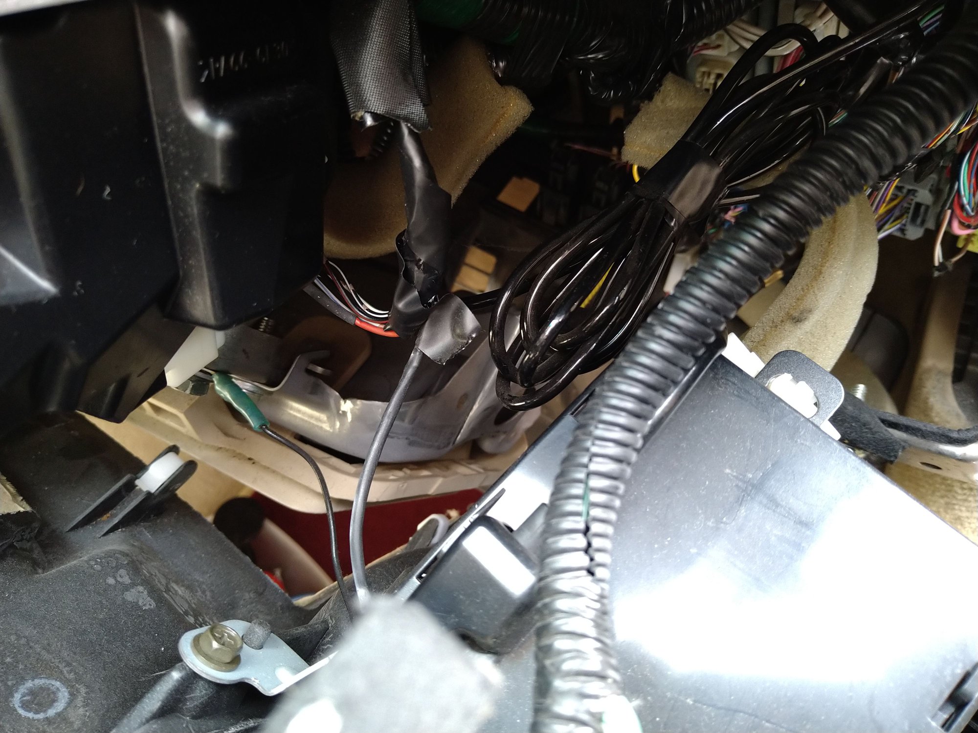

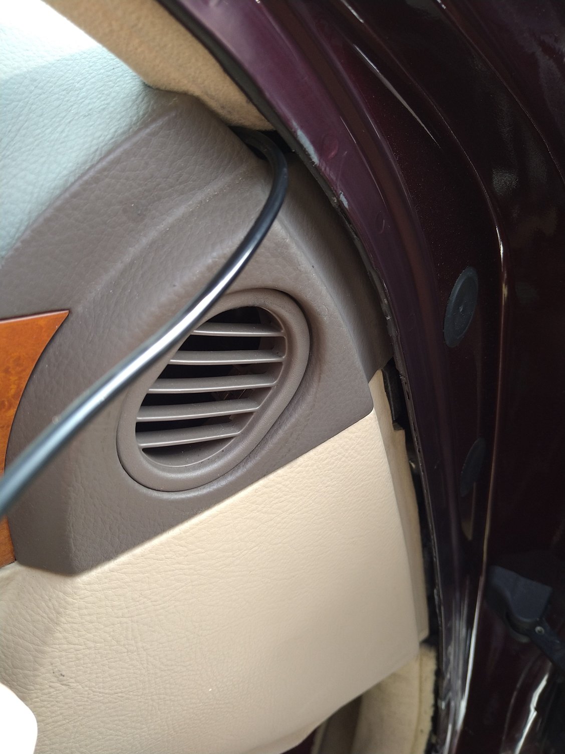

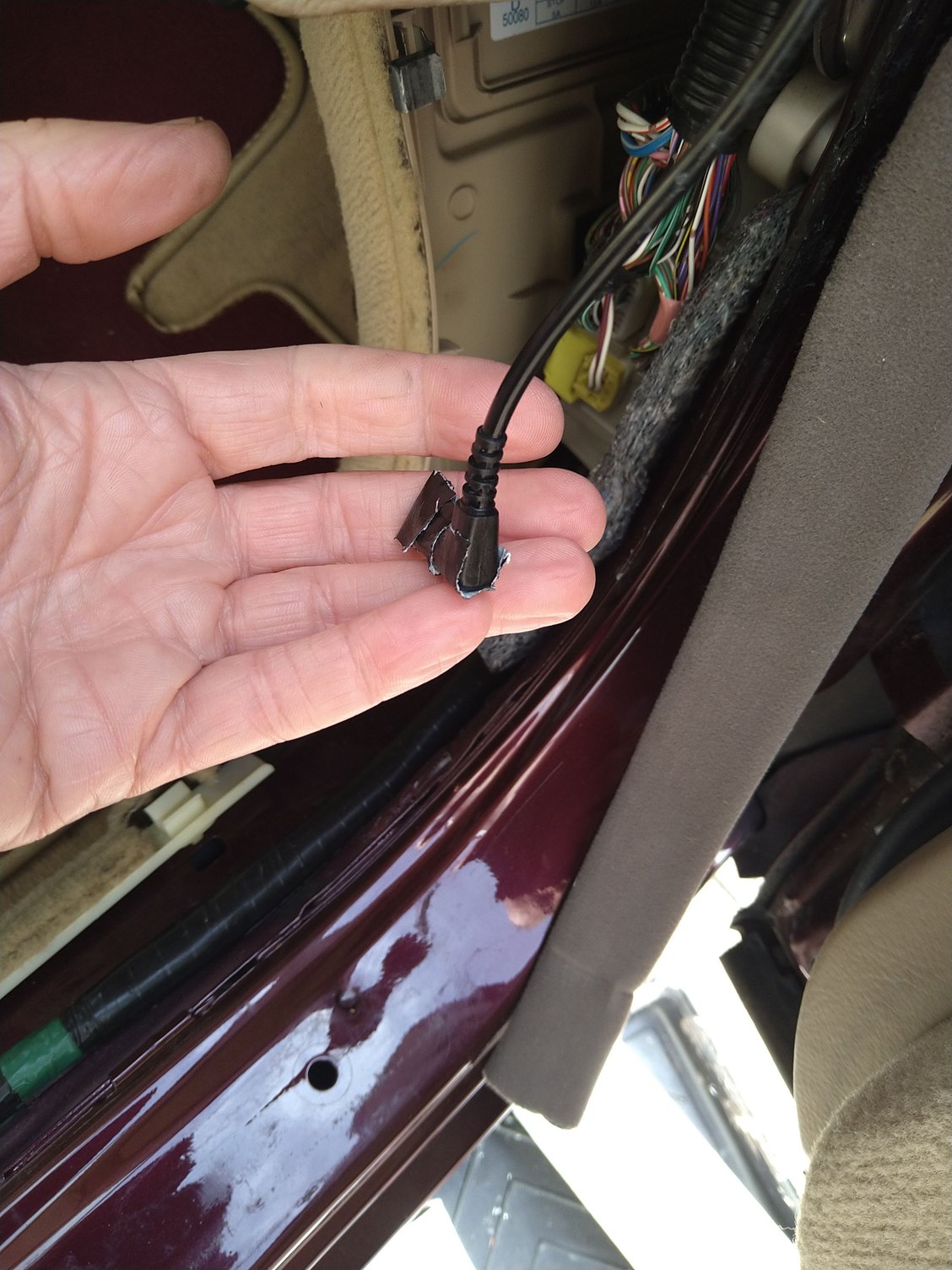

So, this is what passes for auto electrical work in the UK. And I'd been driving around for the past 3 years with this abomination behind the dash, blissfully unaware.
Only by chance, the other week, I discovered a 'consumer' cable with DC jack, hanging loose (albeit with the end taped up) hidden behind the driver's kick-panel, in front of the fusebox. Knowing that I wouldn't be able to sleep properly until I'd rooted it out, I thought I'd better tackle it today. So, having waded through the manual, I eventually found that the cover I needed to take off is called 'Instrument Panel Safety Pad Sub-assy No.1'. (Who knew, eh?)
What you see in the photos is what I was met with. Basically, what appears to be a redundant dashcam feed hacked into one of the looms and bound up with black PVC tape, along with a piece of wire spliced in. (Don't ask.) So now, I have to go to the trouble of finding a scrap vehicle from which I can obtain the plug and a few inches of loom, and re-make it properly so as to replace that which has been destroyed.
In this country there are no consequences for people that do this kind of stuff. Ignorant, arrogant yobs with no pride and no shame.
