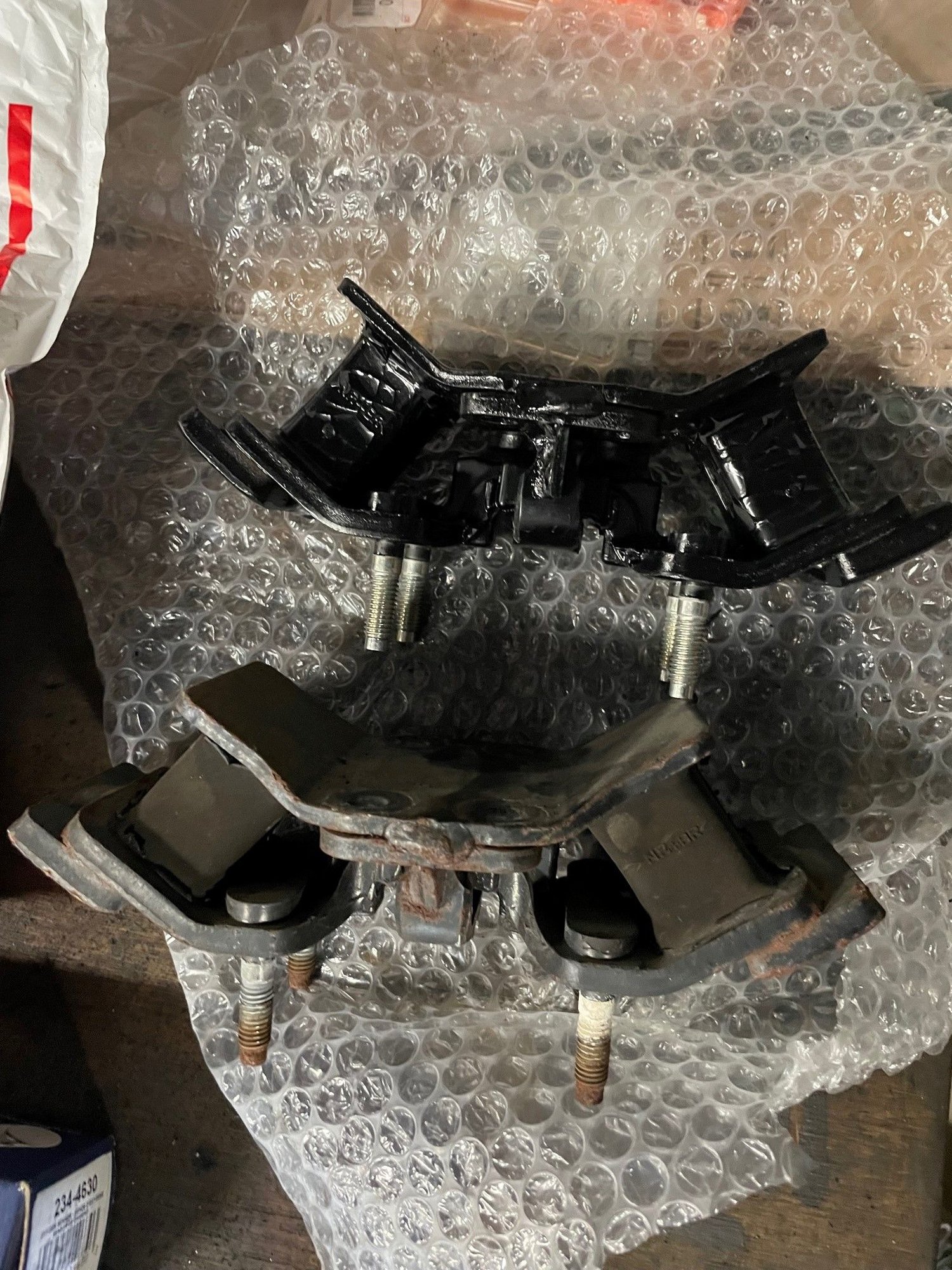

After completing 5 or 6 trans fluid drain/fills over the past couple of years, I ended up getting sloppy and stripping the drain plug on the last one, so decided to (had to) replace the pan and did the filter while I was it. Pan bolts (20 on 04-06, 19 on 01-03, I believe) came out fairly easily, except for a couple of the frontmost bolts that don't have much room for access due to the exhaust mounting bracket. Recommend having a thin 1/4in wobble extension handy for those. Magnets definitely had accumulated some shavings as visible in the picture, but it doesn't appear to be an excessive amount? Replaced the pan with new bolts.
I checked the temperature with an Autel scanner. If you don't have access to a scanner that reads ATF temp or Techstream, I recommend shorting the OBD ports as shown in the FSM. Don't use an infrared gun, by the time the pan gets to 115 deg F, the fluid is obviously hotter, so you'll never get an accurate reading. I think I underfilled the last drain/fill because of this. My crappy eBay Techstream cable crapped out and I ended up using an infrared gun.
A couple of other points: (1) the filter doesn't come with an O-ring, so make sure to purchase it separately, (2) the new pan doesn't come with magnets, so those need to be transferred from the old pan, (3) the fluid refill procedure is slightly different when you are dropping the pan (see attached document) versus doing just a drain and refill.
Also replaced the trans mount, Bank 2 Sensor 1 O2 sensor, and ABS/Wheel Speed Sensor (not pictured). The O2 sensor came out with very little effort so thankful for that, the connector was a bit of a pain in the *** though.

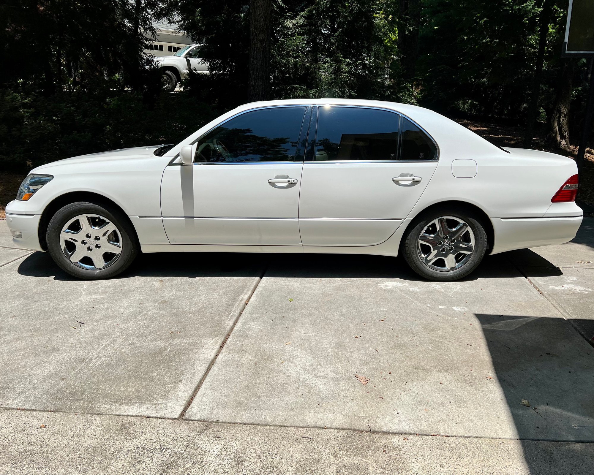

New ceramic tint installed...20% all around and 70% windshield. Also had PPF installed on the headlights to keep them clear after recent restoration. Looking good for an 18 year old boat!

Are you not worried the police will stop you for tint? Did me for factory stock tint.

probably depends on location. I have 5% all around and 40% on the windshield and never get pulled over. But i’m in south florida, 9/10 cars here have dark tints

I'm not too concerned as I live in GA and there are lots of cars with even darker tint around here. I probably would have went one shade lighter (legal) if I had a black interior.

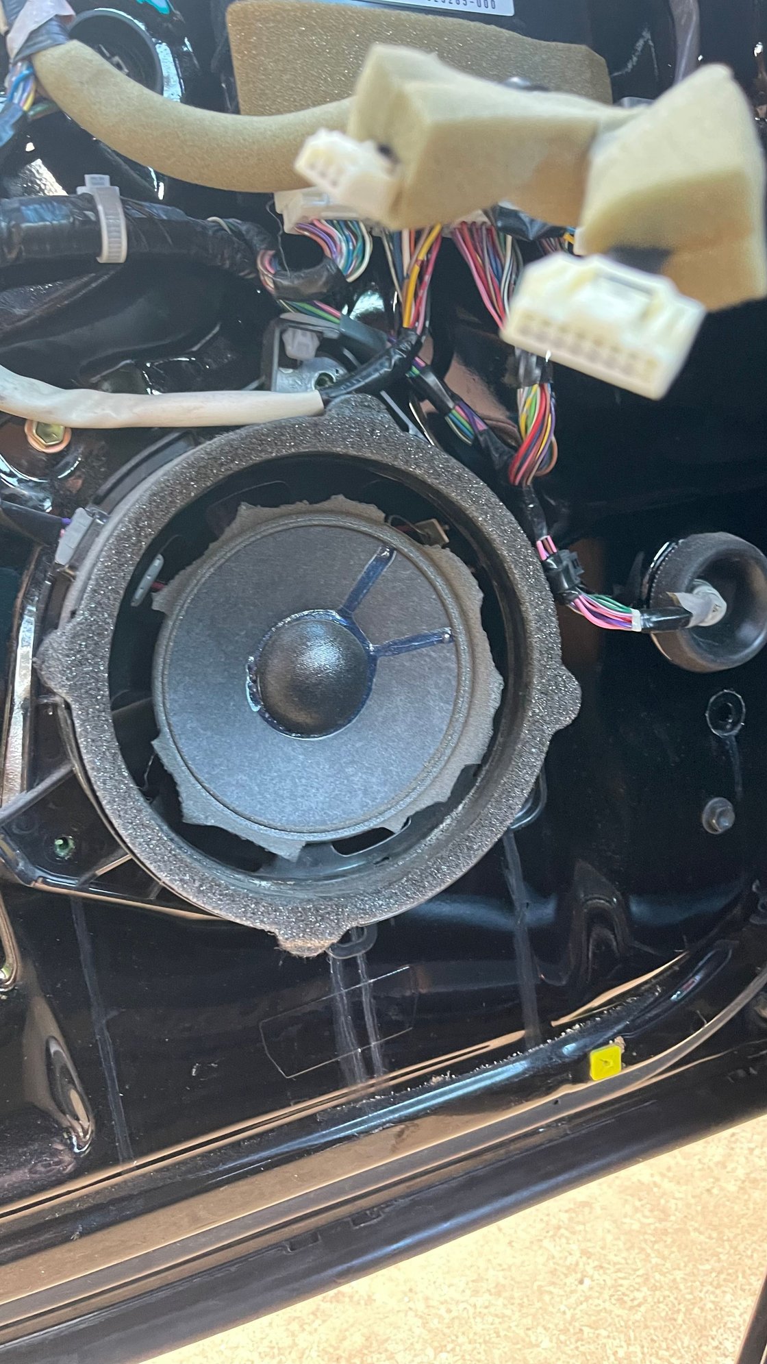

Took my 2004 LS430 to get tint. They called and said, “We don’t want to do a bad job and we think the fact that your driver window stalls out will mess us the job.” It’s true, the driver window does get tired and stops halfway up sometimes. It will move again but it takes a minute or two. So now I have to buy a window motor if I want my windows tinted. I got one ordered and it’ll be here Friday. I took the door panel off and found that my door speaker is beyond busted. See the photo below. So, the cost are all adding up lol

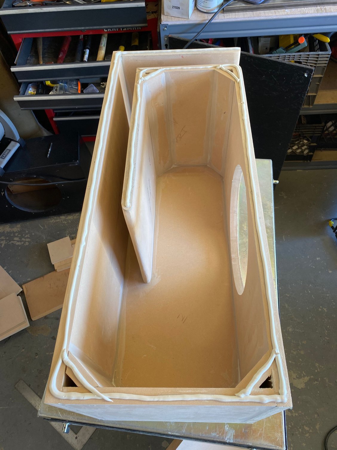

Not so much “to” the LS but “for” it. My previous subwoofer box just wasn’t satisfactory so I’m building a new one. This one should hit a lot better.
