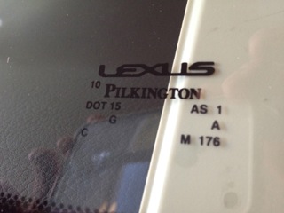

Just replaced mine for new owner
Great service
Used oem chrome moulding
Rain sensor working perfect
