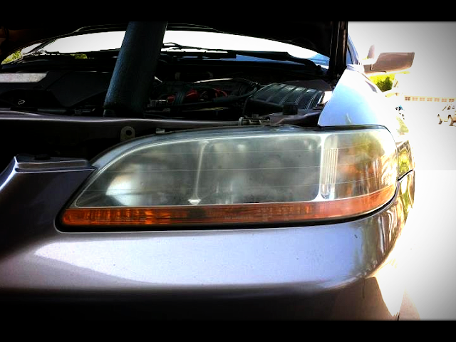

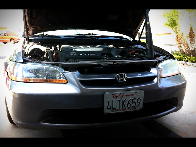

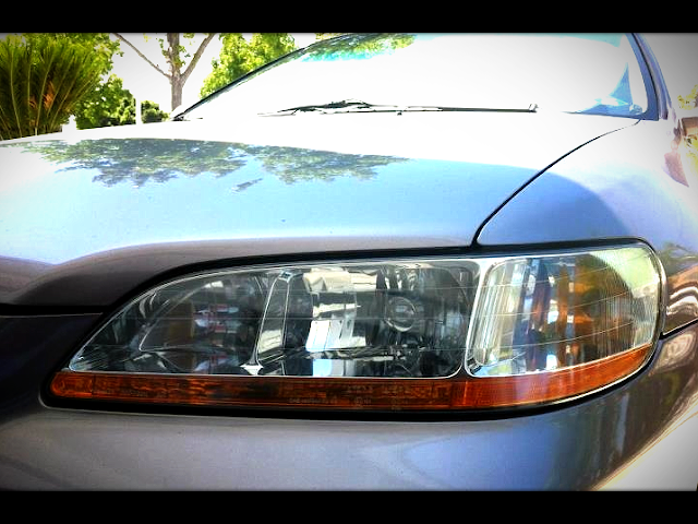

you don't have to wetsand it. you can just use a buffer with a good polishing compound to make it clear again.
After that apply some wax and sealant
before
after
