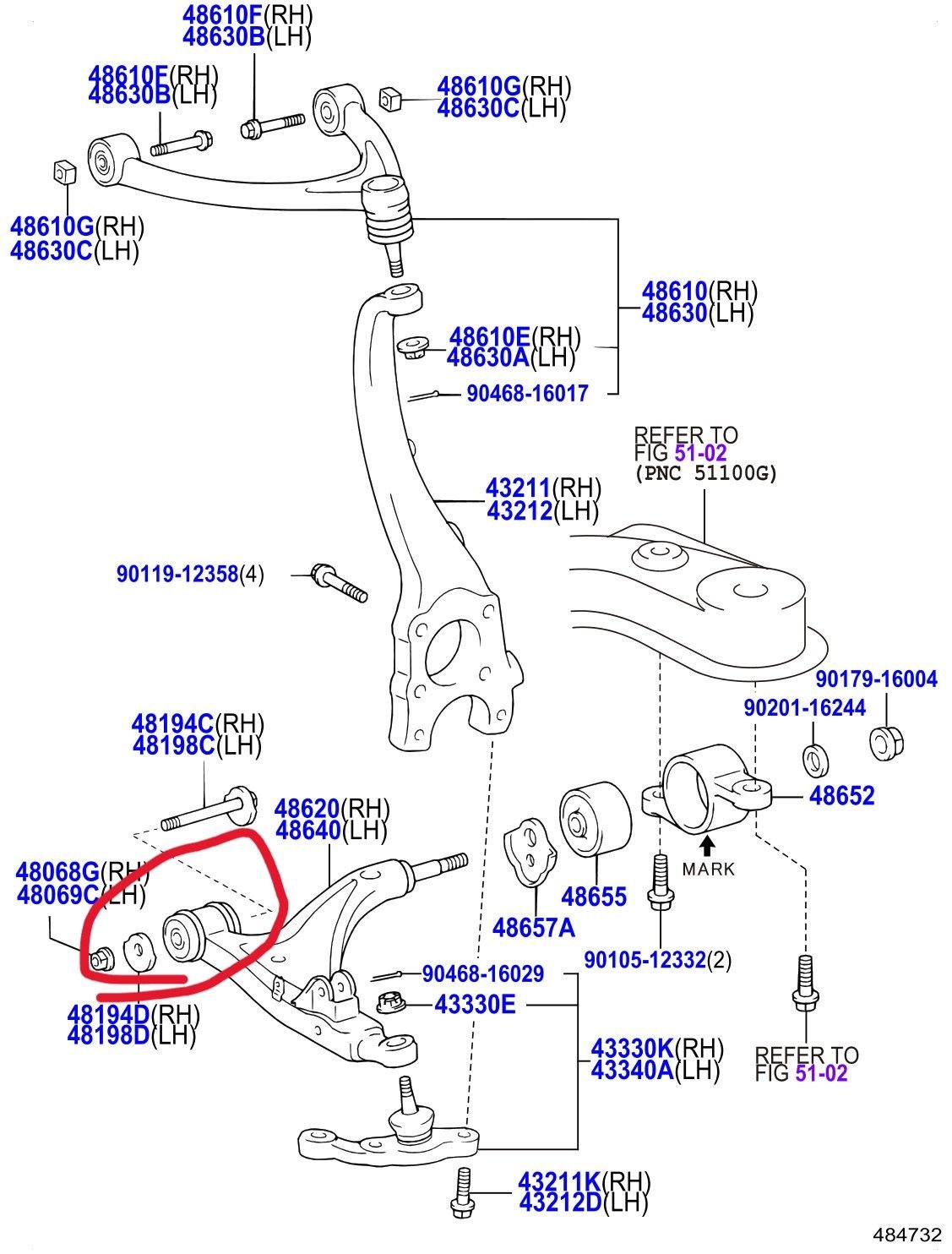

As a follow up.....I just realized that I did not replace the other (small) bushings in the lower control arms. I was not able to locate an OEM part number for this bushing however I did find what I believe to be a decent aftermarket set. In hindsight, it appears that the best course would've probably been to replace the entire control arm which I am unwilling to do at this point especially since I already replaced the larger bushing with an OEM one in the OEM control arm. Hopefully this works. I was also able to go to chatGPT and research the different part numbers for the upper control arm question (sport pkg vs not) and I believe I am ok with the ones I now have installed. My car does have "18 factory wheels (which is a clue for a sport pkg) but after purchasing a Monroney label I discovered the wheel pkg was added as an installed option from Lexus when the car was ordered and that I do not have a sport pkg on my car.
Thanks so much for your quick response which I unfortunately didn't see until after my response below. I will start with the smaller bushing and go from there. I pray I do not have to have it realigned a second time and waste another $125 but I gotta get this right. Hate to come this far and hate driving the car. because of a simple fix. Hopefully it won't come down to the strut mounts having to be replaced with OEM since they are brand new.
