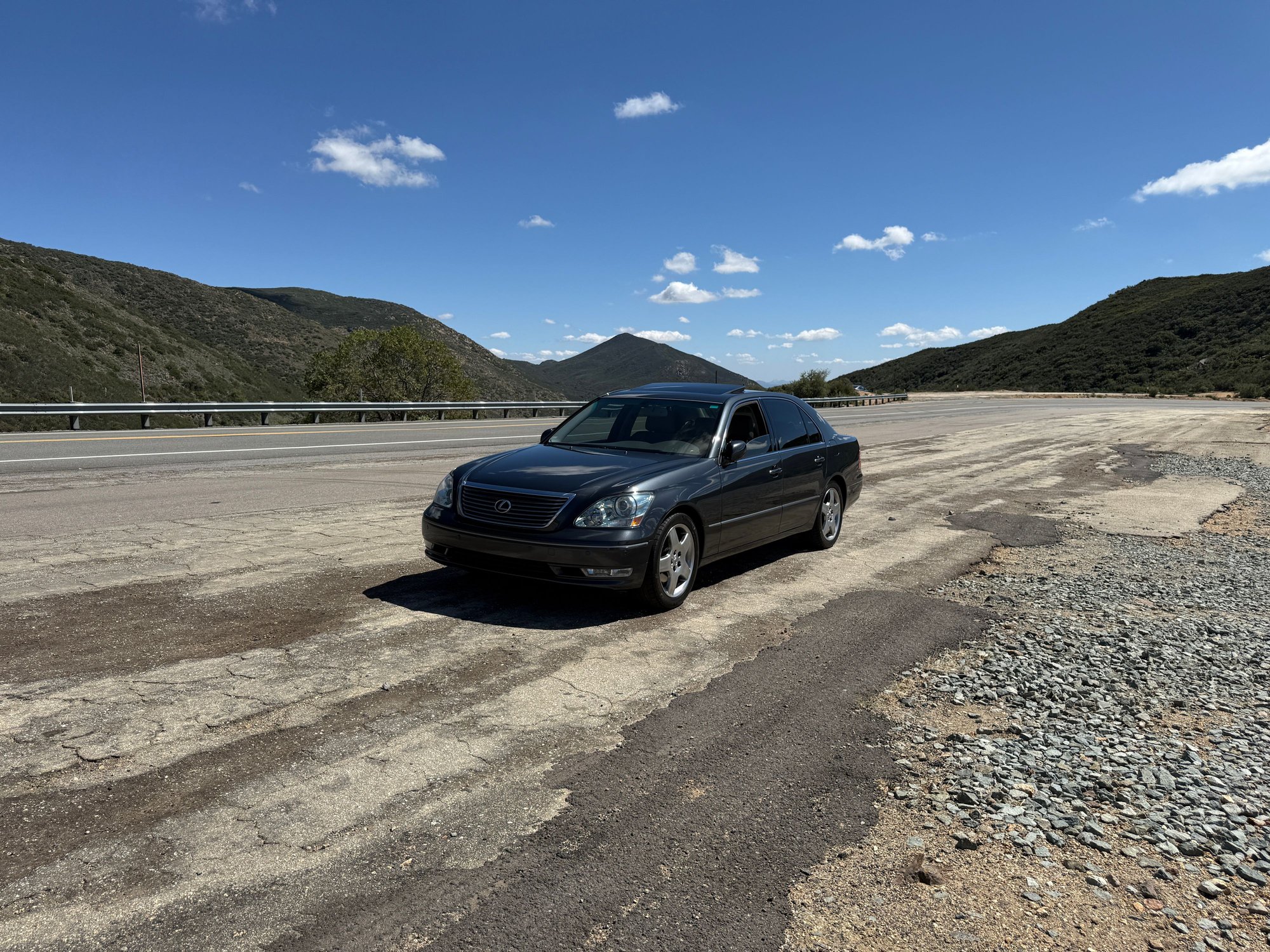

2005 ML 55k miles
Alternator died at 45k miles replaced it myself with OEM Denso unit $350
New rotors and pads all 4 wheels akebono pads with centric rotors $300 rock auto
Drivers shock blown around 51k miles purchased OEM excel G struts from rock auto $250 for the pair installed them myself (PITA) had to redo it
Genuine Lexus Shock mounts bought from eBay Japan $125 for the pair
Timing belt and water pump (Aisin) was done at 38k miles before I purchased the car
All other parts are original
picture just because. Dread the day when a CEL or something pops up but it’s to be expected it’s old
