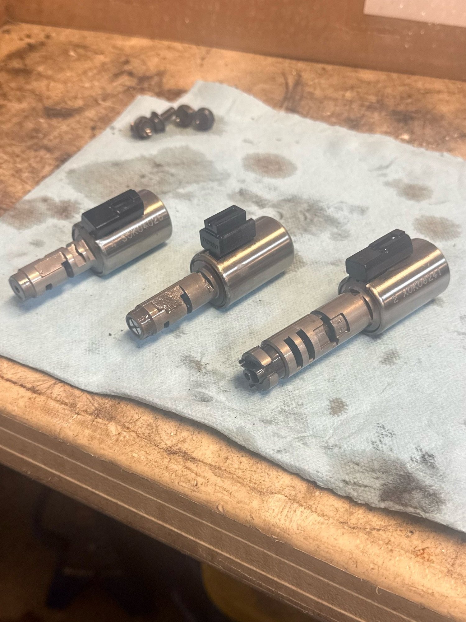

2001 Lexus ls430 with P0753 shift solenoid A Car starts in 2nd gear drives fine otherwise. Fluid was clean and at proper level. From what I can find online shift solenoid A is the farthest back on the left hand side 2 wire solenoid. I pulled all 3 of the 2 wire solenoids to inspect. All 3 have 5 ohms resistance and actuate when voltage is applied. I can tell someone has been in this transmission as the pan was sloppily resealed with orange RTV. Only one solenoid the middle one has denso marking the other 2 have no marking just numbers stamped on the side and the aluminum seems to be a little lighter possibly indicating an aftermarket replacement. The picture attached shows the solenoids in the position they were removed with the left most being the farthest back and the right side being the front of the vehicle. Not sure where to go from here. Any advice is appreciated. Thanks.
