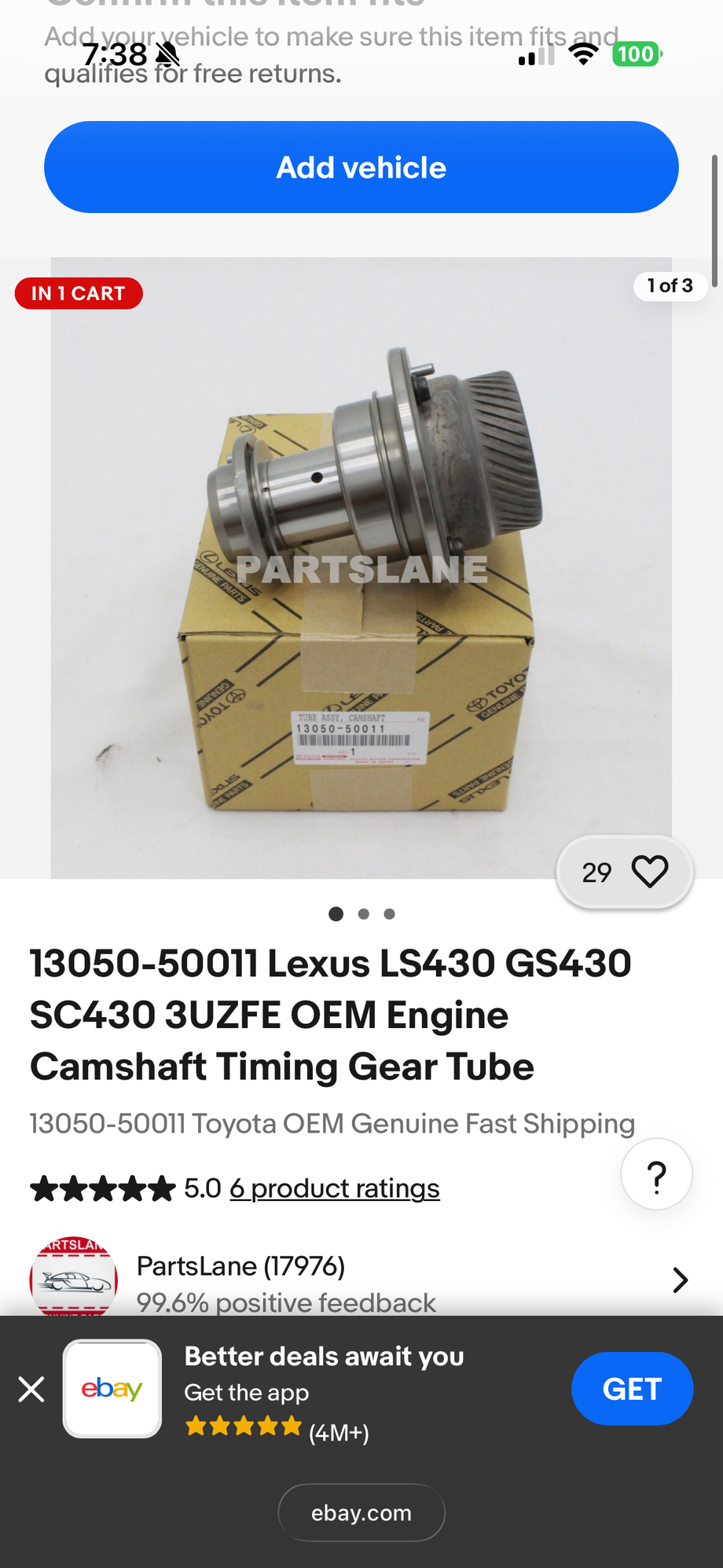

@weldthedif are you referring to this part here

Maybe I've been listening to loud music too long, but I don't hear a squeal at all.
I hear what might be described as a scrape, not quite a grinding noise...
The timing tube doesn't necessarily fail, but there is a small O-ring inside it that will inevitably become hard and brittle over time.
When this happens, the assembly will not rotate effectively to accentuate timing. I don't think either a healthy new O-ring or an old brittle O-ring would make any noise.
