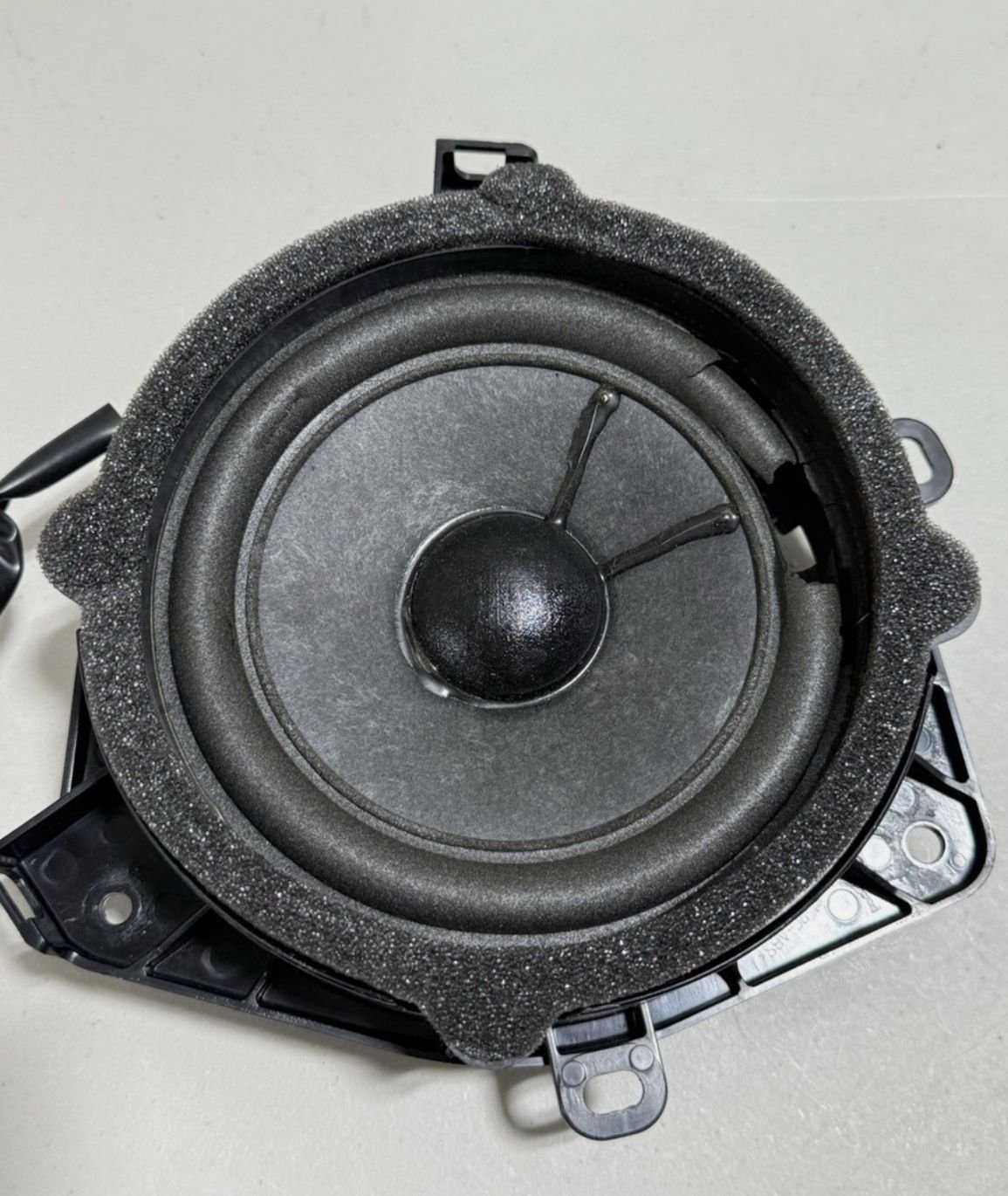

I need help selecting the right upper suspension for my Lexus LS430 speakers - Mark Lewinson Audio.
Due to its age, the factory foam suspension is slowly disintegrating, and I'd like to restore it. Special repair kits are available in the US, but shipping to Poland is a problem. Front Door - ML 86160-0W240
Repair Kit Mount Dimensions:
Outer diameter:
6-1/8" (156mm)
Roll outer diameter:
5-1/2" (140mm)
Cone diameter:
4-3/8" (111mm)
Inner diameter:
4" (102mm)
Foam roll width:
5/8" (16mm)
Rear Door - ML 86160-0W440 LH
Outer diameter:
4-1/4" (108mm)
3-7/8" (98mm)
Cone diameter:
3" - 3-1/8" (76mm - 79mm)
Inner diameter:
2-5/8" (67mm)
Foam roll width:
3/8" (10mm)
