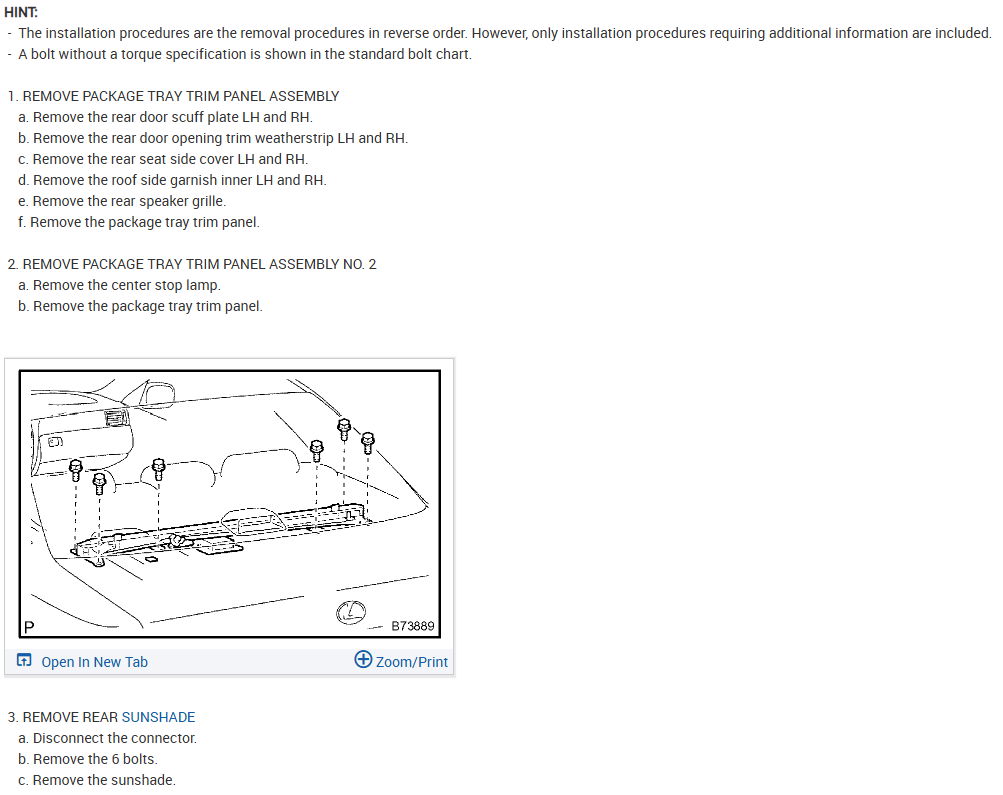

Has anyone here replaced or repaired their rear window sunblind?
On mine the fabric has detached from the frame.
How easy is it to get at and replace/repair?
Will I have to remove the parcel shelf and therefore the rear seats?
I have not.
[/QUOTE]On mine the fabric has detached from the frame.
Will I have to remove the parcel shelf and therefore the rear seats?[/QUOTE]
I have attached the removal procedures. HTH

I have done this numerous times its easy but a pain in the *** honestly. The physical blind is held on by 4 10mm bolts and a one plug. The rear seats deck lid subwoofer cover and 3rd brake light all have to come out to get to it.
