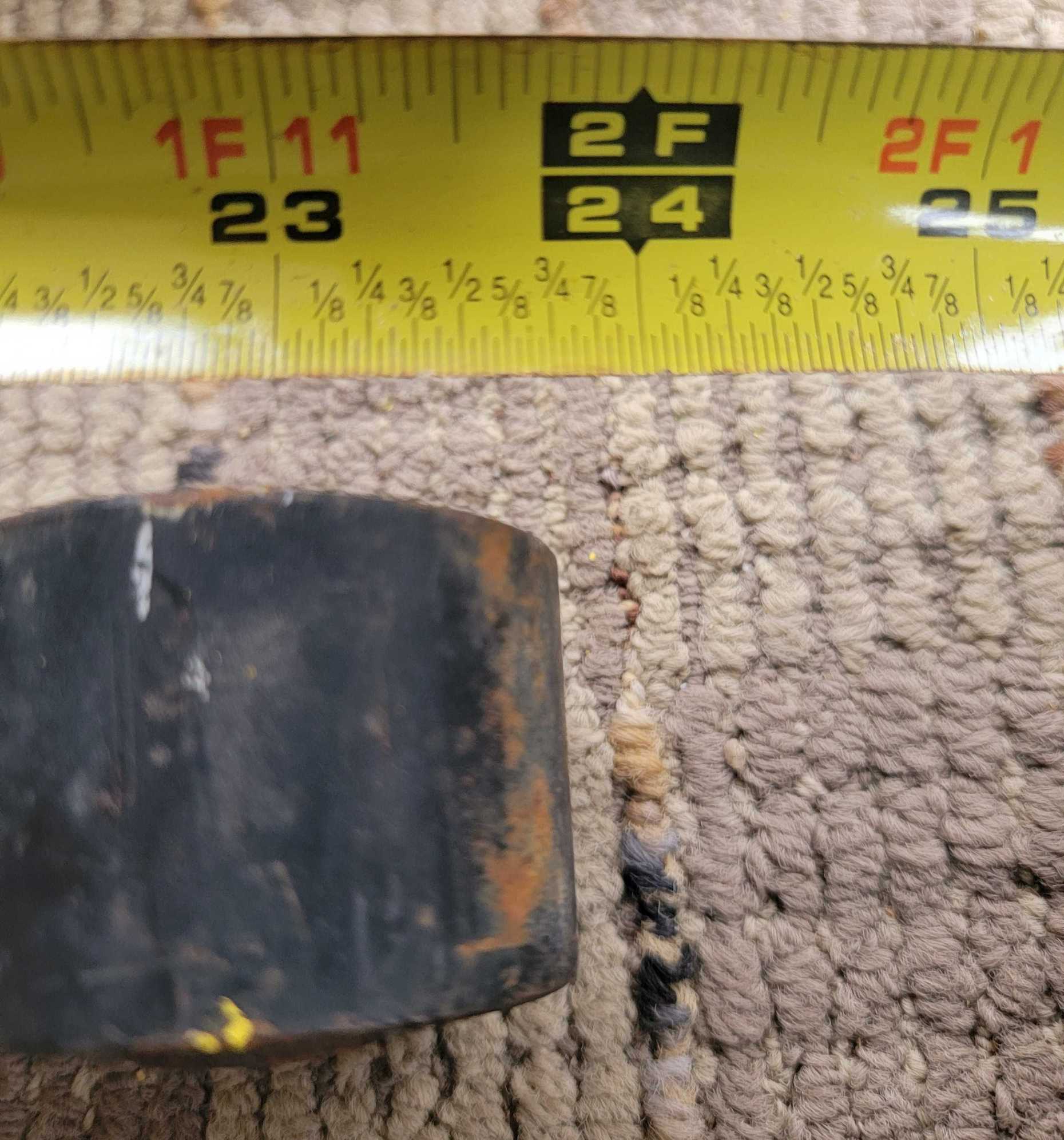

To further illustrate the problem, here are the front struts shorter are the 01-03, longer are the 04-06. I'm not sure what the difference in height looks like comparing the rears.
