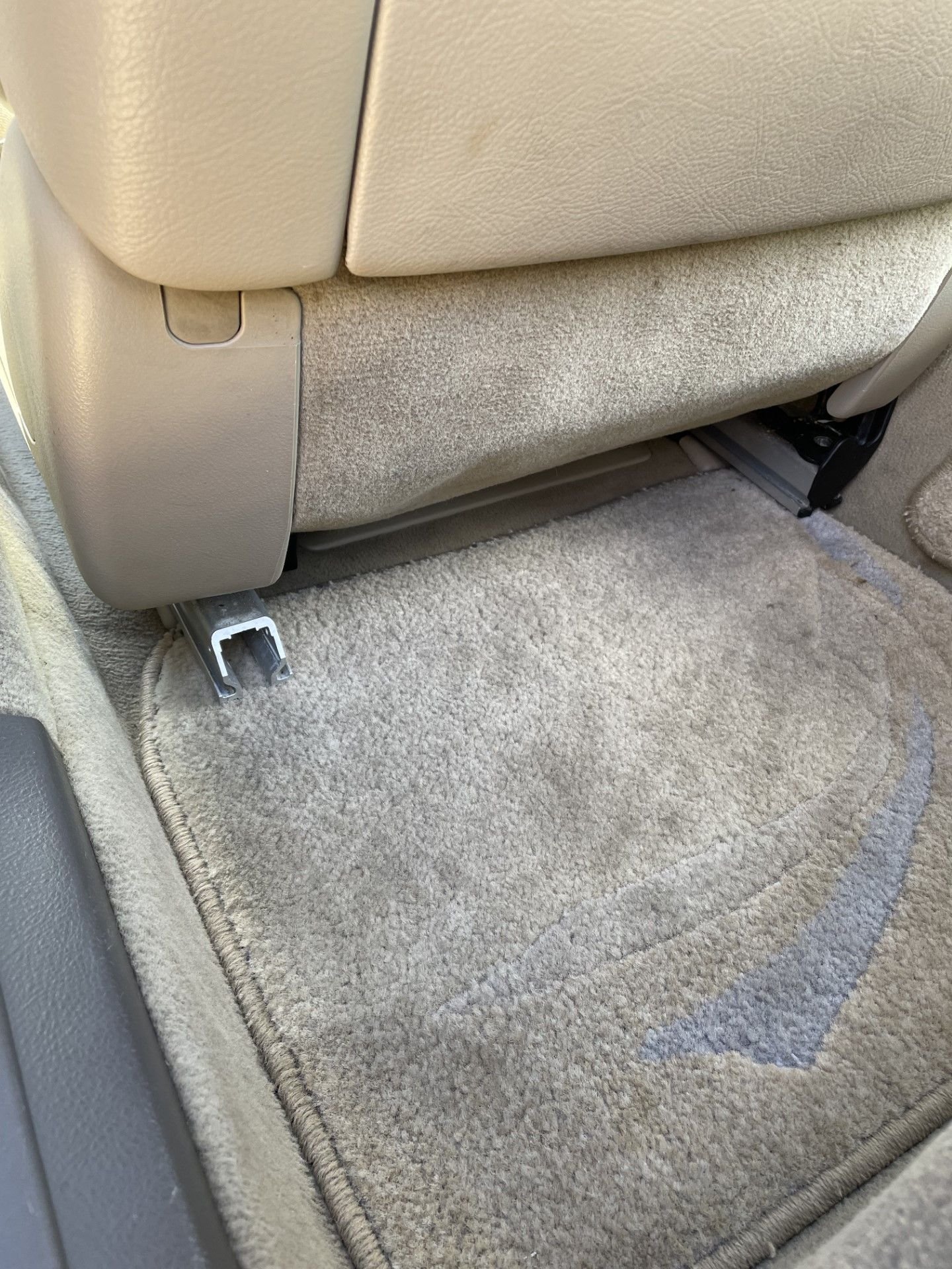

As in the picture below, it looks like I might be missing a plastic cover behind my passenger seat on the end of the seat rail? keeping in mind my car is RHD. if someone can check can confirm theirs is the same?
Thanks

I have the same thing on my 03 and not sure if there supposed to be a cover or not

Yes you are missing a plastic cover. The left and right has the same cover, exchangeable. I lost mine and had a lot of trouble to find one.

Lexus part number 72123-50010
Almost certainly only available from either Lexus dealer or a recyclers.
Same part for all facelift LS430s.

Thanks BigBoomer, I will order one of those. its the little things that count!

I purchase all of my oem lexus parts on Lexuspartsnow.com
Here is the link to the part you need, make sure the color is correct! 72123-50010 Genuine Lexus Cover, Seat Track Bracket (lexuspartsnow.com)

Ordered through amayama and installed!
