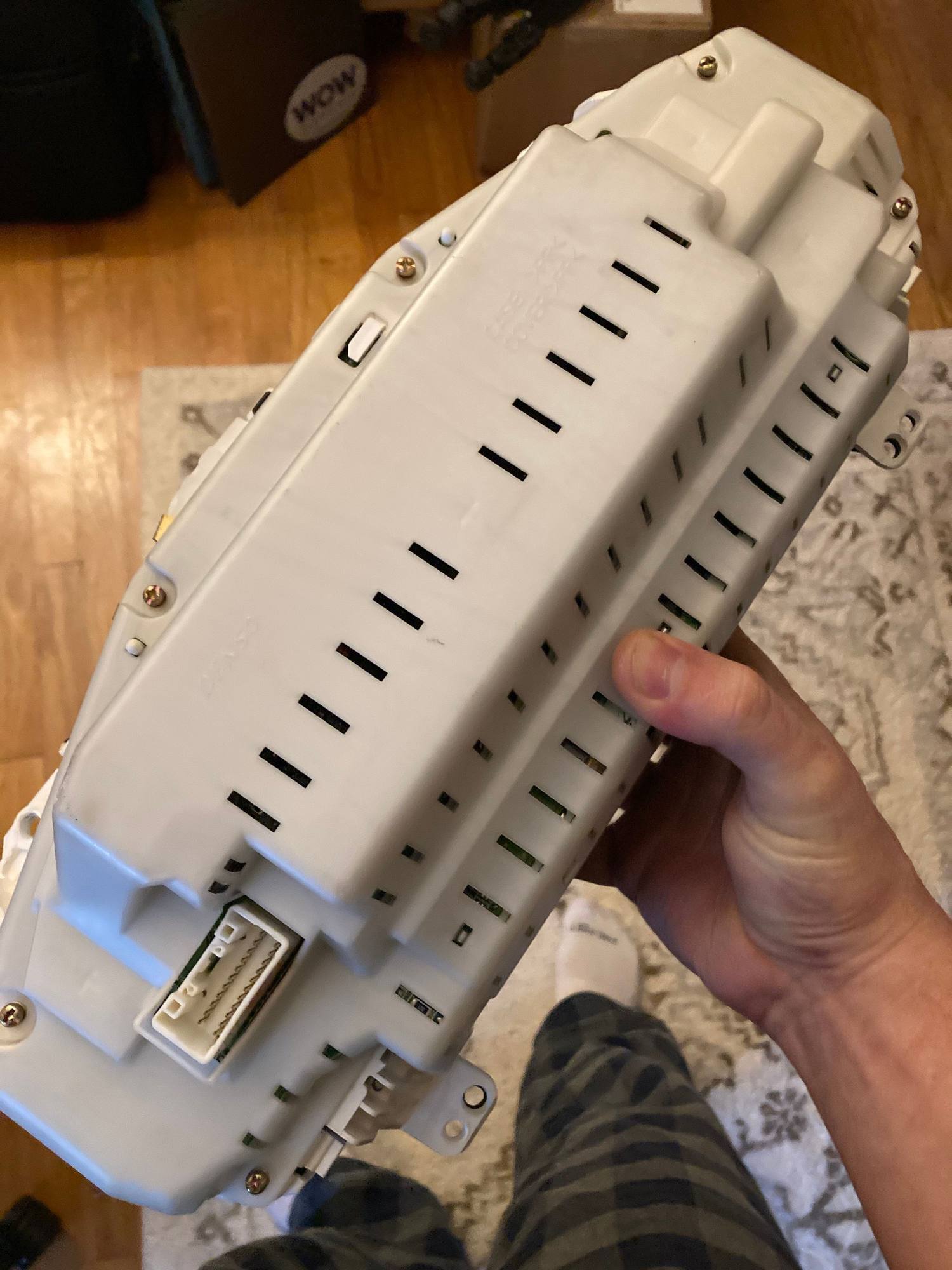

Hey, if you need a new assembly I have an extra one I no longer need. Pulled it from the pick+pull (LQK) so not sure if it works. I sold my 430 so I don't need this anymore.

PS, to pull this out there is a black plastic bezel on the inside of the gauge pod. At the top there are two phillips screws/plastic plugs. Need a short screwdriver. After those are out use use interior remover tools to pull the bezel straight out. It has 2 internal clips at the bottoms but it should pop out. Then the gauge pod assy has 4 screws holding it in. and One electrical connector. You may need to pop our the dash dimmer switch panel to access the left side screws.

I posted a PM to you. I can use it.
