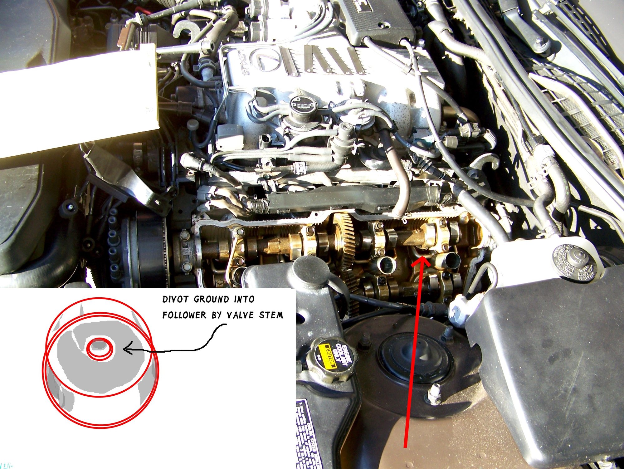

Amskeptic's Avatar
Amskeptic
Joined: Jul 2009
Posts: 445
Likes: 93
That annoying tick on the left is a classic. For some reason, the upper left cam area does not ventilate so well and may run hotter than elsewhere. The upshot is that sludge develops under the followers and the valve stem starts to drill a divot in the follower. What makes it diabolical is that you can do a valve adjustment to get rid of the ticking, and that noise is still there. It can rotate in operation and give you a nice .010" intake clearance, then when it falls into the divot, the next valve clearance check on that valve will be .025".
I had this issue on my 1992 LS, removed the camshafts, followers, and discs, and found #7 intake rear had that problem. After repairing it, engine was fine forevermore with the following warning, Change Your Oil Every 5,000 Miles Without Fail.
