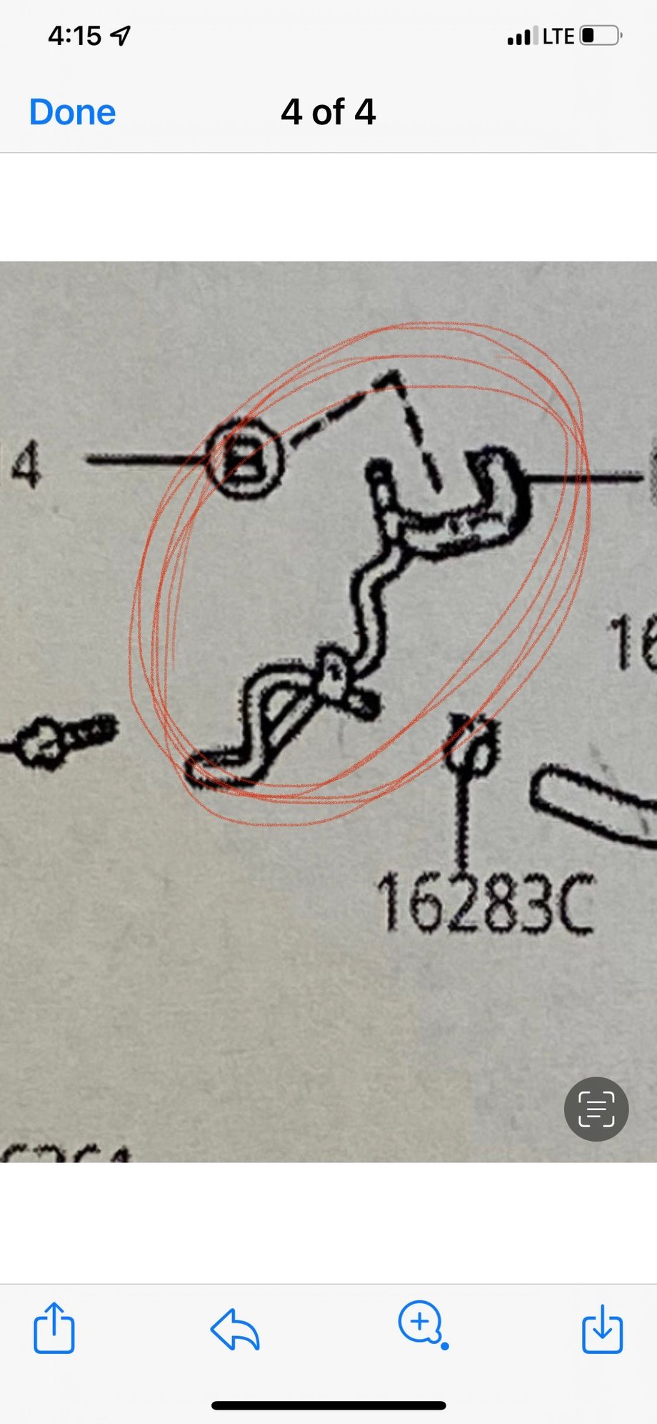

Looking for this part for a 96 LS 400 (coolant line). If anyone can help me out it would be greatly appreciated.
Also, does anyone know where parts for vehicles this old can be purchased.
Thanks
Looking for this part.
Thanks
Looks like that part is discontinued. Maybe someone will know of an overseas vendor that might have it. Or ya might need to find one at the junkyard if ya feel like removing another intake.
Ya should have started a new thread (newbie mistake) to try and find the coolant pipe ya need seeing how this thread the OP is looking for antiroll bars. Maybe one of the mods will move it to a new thread.
But to answer your other question; Looking for older parts, seeing how you're from Connecticut, I usually go to Chuck & Eddie's in Southington. They always have a few LS400s there. (years differ) I also just gave them my 94 recently.
