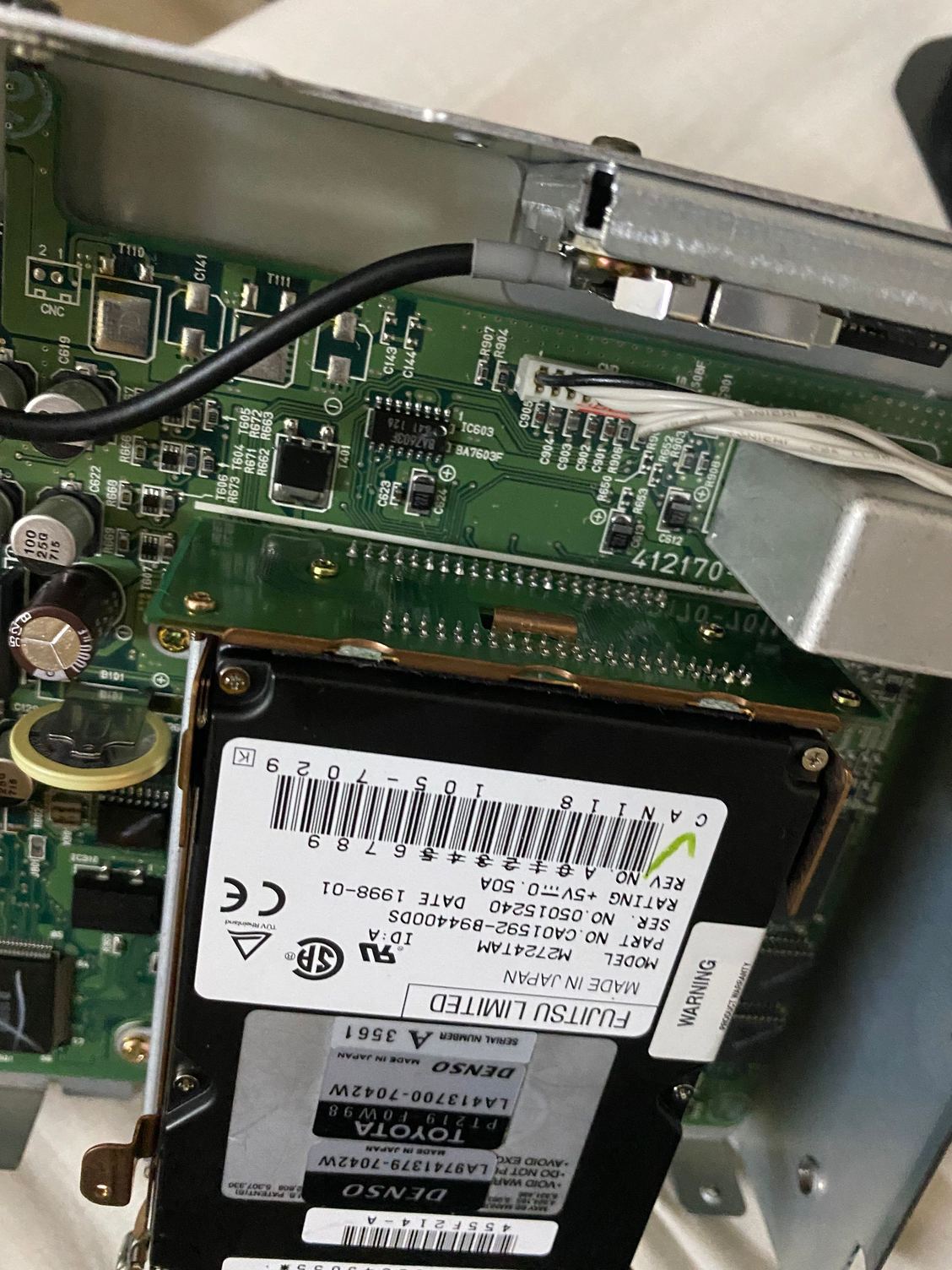

Did you check whether there was a hard drive in that unit? They are frequently sold without them. Your unit is acting like there's no drive in it. I'm not sure why you opted for a $200 unit, but there's several on Ebay available for less than half that price. If there's no drive, I would attempt to return the unit as defective or incomplete.
Well, I just noticed this, and the fact that there's no drive in the pictures you posted. There's supposed to be a small hard drive in that slot. You need that hard drive.
My old one never had the hard disk and It worked fine and still works. Just clock issue after rain. That hard disk is needed only for GPS Purpose.
Product was $60 only, But non of sellers ship to my country in Middle East. I had to use forwarding service and ship to USA then to me. Overall cost me $200+. I cannot return to seller. It cost $276 to ship this from my country to usa. So can’t return product! I checked all couriers locally. I dont know what to do anymore!

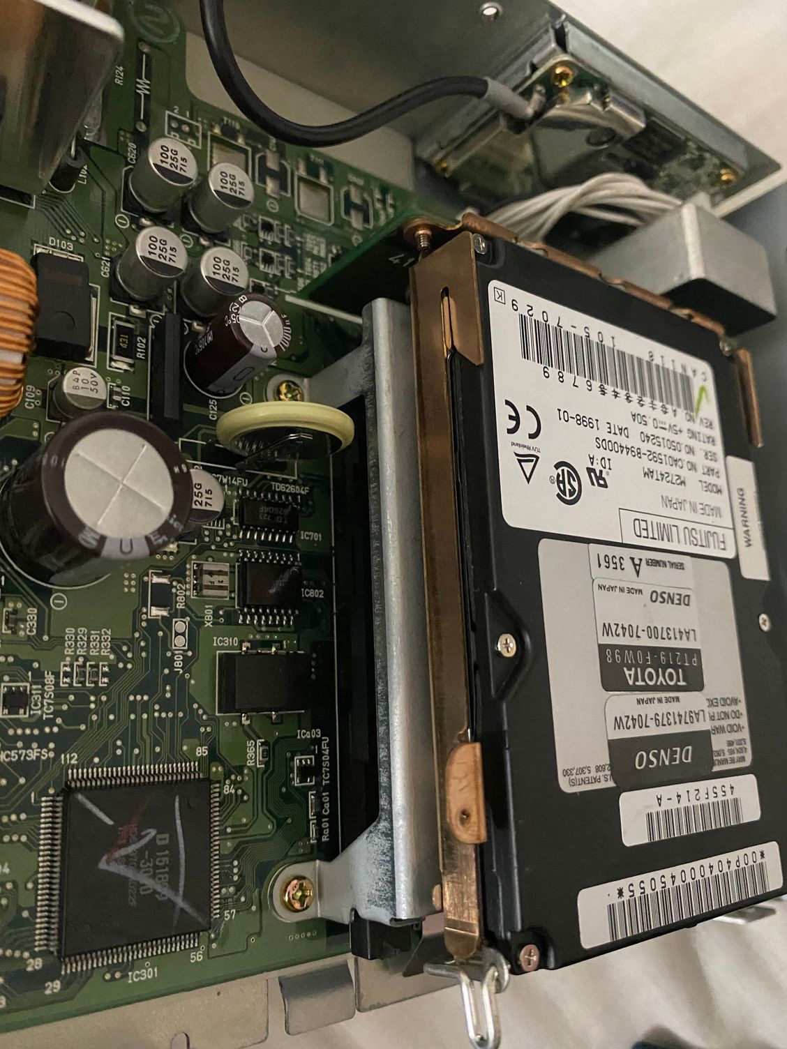

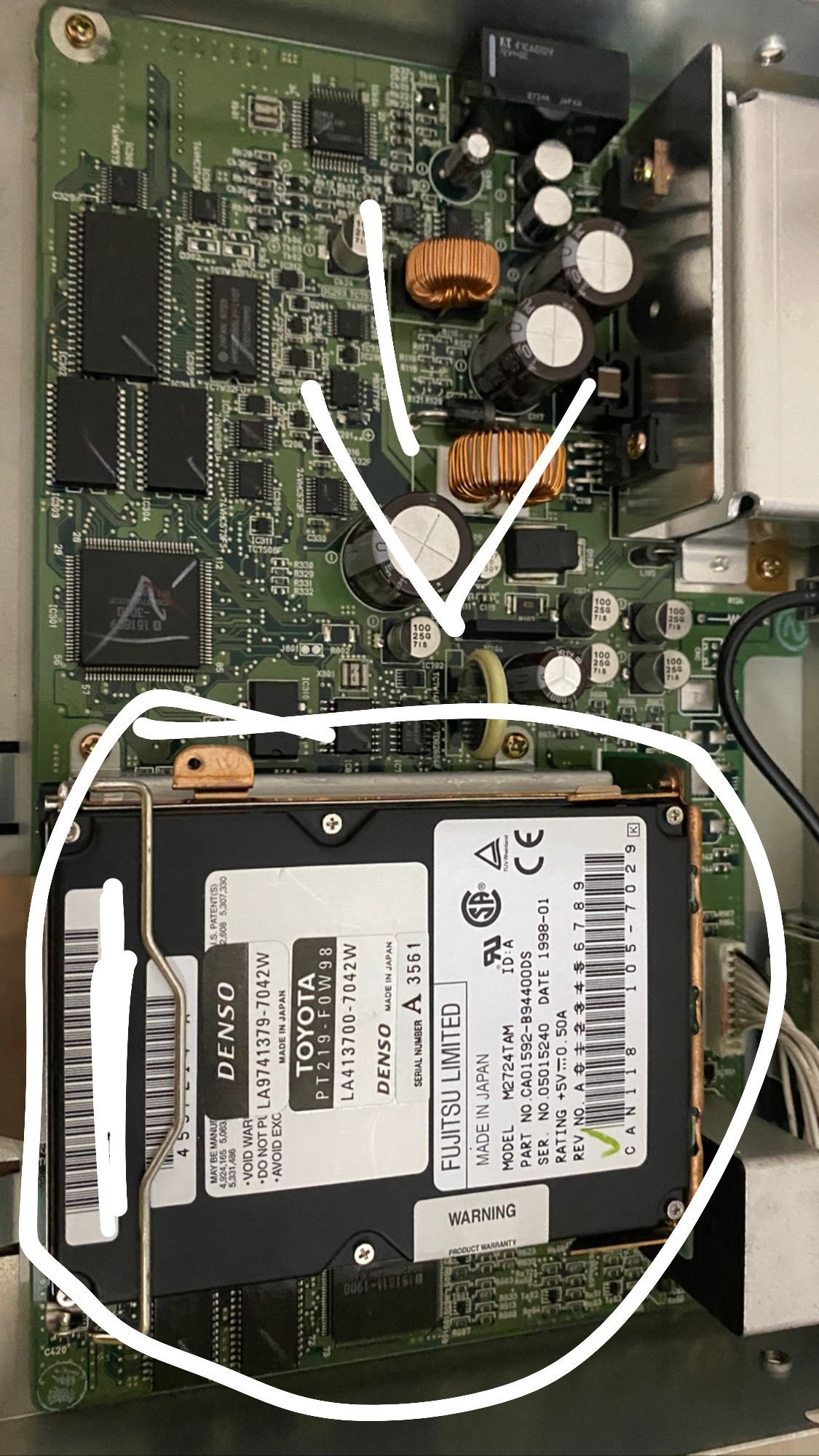

No, There are two hard drives inside the computer drive, one is for Map which you put in the slot or remove if you don't want map. and other comes originally Fujitsu branded inside the box which has climate control, menu and all those data and as you can see in image below. It has the hard disk which carries the functions such as climate control, menu, trip info.etc. and I don't get black screen. I am getting a white screen. I hope Yamae can bring some light into this issue. I even tried removing battery terminal and so on. But still same issue. White screen! Nothing else.
Even my old one on above pictures don't have map drive. Only this Fujitsu drive and It works perfectly fine. Let's me do use all functions and radio everything works yet It has slow boot time and clock issue.
And it's almost brand new. Not even a single piece of dust and probably never removed because screws carried the lock click which only comes from when its never opened. Yet i wonder why it wouldn't boot or even show Lexus Logo.

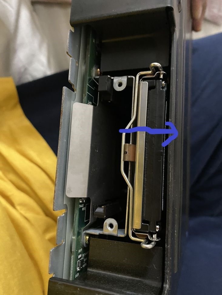

Sorry I am not able to figure out the screws. Here pictures. Can you mark? I tried pulling with the tab. It won't come out!

Drive should slide right out after removing these two screws.

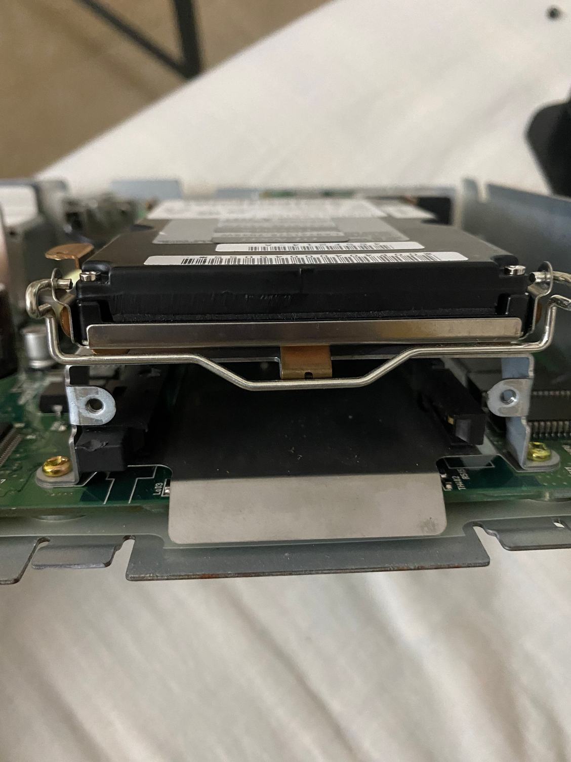

Unfortunately, It wouldn't slide for me as you can see I removed the cover and tried to pull the Fujitsu drive. It won't come out. I am afraid I might break the pull steel tab.

You have to pull that little bar up toward the top of the case which should release the drive than pull back toward you to remove it.

Thank you sooo much, You helped me out solve the slow bootup! Okay I did swap the hard disks. I put mine into the eBay computer and tried. It doesn't work. Same white screen. So this concludes that there is something issue with the circuit of the eBay one? Even though everything looks brand new and mint. It's almost like you brought from dealership. Parts are also brand new.
Moving on I put eBay one's clean hard disk to mine (dirty computer, I kinda felt bad you know) and guess what? OMG mine boots fast now. Like I don't have to wait more than 3 seconds compared to 13 seconds with old hard disk. Super fast that the clock issue is no longer after boot process but later on... still exist as you can see in video it automatically deducted 1 minute. So clock issue still exist. I tried turning on after 10 mins and it reset to 4 AM. So this clock issue is not related to computer drive maybe? So 1/2 issues resolved. Still gotta solve this clock issue. Any idea?
Maybe in future, I will remove the circuit from my one and replace it with the eBay ones shell. So everything will look clean because my computer shell is fully rusted and dirty. I don't want this new disk to go bad or slow as well due to dirt inside my one.
