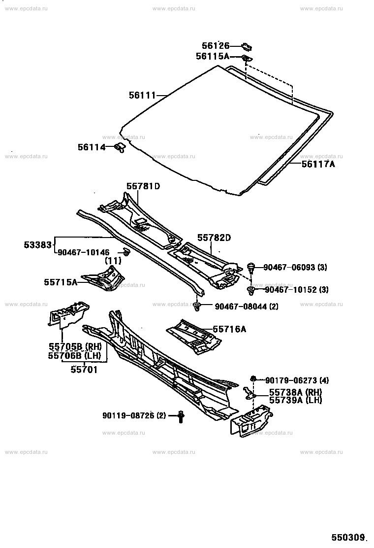

What I believe is the applicable part diagram:

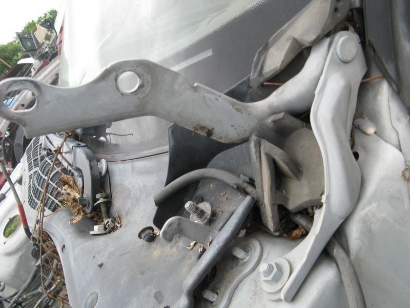

The only image I've found which potentially shows the pieces:

The last photo you have is of a 1st gen LS (1990-1994), and you can see both insulators here. One goes in the top of the fender at the edge, and another below to close out the opening where the hood hinge sits.

Your car is a 1999, so I have attached a parts diagram for the 1998-2000 LS - you can see the two insulators, labeled 53869A, 53868C and 53866, 53867. Unfortunately, some are no longer produced, and you will have to source them from a junked car.
