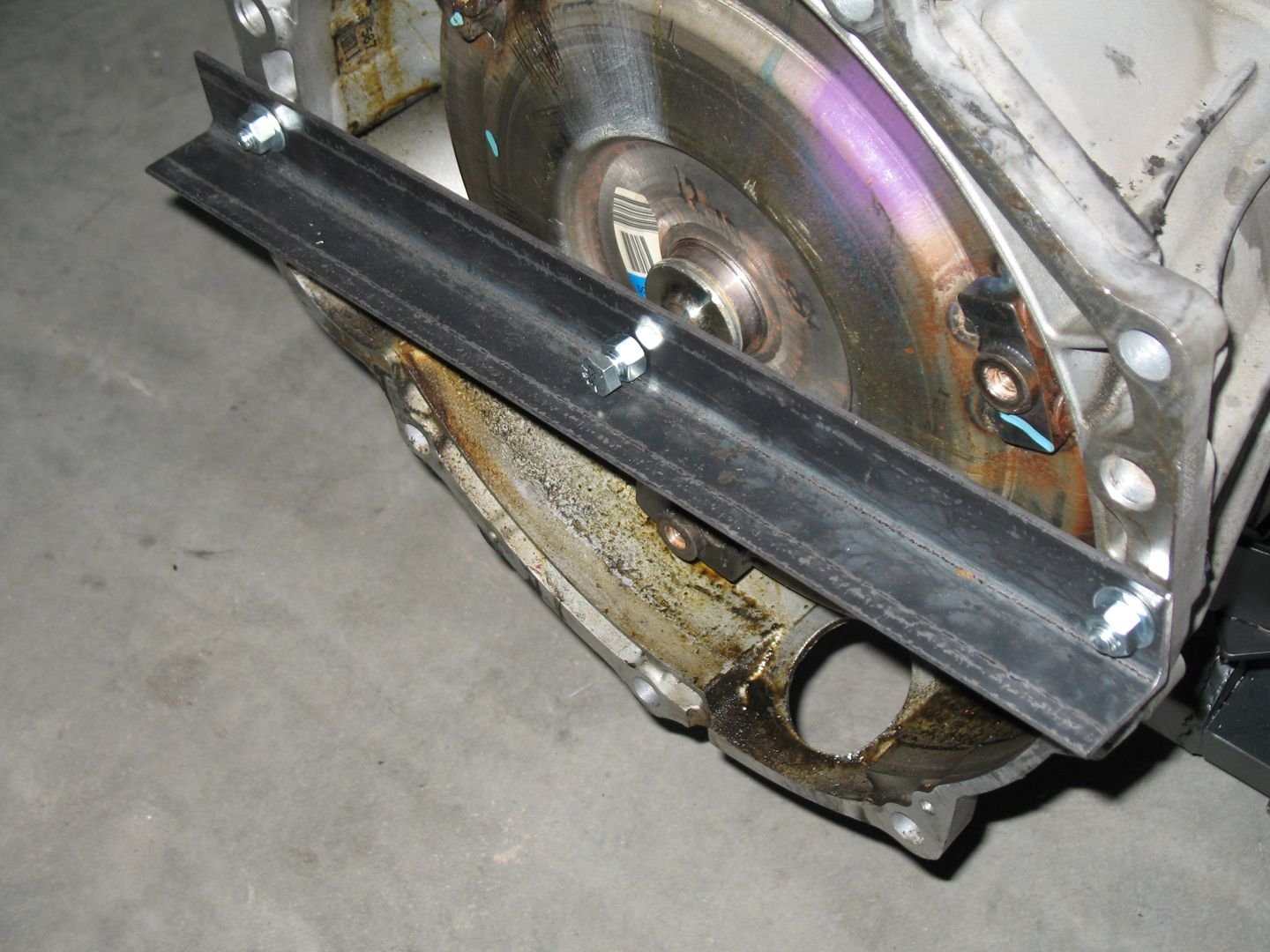

For future reference. I took these images in 2014 when I rebuilt my GM 4L60E after a 3-4 clutch (very common) failure.
When removing/installing the transmission, make a converter retaining strap like the one below. I just had some angle iron handy. Drill thru holes on the ends; drill and tap a hole in the center (measure!). Bolt the strap across the bell housing. The center nut and bolt are then screwed in against the converter nose to hold it in the pump. It doesn't have to be tight; just enough to prevent fore/aft movement. Use this during trans removal and installation.
GM Overdrive - Torque converter retention.
The converter "snout" should have square notches that need to fit into matching ears in the pump rotor (or similar pump drive design). If these aren't correctly mated together, the ears will fracture during trans installation, rendering the pump useless.
GM Overdrive - Pump "ears" (pump halves separated)
