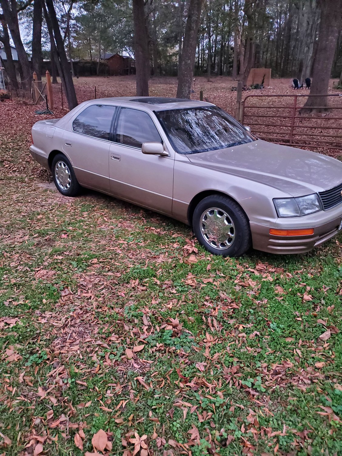

I just bought this 96 LS, and its awesome so far but I've found a couple things I may need help on!
The car has a wobble at around 75-80 mph and its kind of scary so I dont go near that speed. I've heard this could be anything from the strut rod bushings, to the rods themselves. This car has had no work on the rods at all and I hear they should be checked at around 100k.
And there is a groaning noise when I make turns, as well as a weird wobble when slowing down kinda quickly. I estimate power steering pump leaks, though I'm unsure. I was in Texas for the past few weeks and drove it tonight when I got back and the groaning (what I assume power steering issue) has gotten worse since I haven't driven it.
Need help
