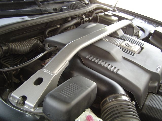

Hey steveski -
How's that Tom's strut bar working out for you? Any noticeable difference? I noticed body flex when I lowered the car, as expected. Did it solve it somewhat.

Originally Posted by kalbo_1
Hey steveski -
Sorry for the long winded reply but I had some major body flex also after lowering it with stock struts. Since installing the STB the car is really much stiffer even with the other suspension mods. I really am enjoying the ride now. With the H&R springs, the Bilsteins and the STB, the car drives way more aggressively
Not sure how much the wheels make a difference but I am running a staggered set of 18's (275's on rear and 245's on the front) with NITTO tires.
I will add an ADDCO rear sway bar next. That will stiffen the rear. My buddy with a Pontiac Firehawk drove my LS last night. He said he was blown away with how well the car handles.
Just in case you get one - you may have to jack the vehicle up a few inches to install the brace like I did.
There's a pic of the STB installed in my gallery.

This is a nice bar!
Just to make it easier.
Just to note, anyone thinking of the Tein CS may not be able to use the EDFC with this bar.

That is a nice bar. Is it custom?

Technically yes - It is from Tom's Racing (box came with Japanese markings). I bought it from Gordon a call at Carson Toyota. It is really heavy duty as you can see. The car handles fantastic.
