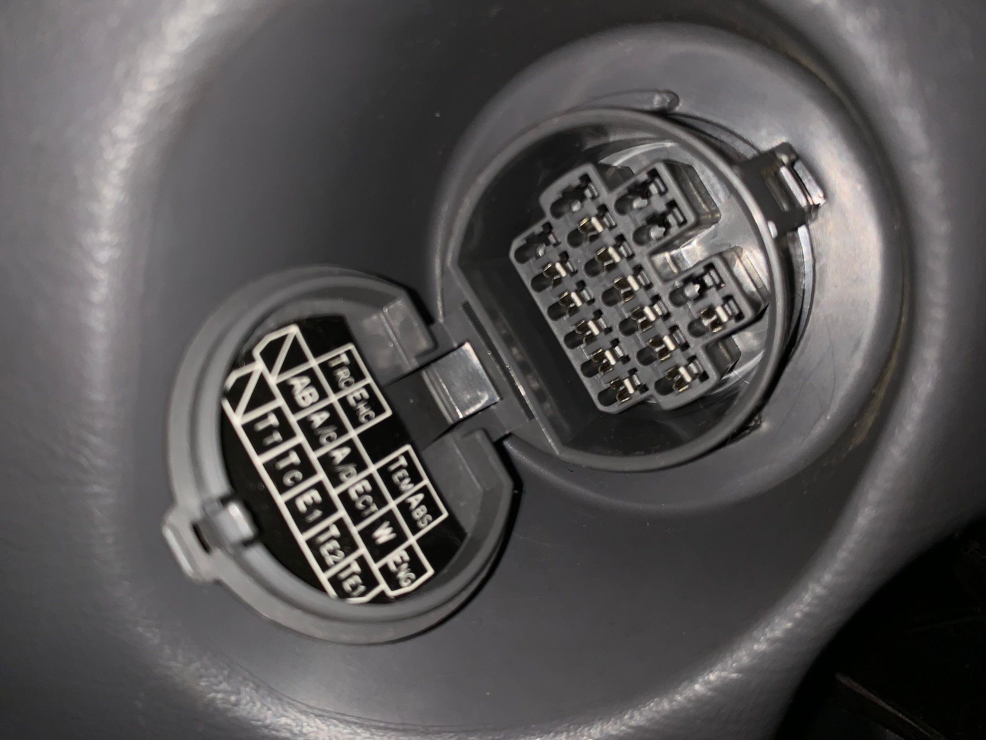

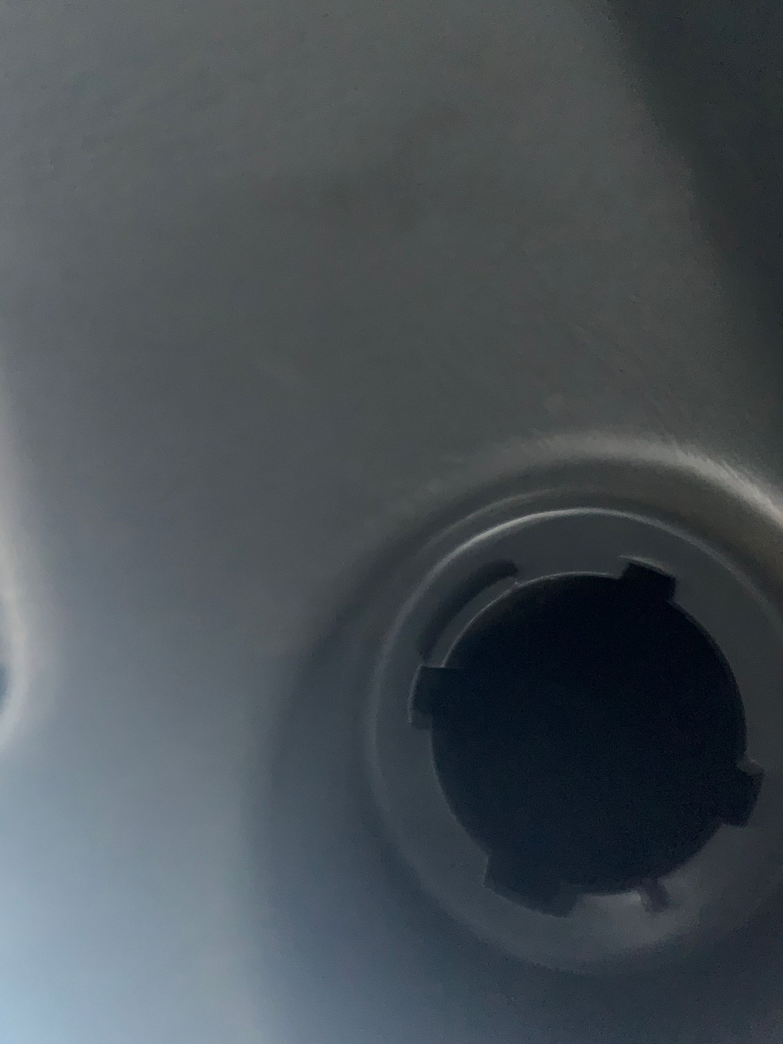

I just bought this 1991 LS400 and while driving a got a CEL. It is because one of the grounds on the spark plug wires came off. I fixed that. Anyways I thought because it is before 1996 that it didn’t have a diagnosis port. I forgot about OBDI and some pictures showed that it does have a simple port under the steering wheel. So I go under there and the port is missing. Like it was never installed. Is this normal?

oops it looks like it was probably pushed into the dash. it should be there.
more:
http://www.lexls.com/tutorials/intro/codereading.html

Thank you so much. It was way back where my fingers could barely reach. I wasn’t sure how to orient it but got it in there
