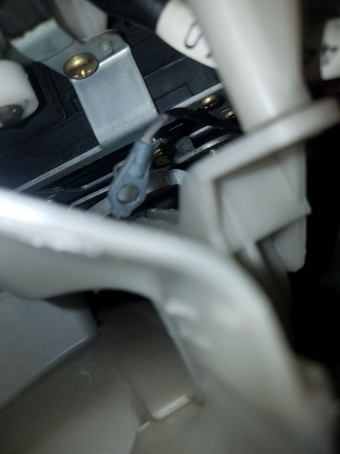

the cable is disconnected to the servo motor underneath the dash. In order to get cold air this summer I disconnected it now that it's winter time I would like to get hot air LOL. I think I read somewhere that you need to use a clip to get this reconnected I'm not sure but I wonder if anybody reading this has had any experience doing this?

Default pictures

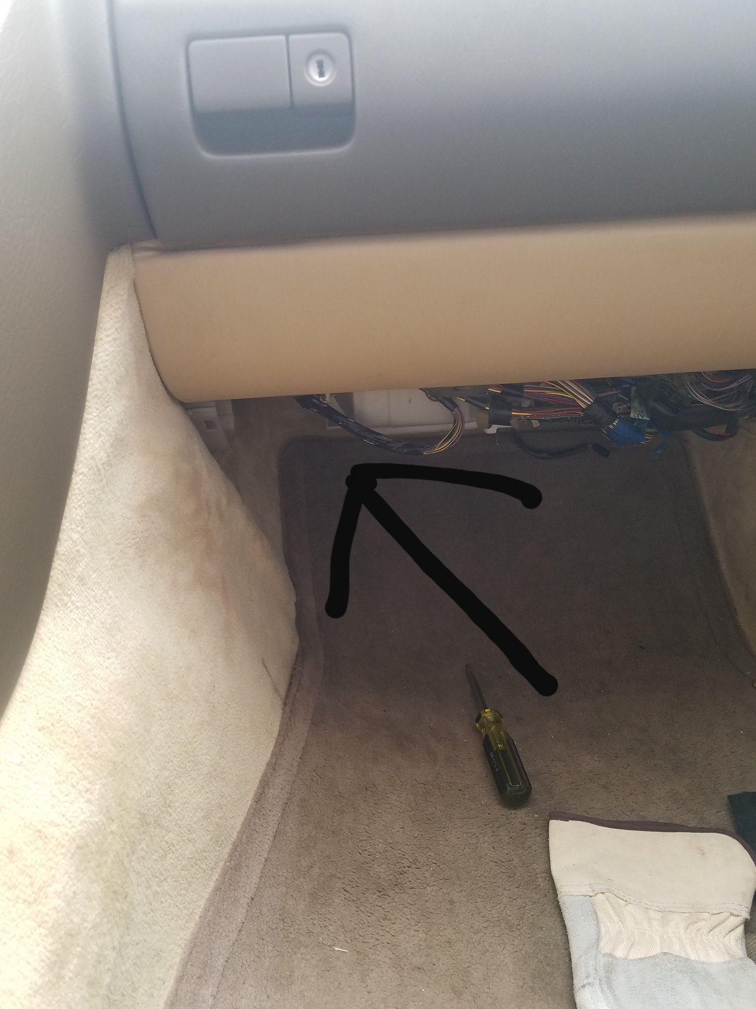

Old Oct 30, 2019 | 04:57 PM
OMAHA's Avatar
OMAHA
Joined: Jan 2014
Posts: 348
From: Nebraska
Default location
it's a weird angle to see but it's located here

Hi
Open your hood and you gonna see the heater valve with the cable connected on it, just move the valve counter clockwise and make sure you put your setting to maximum heat. Good luck.
